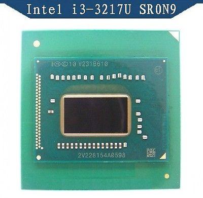

If anyone is thinking of using one of the previously discussed modified BGA CPUs, I would be concerned with clearance issues. In order to make the BGA Ivy Bridge chips work, you'll need an interposer (adapter) to convert from BGA1224 to rPGA988B (socket G2). I would guess that it would effectively double your CPU height as well. For a pic, check here:
https://www.mill-max.com/new_products/detail/6
I also thought that the advantages of BGA were that it was soldered to the board which reduced the height of the setup as well as provided an additional 1224 points of contact for heat dissipation. IIRC, BGA chips flow heat much better to the motherboard than socketed solutions, which can help lower CPU temperatures. The pins in rPGA setups are like a stack needles trying to transfer heat from the CPU to the socket and then to the motherboard, vs soldered pads. I would consider using the BGA+adapter chip in a desktop setup, but I would be surprised if it fit in a laptop.
@phillofoc
On the 2570p I'd say you have about 3mm clearance between back cover and heatsink.
Any idea of the height of that adapter?
I imagine that the clearance would be close enough where I would worry about the screws not biting and being able to get the heatsink mounted to the board. It all depends on the height of the interposer, but I would imagine that it would be at least the height of a mobile IVB CPU without the pins (so the actual silicon plus the green part). Here's an ebay image that I stole, with an appropriate link:
Intel Core i3 3217U SR0N9 BGA to PGA Laptop CPU 1 8GHz 3MB Socket G2 988pin | eBay
The dark green part appears to be the BGA cpu, and the light green part the PGA interposer. I wouldn't try it in my 2570p, but would consider it if I had a SFF PC that used mobile chips. There's a few mobos out there that do. Now, if there was a 3840QM for super cheap, or if I really wanted a feature in a BGA CPU that wasn't available on the PGA (eg the 3632QM) then maybe.
