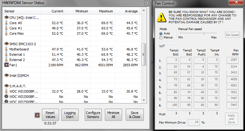

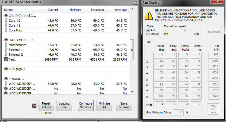

Heh, few minutes ago I realized that fan is not spining. I took a look on HPFC and there was no reaction on manual settings. I tried to restart but after restart I got info abou system fan error 90B, very common error. I thought that is a reason of my mods, I changed a fan and after this I got the same message so reason is on settings/main board. Despite that, I tried to chalange it during BF4 without working fan :P
But there was no chance, during waiting for map I got 95C on cores so start a game would give fast restart ;)
Im going to try hard reset and upload BIOS, if doesn't help I will be forced to call fo onsitebulance ;)

Thanks! Looks like there's no reason to get the 2170p over the 2750p then... Anyway, does anyone know if it's possible to change the function of the wireless button and internet button on the computer to be volume up and down buttons? there's a mute button right next to it. i have no use for wireless on/off and an internet button...
Is anyone able to explain me where are the differences in BIOS, hardware which allows me to do this kind of things in 2530p but not in the 2560p/2570p?
2570P and 2530P are manufactured by completely different companies with different architecture, including the thermal sensor:
2530P = Compal LA-4021 using EMC2103-2 Thermal Sensor. You can use hwinfo to control the fan on these.
2570P = Inventec Simba using GMT G781 Thermal Sensor. You can use TPFancontrol to control the fan on these.
Thanks. :)
But as mentioned many times before, on 2530p we can choose every single value between 0 and max rpms.
In 2560p/2570p only 0 or another one is 3200rpm. Shame... ;)
The two diode solution was proposed earlier on to reduce the fan cut-in rpms. Do you no longer have the diodes in place?
http://forum.techinferno.com/hp-business-class-notebooks/2537-12-5-hp-elitebook-2570p-owners-lounge-10.html#post64705
http://forum.techinferno.com/hp-business-class-notebooks/2544-hp-probook-4330s-working-silent-fan-mod.html
Yes, I have them all the time but I really regret 2530p (2540p also?) fan controll ability=simplicity ;)
I understand completely. Yes, hwinfo has a nicer interface for fan control. Maybe @Mumak, the author of hwinfo, could work with the author of TPFancontrol to add newer SB/IVB fan control to his software?
are You able to do test with 30x and 25x?
I'm not sure what you want tested at x25 and x30 mode? As mentioned, the shim improves heat dissipation from the CPU so I get a longer run at my full x35 4-core mode in say TS-1024M. That heat doesn't get removed fast enough and is backlogged unless some of the cooling mods are implemented. Basic one is to just run the fan at 100% and remove the bottom cover.
