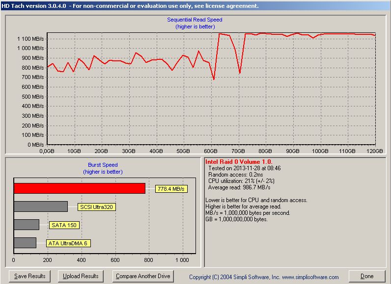

i5-3340m@2,7GHz (HD4000 IGP), 2x4GB Micron KIT DDR3 1600Mhz, 2xKingston 60GB SSD sata3 @ RAID0 (one in a HDD caddy at the upgradebay), Win7 prof x64 sp1.
Boot speed is 6 to 8 seconds after the BIOS HP logo,
only Intel RST app (2 process, IaStorIcon and IaDataMgrSvc) set to delayed start.

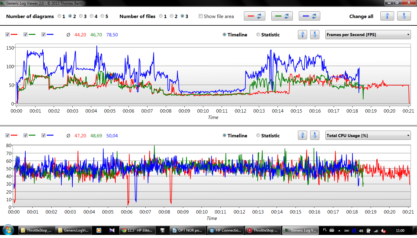

I tried to set turbo mode by throttlestop but nothing changed.

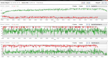

Here You comparision for 3 mission (FHD)
red: without throttle, high settings
green: with throttlestop, high settings
blue: with throttlestop, low settings
As You can see, even with low setting there are specific places where games is barely playable, it is caused by BusLoad choking. The reason is opt1.2 only, not higher.

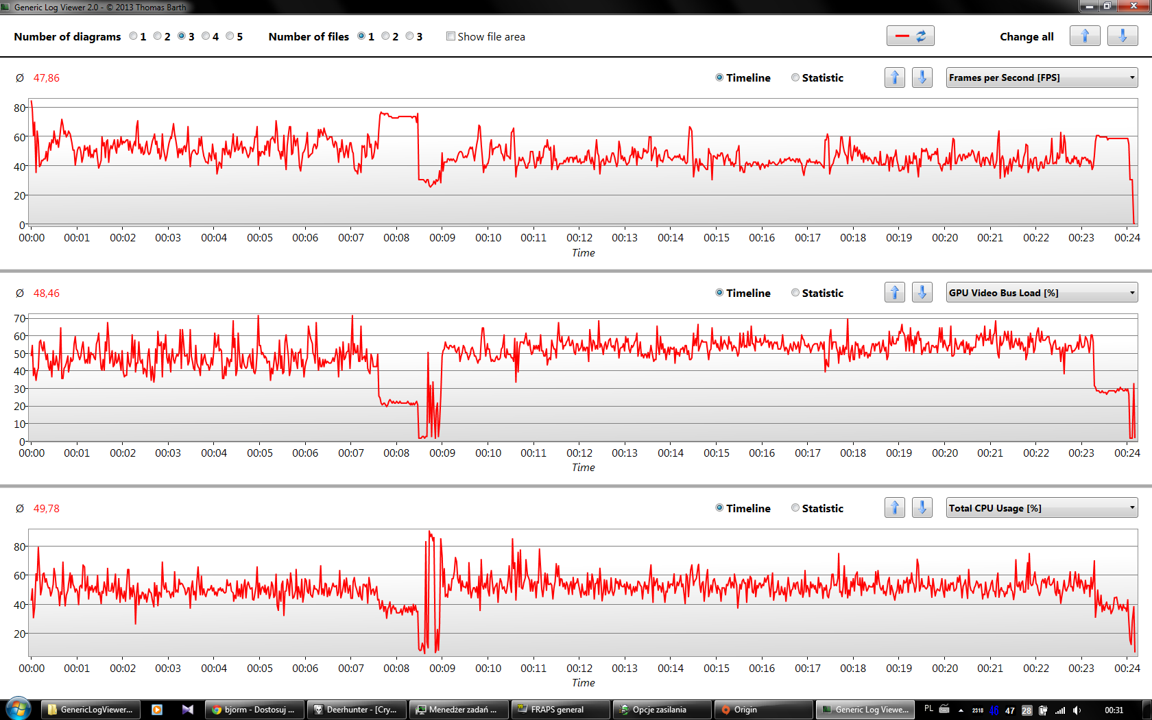

Here is FPS with Mutli on High setting with res. 1680x1050.

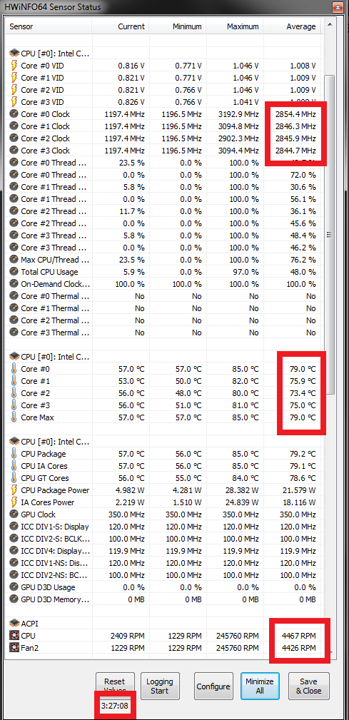

Hwinfo after 3,5h of BF4 playtime. As we can see, there is 95% working on turbo mode but CPU was using only on 40-60% :)

So in case anyone is wondering... Here are 2 different benchmarks causing the CPU to draw significantly more power than the other..
LinX: imgur: the simple image sharer
TSbench: imgur: the simple image sharer
Notice the multipliers.. they are EXACTLY the same. I didn't leave them running for very long because no matter how much time into the benchmark TS bench never uses more than 34-36watts. This is despite my TDP being unlocked...

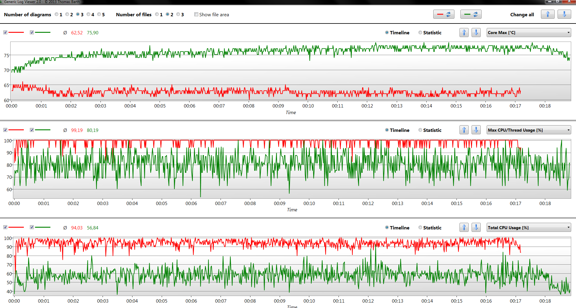

there You have compariosn in BF4 with i5-3230M vs i7-3632QM. but really interesting thing Ypu have here, for the first time I tried Gelid GC Extreme.
As for 17minutes of almost 100% core load, temperatures are silly low even for i5 :)
