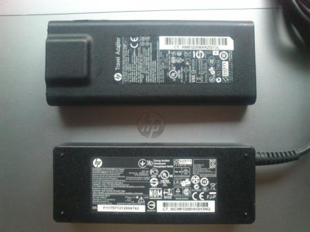

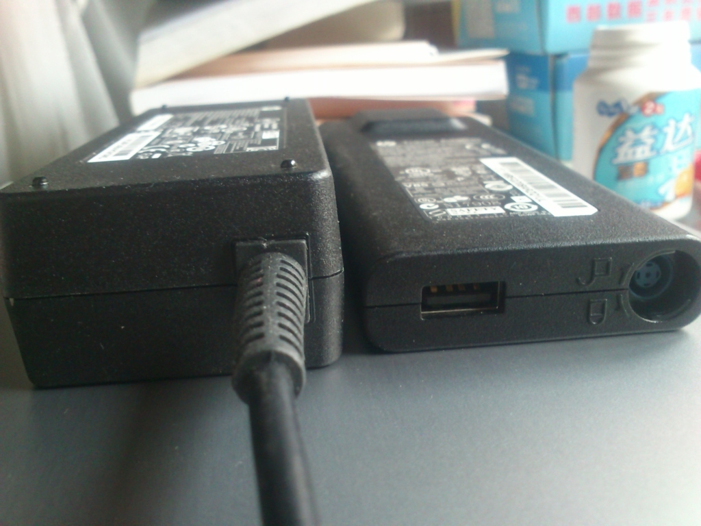

<b>Lightening the AC adapter</b>
The stock 65W AC adapter is a pretty heavy unit. Total carry weight can be decreased by upgrading your battery to the next size up (+3 cells, 0.15kg/0.33lb), forgo carrying the AC adapter and recharge once back at your home/hotel/office. If doing that consider the battery life tweaks available here to extend your range. Other options:
<ol><li>Use a lighter AC adapter accesssory specifically for our Elitebook. Note: 45W included in list for weight comparison sake. It's incapable of powering and charging a 2570P.
HP 65W Slim Adapter AX727AA (0.23kg/0.49lb)
HP 90W Slim Adapter BT796AA (0.23kg/0.49lb), pictured here against 90W Smart adapter (pandaleo).
HP 45W Smart AC Adapter H6Y88AA (0.20kg/0.44lb)
HP 65W Smart AC Adapter ED944AA (0.28kg/0.62lb)
HP 90W Smart AC Adapter ED945AA (0.37kg)/0.82lb)

Easiest weight loss could be accomplished by removing the ODD, using a smaller battery and replacing a HDD with lighter SSD. Could even up-spec the battery to one 3-cells larger and omit carrying the AC adapter to bring weight down if the battery can provide the runtime you need before a recharge.
  • HDD = 0.11kg / 0.24lbs (from M&S guide)
  • optical drive = 0.12kg/0.26lbs
  • 3-cell battery = 0.15kg/0.33lbs
  • 6-cell battery = 0.30kg/0.66lbs
  • 9-cell battery = 0.45kg/0.99lbs
Thanks for this thorough write-up... a very useful addition to this thread's already comprehensive coverage of the 2570p (is there a dedicated Elitebook wiki somewhere? if so, the info at the top of this thread could create an awesome 2570p Wiki page).
So it looks like I'll be deep sixing the optical drive - .26 lbs is a decent weight savings. I never use it anyway. Also I already have an SSD, so the OD seems like the only "heavy" item I can ditch. If I remove the optical drive assembly, what do people use to "cover" the hole on the side of the laptop? Can the front part of the OD be removed and reattached somehow? Or is there another way...?
Cool tip on that slim AC adapter - had no idea those existed. If only they were cheaper!
