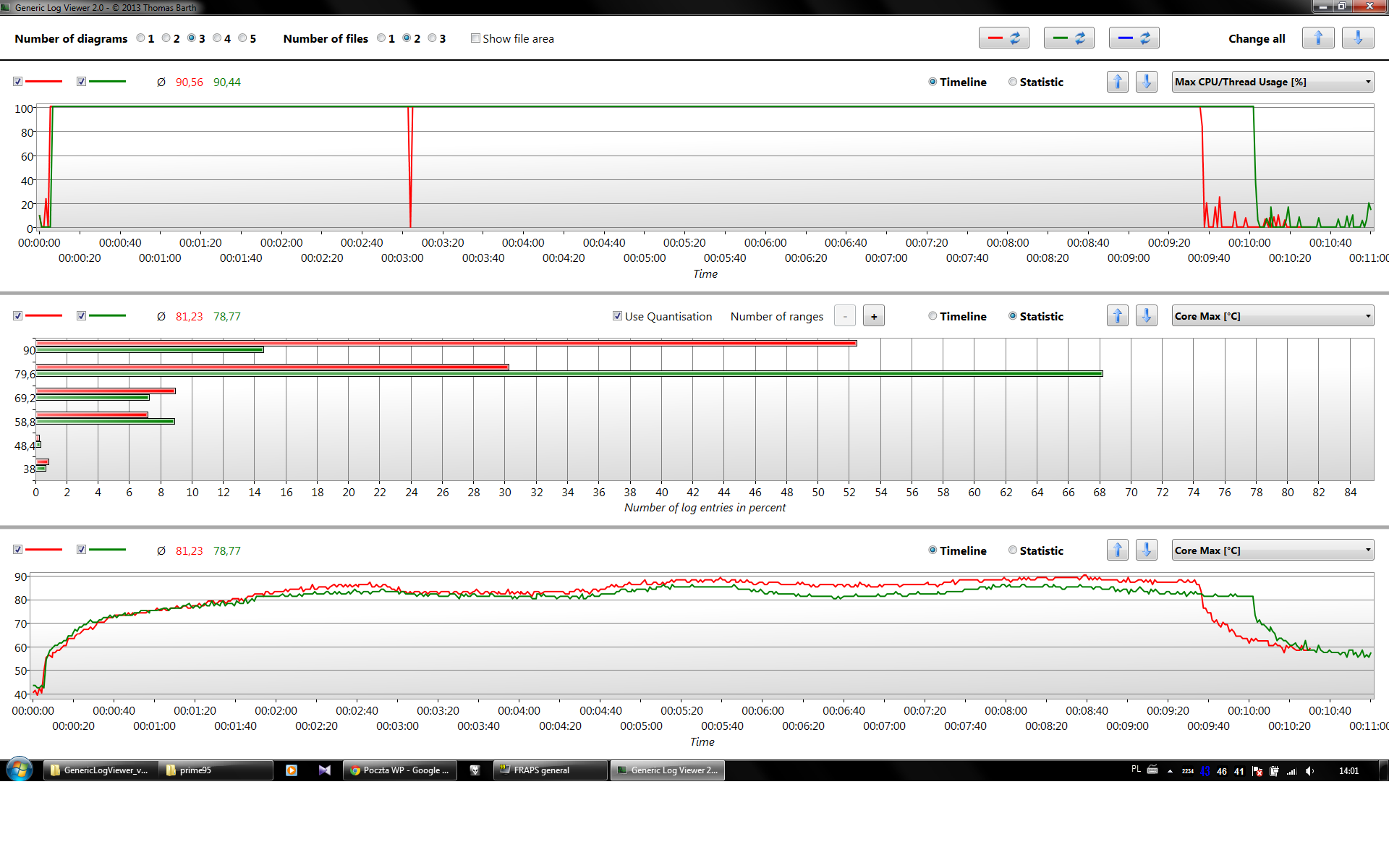

You're right. But if I clockdown 3632 it should be more cool than 45W CPU, shouldn't it?
For sure, you will probably see about 0-5c difference but at the expense of 8x600mhz = 4.8Ghz total. Note that 45W quads operate restricted to 35-40W in our machines. That's why the load temps are tolerable. My 3360M hit 90C+ in prime same way the 3840QM does. The cooling mod was maybe about 5W total if I'm very lucky...

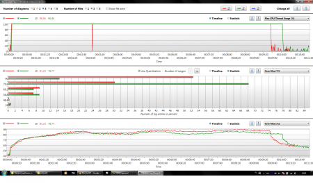

10 minutes for Prime95 test. Comparison for 2570p on the table vs lifted. Take a look on statistic version of data, clear 10C difference for CoreMax (90C vs 80C). :)
[ATTACH=CONFIG]9124[/ATTACH]
Nice temps. Did you force the fan or let run at stock settings (BIOS controlled)?
When put on the table and temps were near 90 there was 5000rpm. When lifted there was 4500rpm. It was on Smart HPFanControl mode. 5000rpms are the highest possible cause of fan mod.
Hour after test, there are average 38-41C temps but I have to admit today is rather cool in my room (less than 20C). During summer there will be something around 50-55C on average CPU temps :(

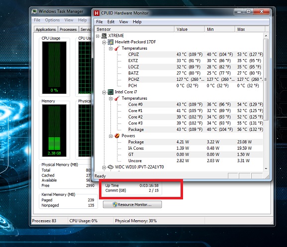

Grab a CPU MSR dump (which utility?) when it's in your 45W state and compare the MSR when it's in 35W mode. There may be some way of forcing your '45W mode' permanently without a bios flash. Throttlestop would be the tool to do whose author, Unclewebb, would I'm sure be interested in this unusual '45W' state that you've encountered. Unclewebb has a tool to write individual MSR bytes here.
Here's a screenshot. Running @3632QM clocks, normal computing, browsing, etc. No elevation, no forced fans, no chest freezers.
I don't hear the fan at all. Even the vent is cold to touch, lol

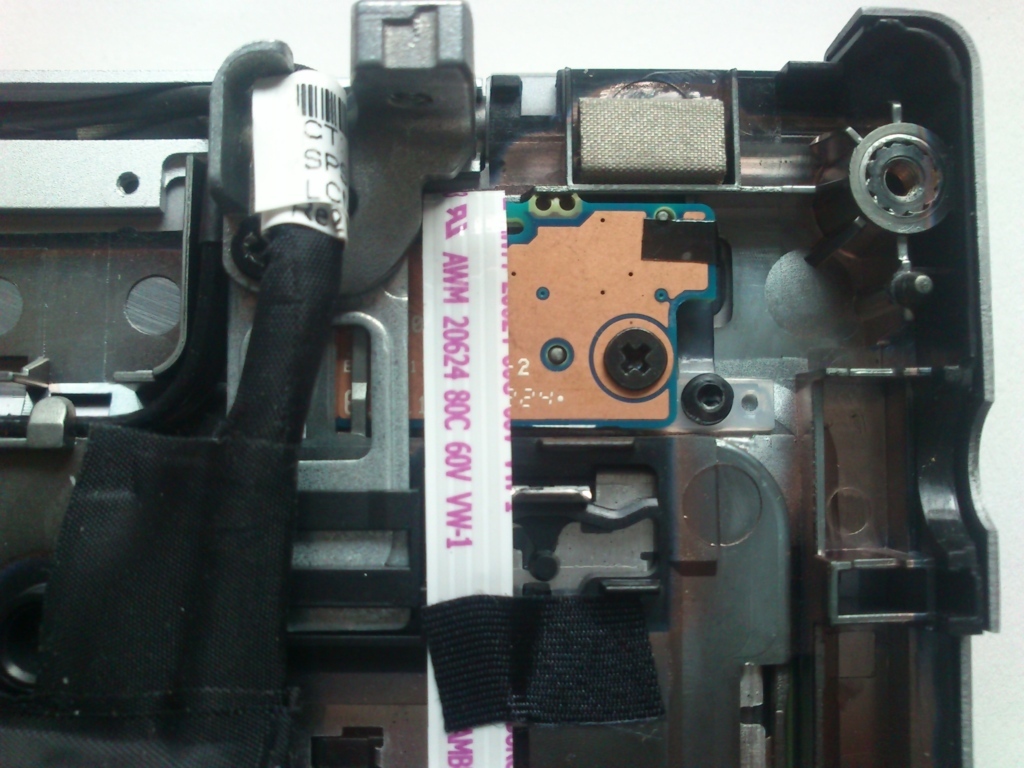

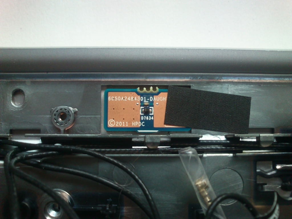

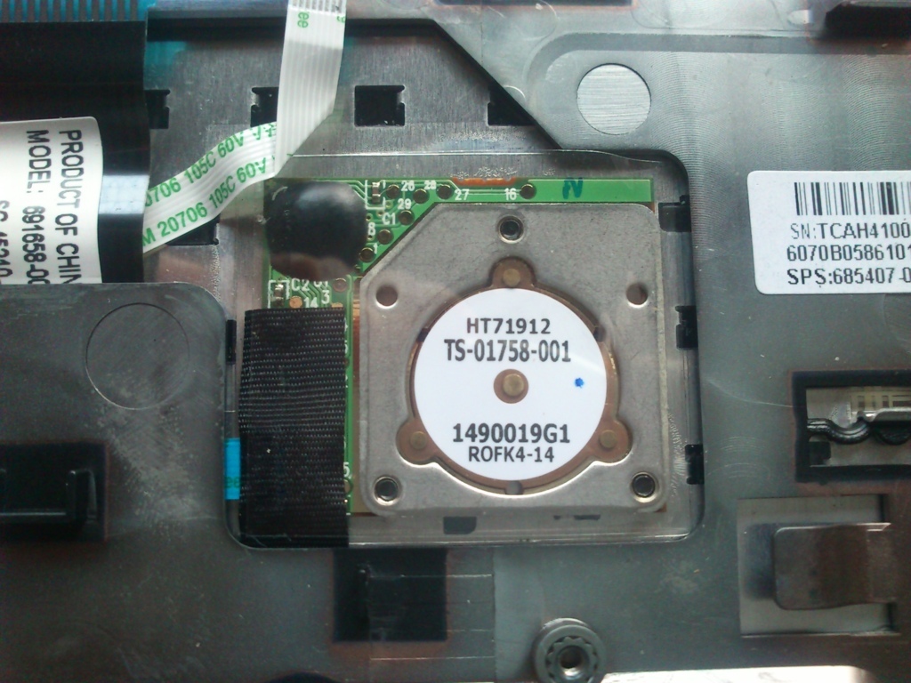

2570P uses magnets to hold LCD cover down
It was mentioned that a cosmetic difference between the 2560P and 2570P was the removal of the top cover latches. This also meant the 2570P palmrest has done away with the two palmrest holes to provide a latch catch edge as was found in the 2560P. This gives the 2570P a cleaner look.
So then how does the 2570P hold the lid down? By accident I had a metal object near the shift key when I discovered it was being held against the system chassis. There are magnets near the left and right shift keys and along both sides of the LCD. Those attract each other when the top cover closed so as to keep it closed.
You were faster ;) Cause I was wondering why right side of laptop (above USB and DP) attracts my cables ;)

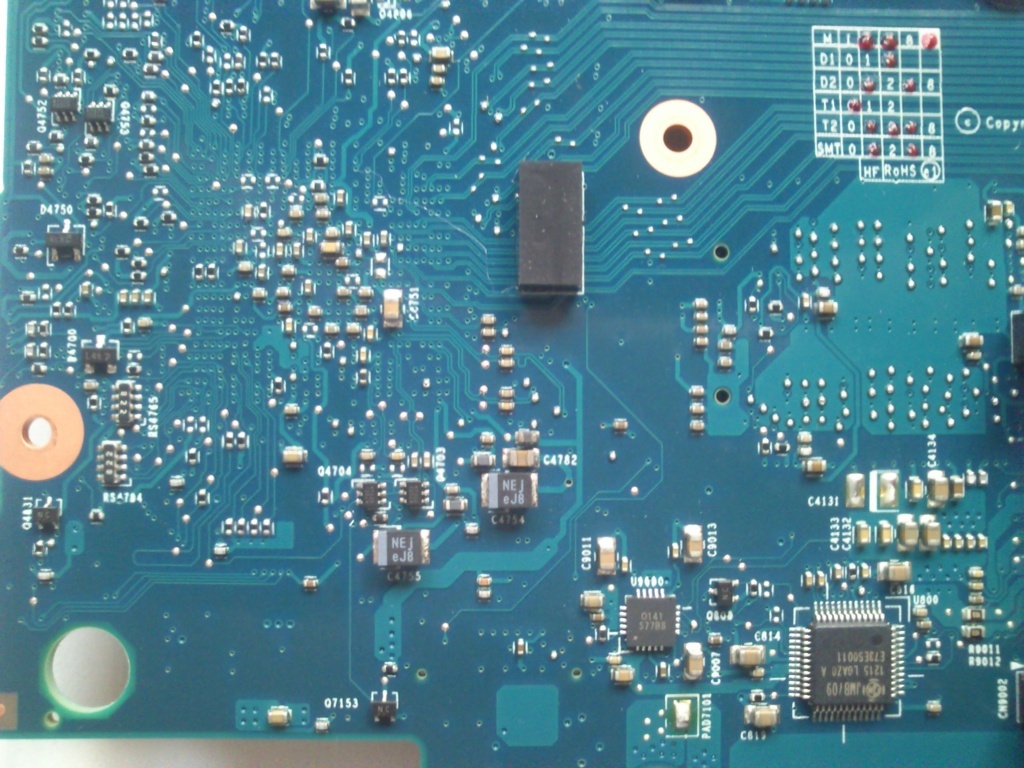

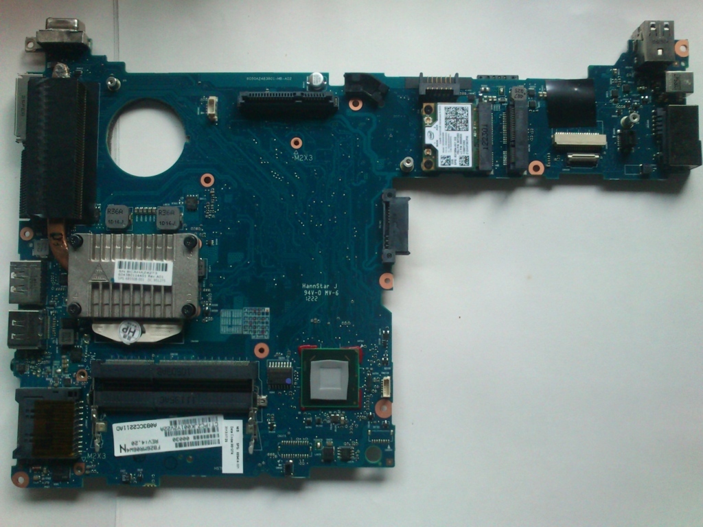

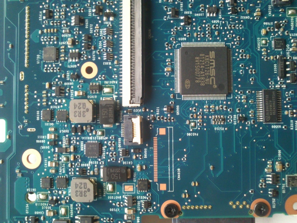

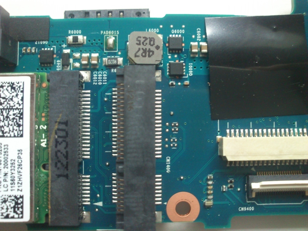

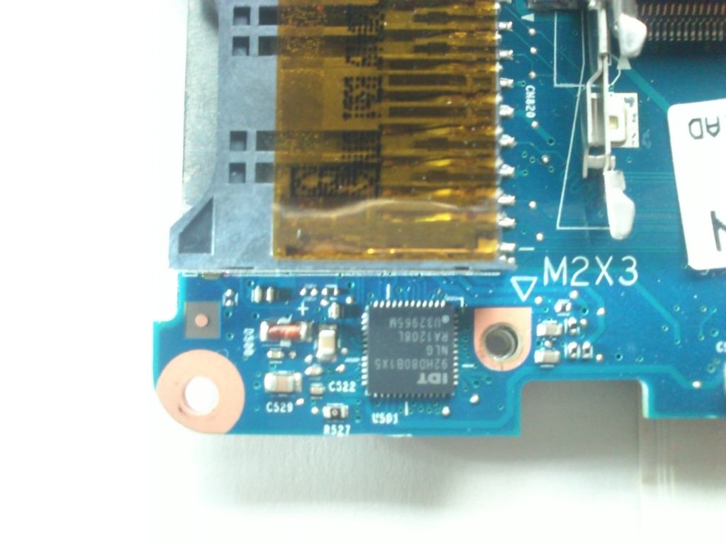

I've checked the wwan slot's pin, the power supply and GND pin are the same as msata slot, just pin 23,25,31,33 were cut by HP, so I connect them and test with a msata card. Unfortunately startup bios detect it is not wwan and disable it, maybe is whitelisted. And then I cover pin 45,47,49,51, it still stop at bios detect. So i think it also should remove wifi/wwan whitelist from bios.
Change wifi card (intel 6205) to wwan slot, it still disable at bios startup, and into windows system can't found 6205. It was absolutely block by bios.
My msata SSD is TOSHIBA THNSNF256, the pin 23,25,31,33,45,47,49,51 are main, the others are power supply, GND and NC(pin 20 is not used at my ssd).So i don't know how hp detect the card is wwan.
[ATTACH=CONFIG]9022[/ATTACH][ATTACH=CONFIG]9023[/ATTACH]
Unfortunately those test results don't tell us if those extra lines are mSATA or mPCIe as it seems *BOTH* are halting the BIOS bootup. This is strange as you'd expect one that isn't the correct protocol to pass BIOS checks. I mean if the slot is mPCIe and there's a mSATA card in there, it can't get a PCI ID to compare against in the whitelist.
That is *unless* your mSATA SSD has a USB interface providing the system a USB ID that fails WWAN whitelisting checking. Cover the USB pins 36 and 38 (USB) and retest.
Here's some more speculation. Do you have a 6150 (8087:07D6) WiMAX card for testing?
INFO: 2570P WWAN/WIFI/Bluetooth whitelist
8087:07D6 Kelsey Peak    [Intel Centrino Wireless N + WiMAX 6150]
Strong speculation: the WWAN slot can be WWAN+mPCIe with soldered resistors
This whitelisted device is a combo IEEE 802.16e WiMAX and 802.11 b/g/n WiFi wireless adapter which the 6150 product brief tells us uses Connector interface: PCIe electrical interface for WiFi, USB 2.0 for WiMAX.
The 2570P wifi slot is PCIe only with no USB lines connected. The WWAN slot is only USB 2.0 from the factory. Though the 2560P schematic shows port1 pci-e line to the WWAN slot which never made it to production.
So then this is a strong indicator that wiring up those extra 4 disconnected lines in the WWAN slot (23,25,31,33) using 0ohm SMT resistors could extend that slot from USB to USB+PCIe. If so it means too then it wouldn't be USB+mSATA as mSATA and mPCIe uses those same same transmission tracks.

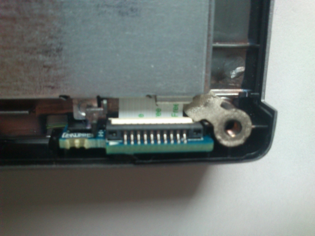

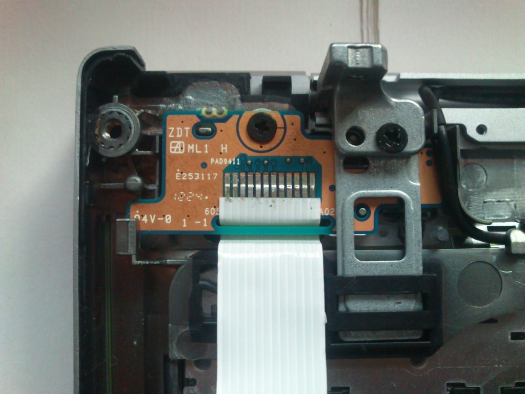

About backlit keyboard, do anyone know a good DIY approach for this? The screen lamp can't be meant for this right? (LOL'd hard when I first saw it)
I think that we could supply the backlit keyboard with the additional cable for USB charging port (top one on the back of the laptop). To make sure, we'd need to disassemble the laptop or find a schematics to see, what voltage does this cable have (I think that backlit need 5V). And we would need to disassemble the port anyway, to solder a keyboard cable to the USB cable.

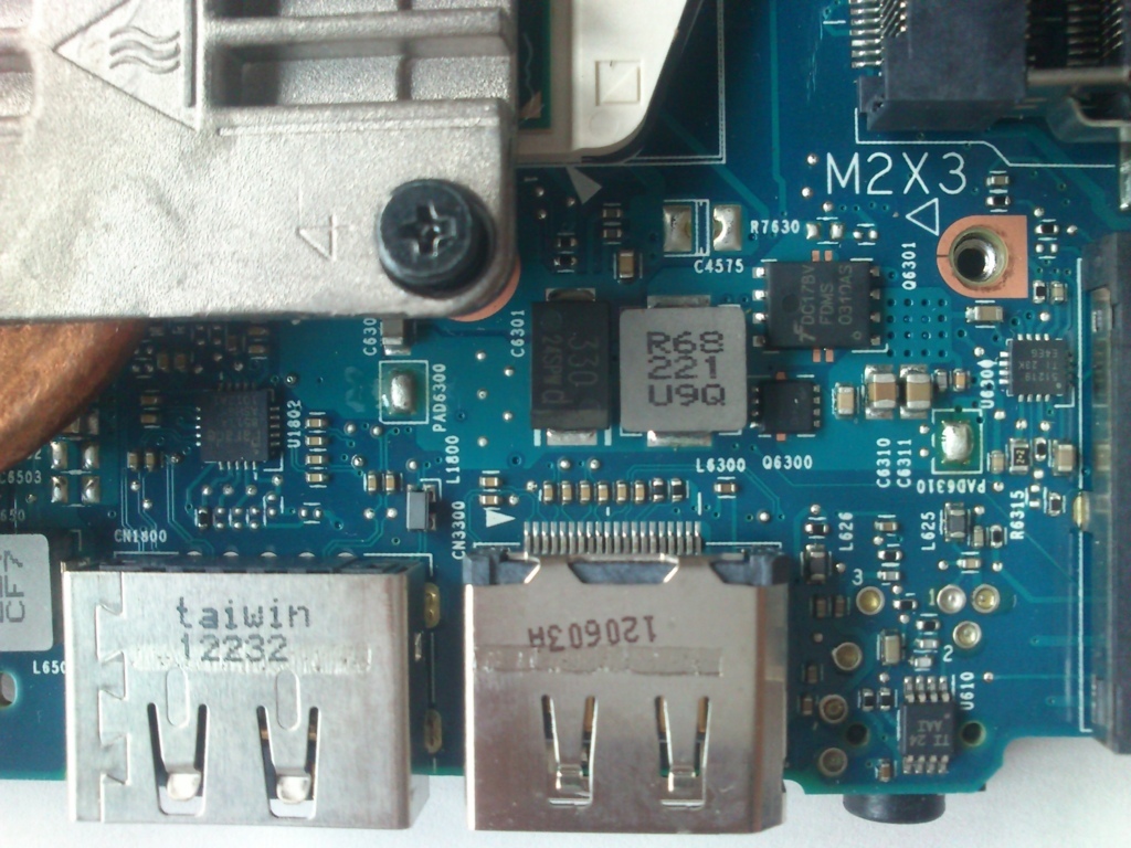

But we need to confirm that USB charging port is really different from other ports (I think it is, because DAC connected to it has better sound quality, which means it has higher voltage), and check the voltage of the baclit.
@jot23 Even if there will be option to pass voltage to the backlit where are you going to take backlit from? :)
I thought, that it's a part of the keyboard itself, and the only problem is the power supply/wiring. And that 2170p keyboard did not fit because of size and latches incompatibility.

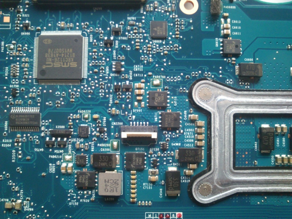

experimental howto: fitting a '820 G1' backlit keyboard
It's pretty straightforward if the keyboard itself fits into the chassis insert correctly. There is an additional backlight ribbon cable that requires either 3.3V+GND or 5V+GND patch leads attached to an appropriate spot on the 2570P systemboard to power the backlight.
Here's an tutorial of how a backlit keyboard was retrofitted to an Acer 3820T by doing just this: Acer TimelineX 3820TG Backlit keyboard mod

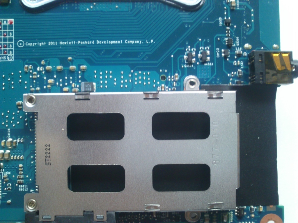

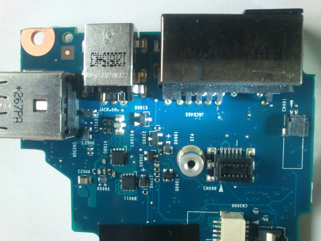

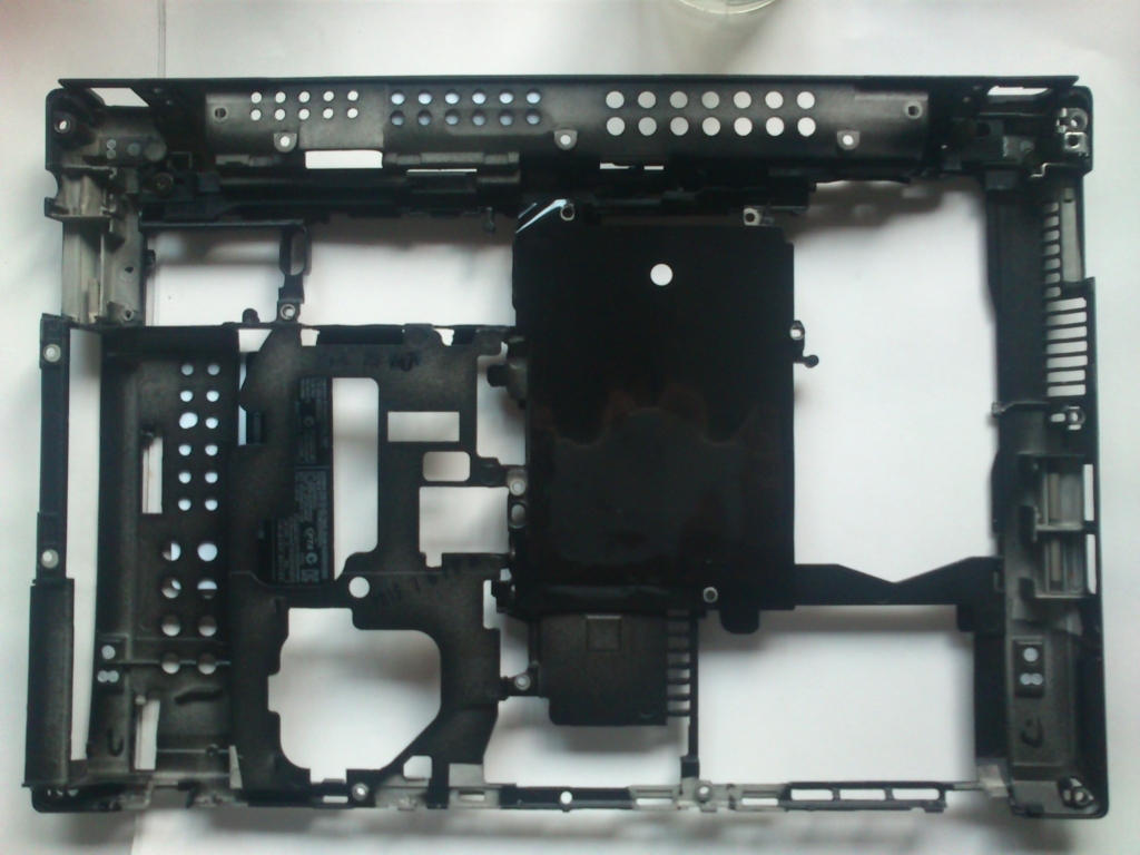

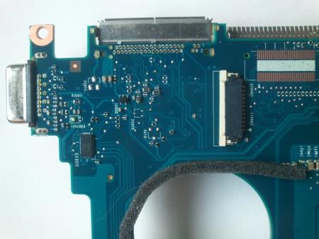

I disassembled the motherboard and try to connect the pcie pin to dock esata pin. The dock pin is too mini to soldered it and the dock esata pin is not the same as HDD/ODD/ESATA port. I thinked the docking station may have some chip to adapt it, because HDD/ESATA PORT has another chip to keep singnal(see 2560P diagram). It's the best way to find out dock's sata point near PCH chip, but I had no idea to find it on the PCB without the map.
Sorry for my poor english.

Awesome temps Bro! But your ambient/room temp is really low :) BTW, if you are using eGPU, your CPU temps will be even lower. My CPU draws an extra 15W for the IGP part during games.
Yea, ambient is really low, something between 15-20C. thats for sure in normal ambient 20-25C there will be <45C on CPU and during summer <55C.
You're right, I got much lower temps during gaming FarCry3 (i7QM) on eGPU than VanHelsing (i5) on iGPU ;)
