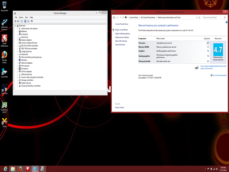

Genetics Posted November 16, 2012 Share Posted November 16, 2012 Me re-confirmed Alienware M15x works with Windows 8 Pro as well! i7-720QM with AMD 7970M! Quote Link to comment Share on other sites More sharing options...
