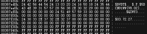

I've got a newer BIOS backup (BIOS only, no EC) which is 5DCN91WW(V8.02) from a user at Lenovo Support forum.
The BIOS date is 2014/XX/XX. That means the Y480/Y580 BIOS is still being updated.
Could you just updated the modded version if interested?
Here is the BIOS link
This new Y580 Bios LENOVO 5DCN91WW V8.02 question... - Lenovo Community
I PM the user to get it directly. I don't think it needed to doubt after the communication with the user in email for detail.
That's strange that an admin removed the BIOS download link even though it's one of their own.
Moderator comment: Link to BIOS of unknown origin removed.

https://www.dropbox.com/s/7asppsk9wr4zbu9/LENOVO-5DCN91WW%28V8.02%29.rom
As it is confirmed a new edition, I think it necessary to be explored and modded.
I have posted it before, but it seems that svl7 never comes here again.(busy maybe)
Could someone get svl7 informed?
Or someone with an SPI programmer and some BIOS modding experience*
EDIT: Is the microcode updated? New options? Are the release notes available somewhere?
