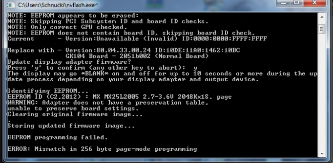

por Posted February 22, 2013 Share Posted February 22, 2013 If you flash the wrong vbios version in the windows cmd how would you be able to flash the old version back? NVflash does not recognize my card in DOS... and so the only way for me to flash a vbios is via the cmd in windows as described in the next post. Quote Link to comment Share on other sites More sharing options...
por Posted February 22, 2013 Share Posted February 22, 2013 For some reason the nvflash link doesn't work when I boot into dos and do nvflash -a the program hangs up and I have to reboot. is there anywhere I can get a working version? A solution to this problem vie the windows cmd is available here: Which Nvflash version to use for GTX 680M? the attachment is about something else, i don't know how to remove it Quote Link to comment Share on other sites More sharing options...
