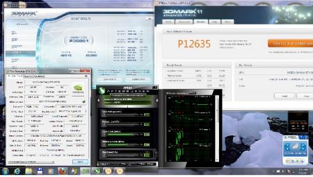

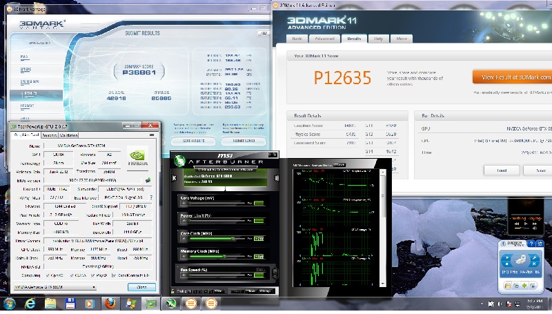

MeNtAl_DaRkNeSs Posted December 14, 2012 Share Posted December 14, 2012 Hi ppl, So far this vBios is working great on my Clevo P150EM I got stable clocks at 960/1200. Best Regards to all Quote Link to comment Share on other sites More sharing options...
