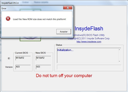

[ATTACH=CONFIG]5329[/ATTACH]
I've got this error while trying to flash to A03 unclocked with latest OROM. I already have A03 unlocked running.
Could anyone help me with this problem?

i took the QBR10EC.fd from M18x_R2_-_BIOS_A08_-_[unlocked]_-_[iRST 11.0.6.1702] and copied it over the QBR10EC.fd inside M18x_R2_-_BIOS_A08_-_[unlocked] and then click InsydeFlash.exe , and it worked,, there is something wrong with platform.ini in the rst 11.6 one
