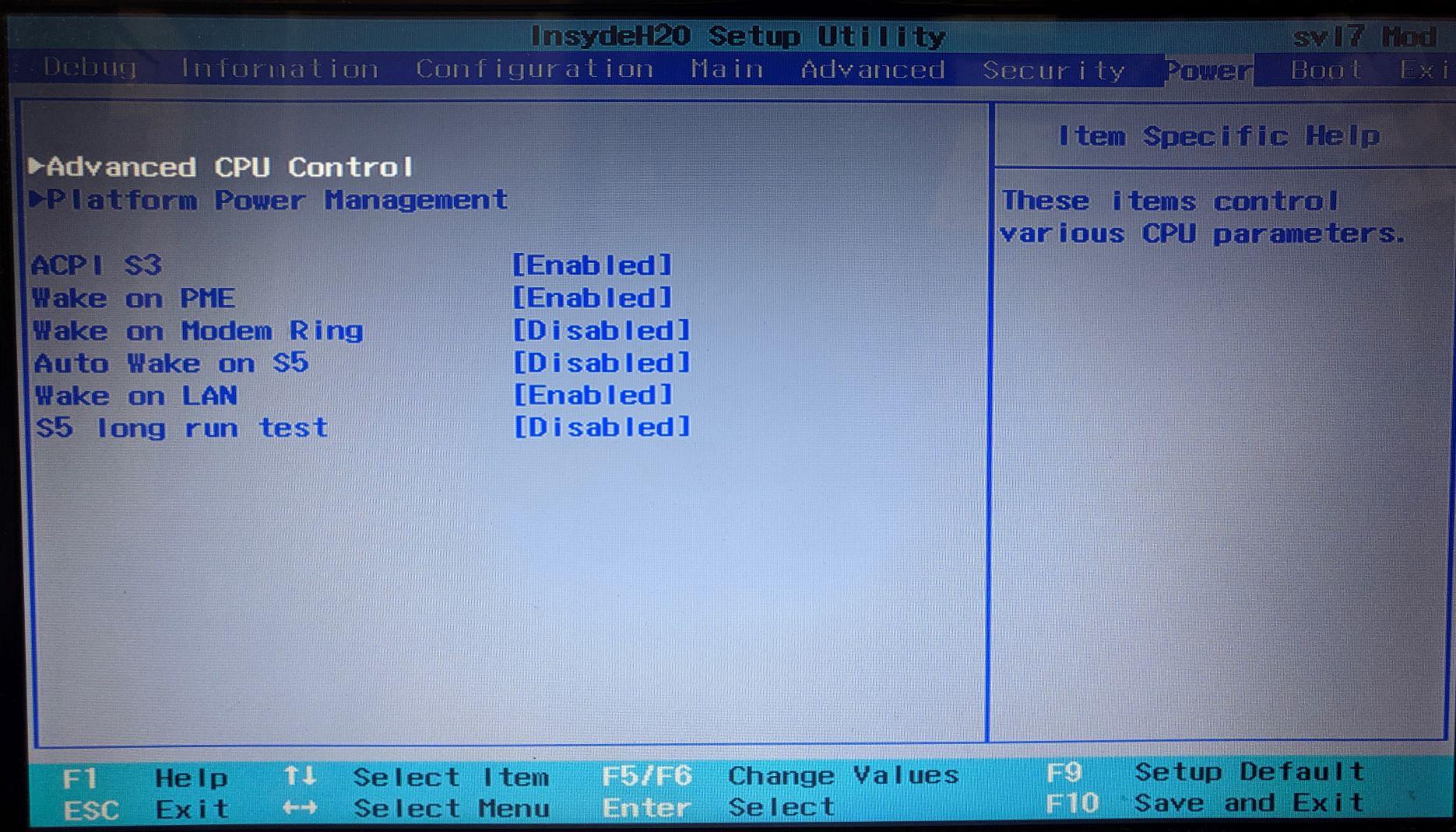

@TechDeveloperHi. I also need wake on lan feature. My laptop is lenovo y410p. I can wake my laptop from sleep state but can't wake in hibernate state or shutdown state. In the stock bios there is no option like wake on lan. After flashing the modded bios(thanks to svl7 who made this mod) I found some new options. I enable these options, but nothing happened. I'm still unable to wake in hibernate state or shutdown state. I hope this can help you, or you could tell me something I missed about wol.

@VahalHi. I also need wake on lan feature. My laptop is lenovo y410p and system is Windows 10 1903. I can wake my laptop from sleep state but can't wake in hibernate state or shutdown state. In the stock bios there is no option like wake on lan. After flashing the modded bios(thanks to svl7 who made this mod) I found some new options, including "Wake On PME" and "Wake On Lan". I enable these options, but nothing happened. I'm still unable to wake in hibernate state or shutdown state. Do you have any idea about this?
