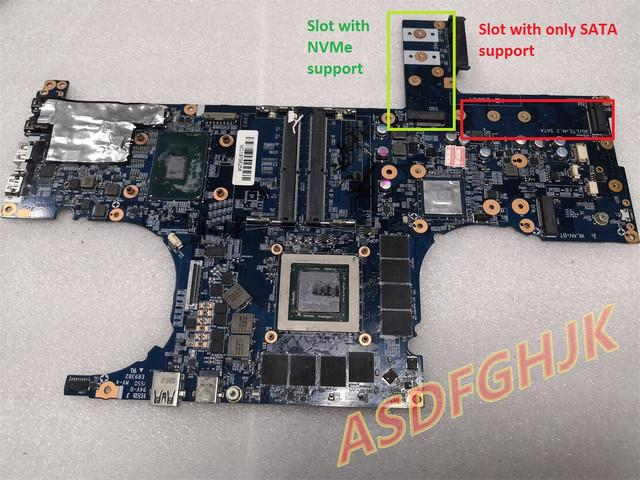

Kelvin Ng Posted July 14, 2023 Share Posted July 14, 2023 (edited) I owned a laptop branded Aftershock but I've check with the seller it's Clevo P650SE motherboard. I recently bought a 2TB Lexar NM790 m.2 nvme and install it but the laptop doesn't recognize it anywhere be it in BIOS or in Windows 11. @Klem I tried the tool your posted but it has error says Error 201: [FPTw.exe] cannot be run on the current platform. Please contact your vendor. Will that be ok? The link to the file: https://mega.nz/file/H0BEgCqQ#Ap1StWEADvV1ZgLm779FGWWMkxNOD4q33ZnsHGAn0s8 Edited July 14, 2023 by Kelvin Ng Quote Link to comment Share on other sites More sharing options...
Bios Modder Klem Posted July 14, 2023 Bios Modder Share Posted July 14, 2023 On 7/14/2023 at 7:07 AM, Kelvin Ng said: I owned a laptop branded Aftershock but I've check with the seller it's Clevo P650SE motherboard. Hi! Your laptop model have CLEVO P650RG motherboard (not Clevo P650SE motherboard). This laptop model already have NVMe support by default from manufacturer. So, no need any bios modifications. For NVMe SSD, you can use only one slot, look at the picture: 1 Quote Link to comment Share on other sites More sharing options...
Kelvin Ng Posted July 15, 2023 Share Posted July 15, 2023 You’re right, I installed one nvme m.2 and leave the other slot empty and it works out of the box! Didn’t know it’s P650RG, the seller must have it wrong as it is way too long ago. Quote Link to comment Share on other sites More sharing options...
