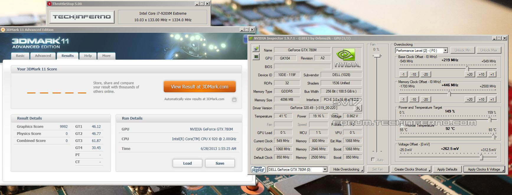

Teaser:
Coming soon to a mobile Kepler GPU in your notebook... let me present you - full control:
If don't notice anything, check the Nvidia Inspector... :P
Edit: Ah yeah, btw, that's on my M15x ;)

Teaser:
[ATTACH=CONFIG]7935[/ATTACH]
Wow... and I assume that the power slider takes care of the throttling with power draw?
Any chance the 680m can get live voltage control too?
Yeah... as long as your board and system can handle it. Those MSI with 180W PSU and that "NOS" crap won't stand this, I can guarantee it.
Lol... right, I think I shouldn't have posted this, now I will to redo all the vbios files here, hahahaha, damn :D Should work, yes.
