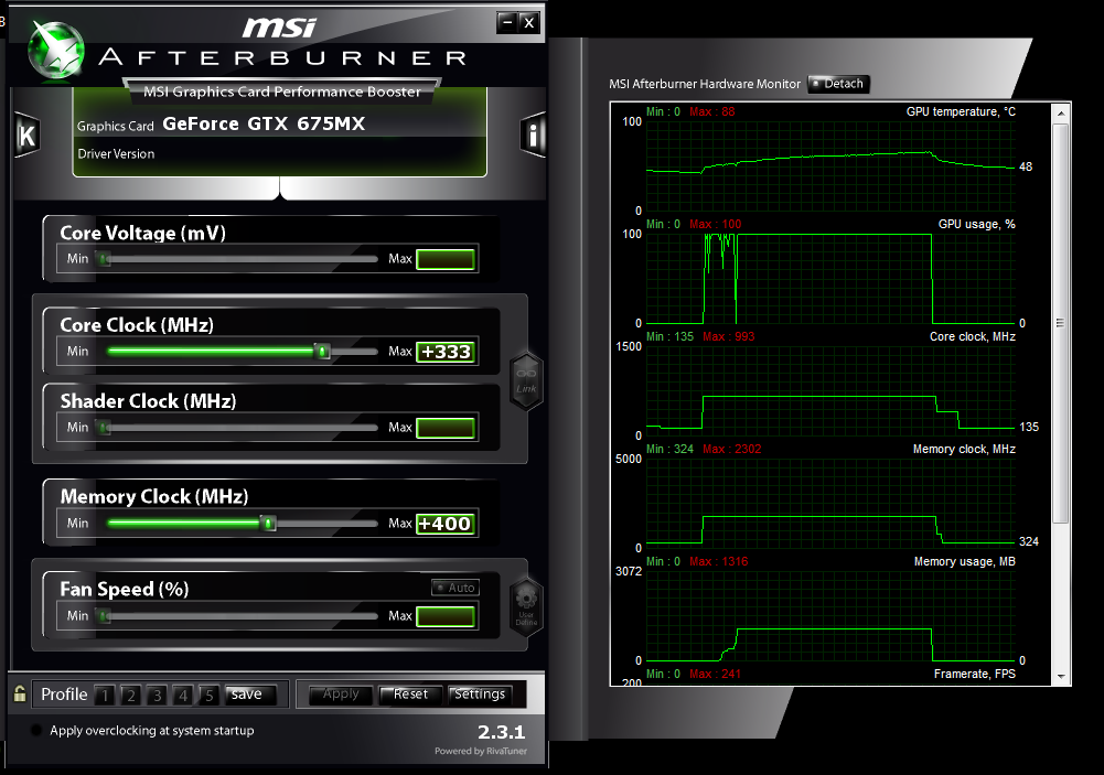

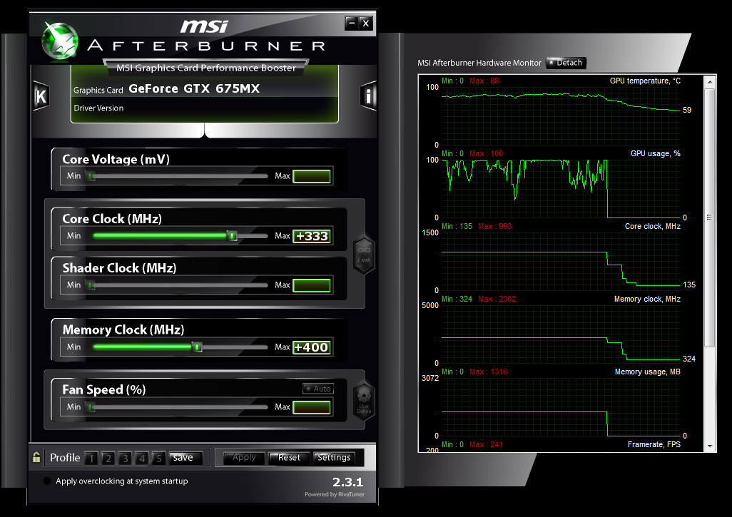

Also, does anyone now why my GPU Usage ALWAYS looks like this while playing Crysis 3 or FarCry 3?
No other games do this... they will all max out GPU Usage at 100% while these games make it jumpy, causing frame drops left and right... it kind of makes the games unplayable
This is how it looks with all other games:
[ATTACH=CONFIG]7785[/ATTACH]
[ATTACH=CONFIG]7786[/ATTACH]
Maybe you are getting cpu limited and its causing the usage on the card to drop. I get this in BF3 at times, but it doesnt happen often.
I kind of have a similar problem with GTA 4. When I was finding for a reason, I found out that my CPU was limited making the usage fluctuate.
But I have an i7 3610... that has to be enough for the CPU side of any game, right? Metro 2033 never does this, neither does Skyrim
I've found BF3 to be pretty cpu intensive, but I don't think cpu limit is your problem here.
It doesn't look like you're hitting the 90C throttle since gpu clocks are not dropping even though performance is. Note that if you do fix this throttle that you will be hitting 90C and experience throttling because of that, but the performance impact should be more mild.
I got similar drops in gpu usage when running my card for a while with a slightly unstable memory overclock. Try dropping your clocks a little.
If that doesn't fix it, then I think your problem is throttling due to high power draw. Default bios will throttle when under heavy load even if temps are ok. You may be able to run a 2GB dell BIOS, but I am not certain. I suggest waiting for what svl7 says you can flash on.
Interesting... I do at the moment have the 2GB MSI voltmod BIOS that is on the OP... and you're right it must be power draw, the default BIOS didn't do this... but it only gave me 4000 on 3d mark 11 while the voltmod gets me 7000+. I guess I'll just wait on a reply like you suggest lol
