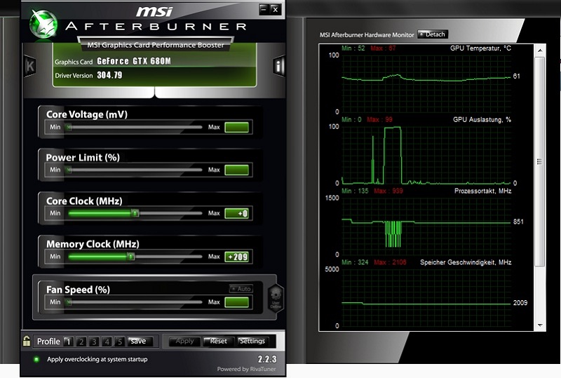

Ok. Tests are done, all 3 ones. Unfortunately the 680m is still throtteling down to 222 Mhz.
Higher clocks, and a slightly different approach regarding the mod. More specific information about the versions can be found in the second post.
What I find especially puzzeling is the fact that the "deep" throttling with brief spikes down into the 200eds happens primarily with benchmark tools: for me, most prominently with 3DM11 and Vantage (as many other have stated, above +100 MHz OC Core, + 200 MHz OC mem), and less so with Unigine Heaven (for me, it's "stable" up to 900+ MHz). In games, I've yet to experience this behaviour. What's more, a higher OC yields a definite performance increase in gaming as expected, so it is only because of the throttling that 3DM scores start to go down again.
However, there's another "soft" throttling that's especially apparent for me in WoW. Rather that erratically fluctuating between around 200 and max for less than a second, the GPU will clock to different freqs for extended periods of time. Most often when doing so, it will stay above default at 720+ MHz, seldom it will clock down to around 650 MHz. I am not sure that this is the same underlying mechanism, it could just be the "bored throttle" with less demanding games. It does, however, happen even when power settings are set to prefer maximum performance rather than adaptive and not only in less demanding scenes.

Only with software like furmark or if the heat rise the danger zone of 90 + °C ... (this is the behavior i see on mine ...)

@Eldaren : On 3Dm11 : Be aware that the card go to idle mode during the loading of the test (so between the different test)

i test quickly the bios mod based on clevo :
The idle bug (caused by msi vbios) seem to disapear ... but i made some test and the card seem to throttle when i break the wall of 853 Mhz (3dmark11 score goes down)
maybe a light overvolt could fix this i presume ...
BTW good job, it help me determine that the idle bug is msi vbioses fault on P150HM/gtx680m combo.
