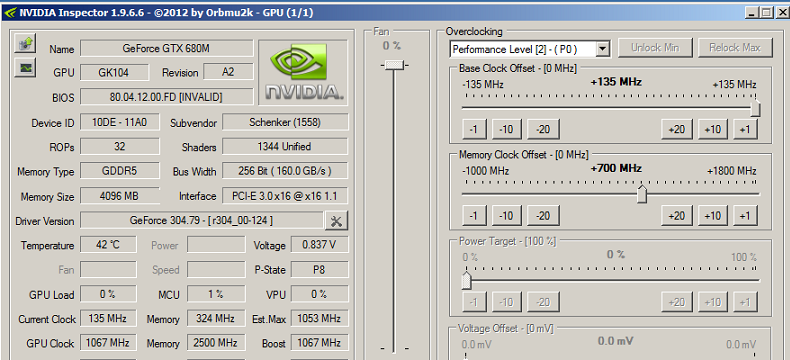

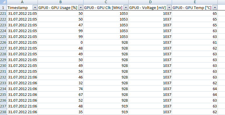

bmpm5 Posted July 31, 2012 Share Posted July 31, 2012 Hi, something weird is happening. Flashed svl7 vbios with 1.037V 932/1800 Overclocked it to 1067/2500 and played Skyrim. After a while i got a black screen and a couple of seconds afterwards it continued without any issues. I looked at the nvidia inspector settings and the logfile of the monitor and somehow the oc reset to stock oc of 932/1800. If I look at the log screen nothing unusual happened. The temp was way within limits. Maybe a driver issue? Would be glad for some suggestions. Thanks guys Quote Link to comment Share on other sites More sharing options...

widezu69 Posted July 31, 2012 Share Posted July 31, 2012 Hi,something weird is happening.Flashed svl7 vbios with 1.037V 932/1800Overclocked it to 1067/2500 and played Skyrim.After a while i got a black screen and a couple of seconds afterwards it continued without any issues.I looked at the nvidia inspector settings and the logfile of the monitor and somehow the oc reset to stock oc of 932/1800.If I look at the log screen nothing unusual happened.The temp was way within limits.Maybe a driver issue? Would be glad for some suggestions.Thanks guys[ATTACH=CONFIG]4648[/ATTACH][ATTACH=CONFIG]4650[/ATTACH]Dude that's because your overclock is way too high. Your driver crashed and reverted back to original speeds because your card can't take speeds like that. Start low and work your way up. Quote Link to comment Share on other sites More sharing options...

bmpm5 Posted August 1, 2012 Share Posted August 1, 2012 Dude that's because your overclock is way too high. Your driver crashed and reverted back to original speeds because your card can't take speeds like that. Start low and work your way up.Hi,I now clocked the card to 1030/2400 and everything is fine even after 2 hours gameplay.Will slowly try to up the clocks again to find the sweetspot.Thanks for your help Quote Link to comment Share on other sites More sharing options...
widezu69 Posted August 1, 2012 Share Posted August 1, 2012 Hi,I now clocked the card to 1030/2400 and everything is fine even after 2 hours gameplay. Will slowly try to up the clocks again to find the sweetspot. Thanks for your help There we go. That's more like it! Quote Link to comment Share on other sites More sharing options...

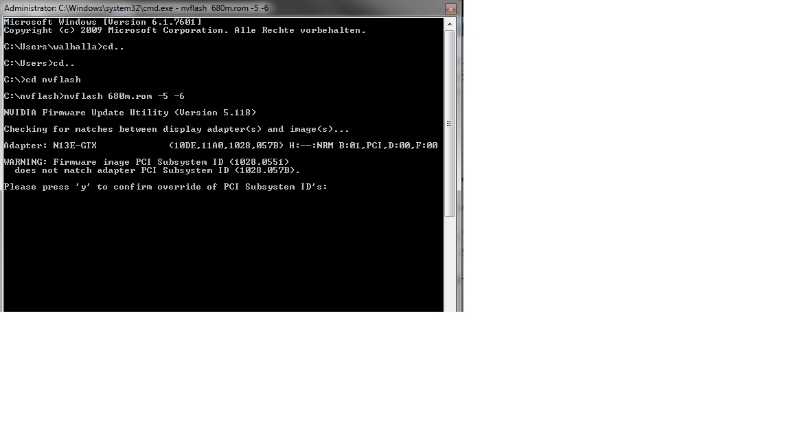

walhalla Posted August 4, 2012 Share Posted August 4, 2012 I´d tried to flash my bios (m17x R4 - 680m). I got this The PCI subsystem does not match my subsystem. Is this correct. I used the bios from the first site without voltage mod at 819 Mhz. Quote Link to comment Share on other sites More sharing options...
svl7 Posted August 4, 2012 Author Share Posted August 4, 2012 Yeah, that's normal, the adapter and vbios SSID don't even match with the stock vbios which is pre-installed on your system. Just confirm the flash, it's fine.Guess I should mention this on the first page. 1 Quote Link to comment Share on other sites More sharing options...
