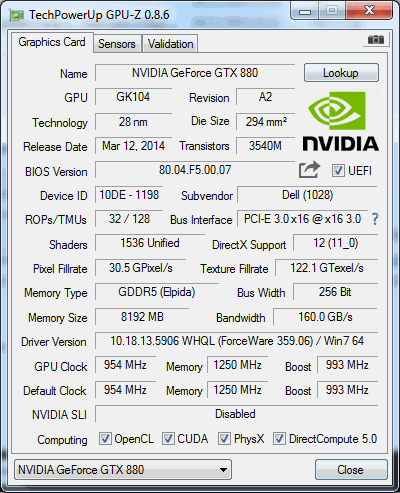

hi, dunno why but on my m17xr4 and 880m with svl7 vbios mod oc i got throttle. when monitoring gpu-z sensor, i saw gpu core was throttling as hell, going from 40% to 99% and if i do a 3dmark vantage test it will quit with error after 30 seconds. all is fine with original bios of the card, but is there a way to be able to install vga drivers without mod inf? i read of a dude able to use 3d and install normal driver on a m17x 3d and 880m .
here is my original bios.
GK104_880m_8gb_dell.rom

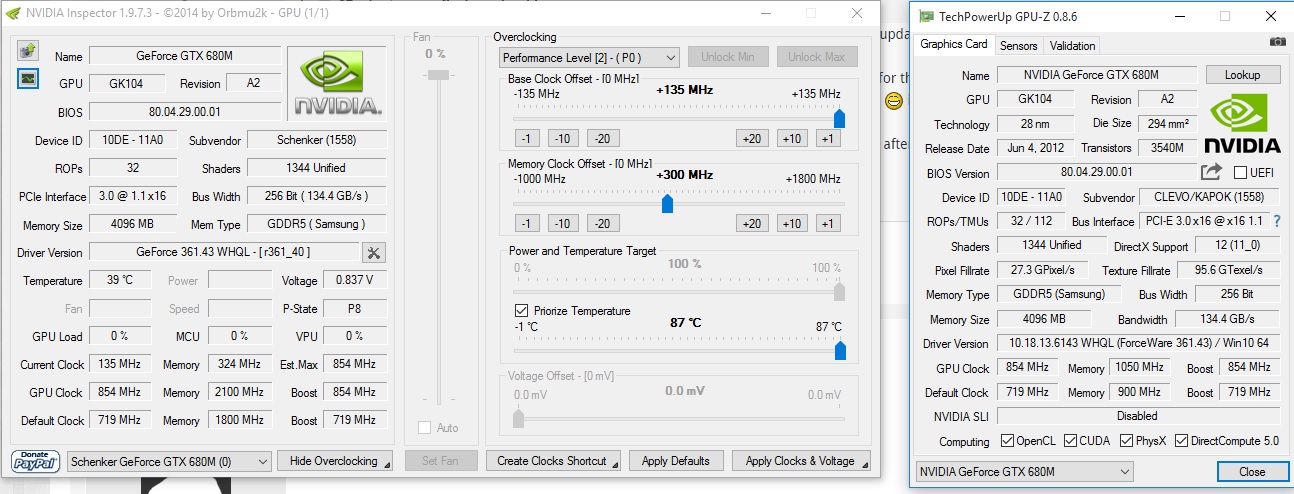

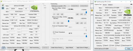

hi there. so i recently oc my gpu for the first time. i use an clevo p150m with a gtx680m. i updated my bios to the prema bios. for overclocking of my gtx680m i use nvidia inspector. highest i can go is +135Mhz. but i think that more would be possible.
i've heard that with some kind of new bios i could oc even more? i would have to ask you for the basics, though. i am pretty new in this oc-thing. could anyone help me with my issue? i see people uploading pictures and some other person then just simply "makes" a new bios for them? :D is that how it works? what information would you need from me and would you please tell me how to install that new bios? same as the regular bios via DOS?
well, you can tell i am kind of a noob. usually i would just buy a new card or notebook but after i have seen how amazing overclocking works, how much power you can get without spending money, i want to overclock until maximum. ;-)
thanks

13 hours ago, Peter4010 said:
I am searching for a Vbios for my GTX880m (Clevo) . I did´t find the link ?
Look at the first post of this thread:
Nvidia 800m series:
Nvidia GTX 880m (8GB version only):
  • 'OC edition' -> unlocked overclocking limits, voltage adjustable, power target adjustable, optimized performance at higher clocks
    Can be used for all current 880m (Clevo, MSI and Dell).
