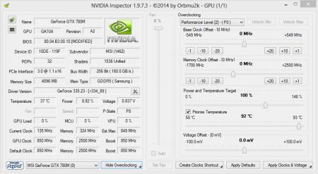

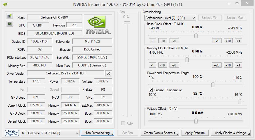

Need help.. I managed to update my vbios using the Nvidia GTX780M 'OC Edition'.rom that I download in the 1st page.. the process complete.. and when I boot to windows.. device manager detects my card as "Microsoft Basic Display Adapter"... anyone encounter this? I'm looking for a solution..
Sys Info:
MSi GT70 20D Dragon Edition 2
Nvidia GTX780M
I7-4700M Processor
BIOS (stock & locked)
BIOS Version: E1763IMS.50J
BIOS Release Date: 2013/10/07
EC Version: 1763EMS1 Ver5.05, 07/23/2013
CPU: Intel® Core i7-4700MQ CPU @ 2.40GHz
Memory: 8192 MB @ 800 MHz
- 8192 MB, DDR3-1600, 0420 MIF4D1D167HZ1J
Graphics: Microsoft Basic Render Driver, 0 MB
Graphics: NVIDIA GeForce GTX 780M, 4096 MB
Graphics: Intel® HD Graphics 4600, 2080 MB
VBIOS Version: 80.04.97.00.04
I did backup my vbios and now using the old one.. Thanks in advance..

That's fine, just reinstall the drivers after flashing and it should recognize it. I had a similar issue when I used to own an M18x.
  • Founder
@Brian Thanks for your reply.. But when i try reinstall the drivers the setup say no hardware detected.. I'm using nvidia 335.23 drivers.. any idea why it didn't work out?
You may need to modify the nvidia ini file for your device id. [MENTION=119]Mr. Fox[/MENTION] knows how to do that and so does @J95
Yeah you have to write your new Hardware ID into nvaci.inf (located where you extracted your driver --> NVIDIA\DisplayDriver\358.91\Win10_64\International\Display.Driver\nvaci.inf
Open it with Notepad, find the correct section, maybe you have to google to find your ID. You should find all the IDs in DeviceManager, when you right-click on the GPU and select Properties --> Details. Mine is
%NVIDIA_DEV.11A0.0270.1558% = Section015, PCI\VEN_10DE&DEV_11A0&SUBSYS_72001558
Then scroll down towards the end of the file, and you see something like
NVIDIA_DEV.11A0.7200.1558 = "NVIDIA GeForce GTX 680M". Just enter your values and of cours write "780M". Finished! Save and run the installer again (setup.exe in C:\NVIDIA\DisplayDriver\358.91\Win10_64\International\International).
Finally manage to make it run.. thanks for everyone help.. post-40808-14495001205721_thumb.jpg
