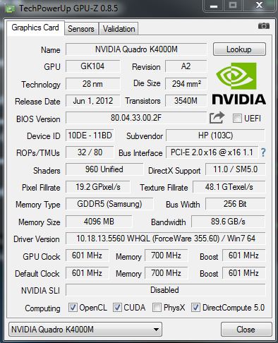

Hi SL7v,
can you mod me a vBios from my HP8770w Notebook - there is a HP Quadro K4000M integrated...when i'm back in my office i'll grab the bios from it with GPU-And post it here...
Thanks bro :)
Gesendet von iPhone mit Tapatalk
Here the original vBios from my HP8770W:
http://www.file-upload.net/download-10955106/HP_K4000M_80.04.33.00.2F_from_HP8770W.rom.7z.html
I#ve allready flashed your submitted modified Dell K4000M Bios - but i'm still not able to overclock the GPU for more than +135MHz - Afterburner set this to max overlocking Limit...
