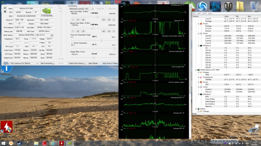

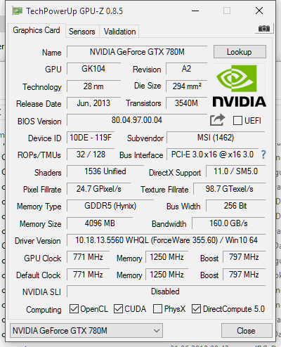

I have a P370SM3 with a 780m stock clocks and stock vBios. When under load (gaming) the card will regularly hit the 92-93 deg C mark then the fans will start to spin faster to cool the card down. I'm reading on this forum that the temps should stay below 80 deg. Is this still the case for a laptop? If so, is this normal behavior for stock clocks and vbios or should I investigate a repaste job or look for updated EC/mainboard bios to help with fan speed control?
Also, would the vBios linked in the first few posts help in this case?
