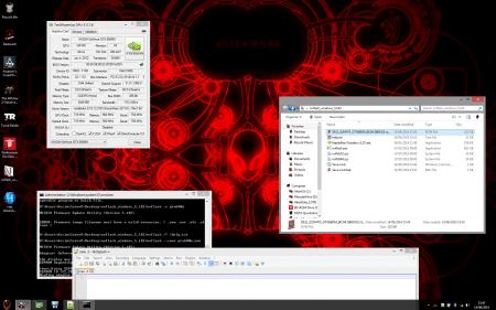

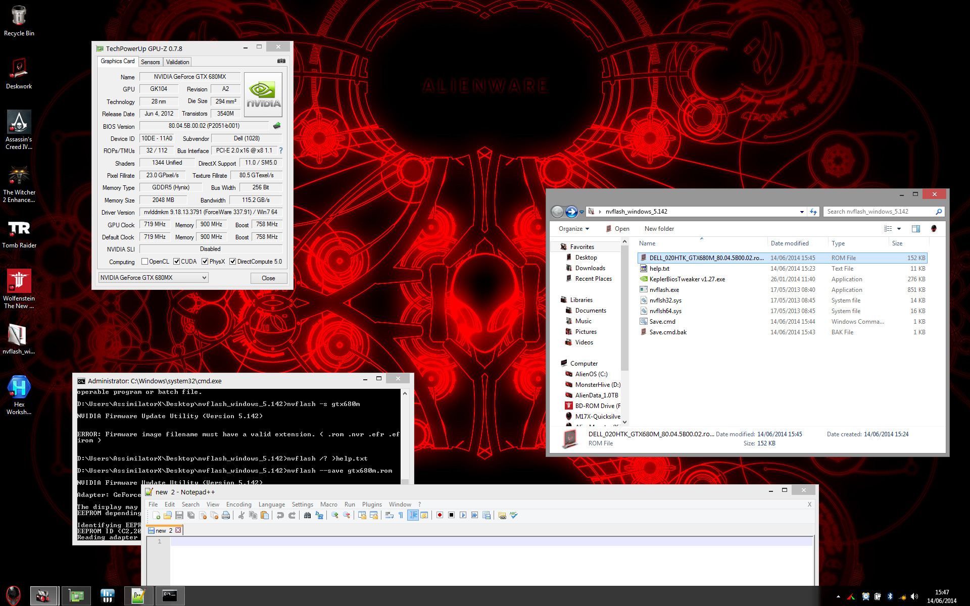

Hello,
Need some info if someone can help,
Just upgraded my R2 Dual AMD Mobility Radeon HD 5870 to one lovely GTX 680M card.
Its running SMOOT and a real "plug in heater" 89c after 8hours of gaming, no artifacts or slowdowns. Its really stable...
I think is a bit hot compared to the Radeon cards they not usually went over 65/70c, Just in case i ordered a left side M18X GPU heatsink and try to modify it to fit the R2 chassis. I will take pictures when is arrive. The interesting part is that i dont have to use hwinfo to control the fan is seems working. it looks hwinfo causing more problem and heat than without it.
The card is a DELL Card (020HTK) with vbios 80.04.5B.00.02. I used someone else inf file and is recon is a MX card but actually is not.
Anyone have experience with this?
DELL_020HTK_GTX680M_80.04.5B00.02.zip
