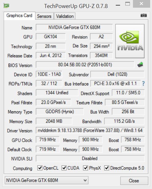

Sergeant Posted June 5, 2014 Share Posted June 5, 2014 Can I use all of these BIOS versions for my 680m? What is the right bios for my 680m? (Dell Alienware M18xR2) Dell 680m - 80.04.33.00.32__'OCedition'_revised_00.zip (52.3 KB, 230 views) Dell 680m - 80.04.33.00.32__'OCedition'_revised_00 - OV 1000v.zip (52.4 KB, 203 views) Dell 680m - 80.04.33.00.32__'OCedition'_revised_00 - OV 1025v.zip (52.4 KB, 197 views) Dell 680m - 80.04.33.00.32__'OCedition'_revised_00 - OV 1050v.zip (52.4 KB, 282 views) Dell 680m - 80.04.5B.00.02_'OCedition'_revised_00.zip (116.9 KB, 270 views) Here is my card Quote Link to comment Share on other sites More sharing options...

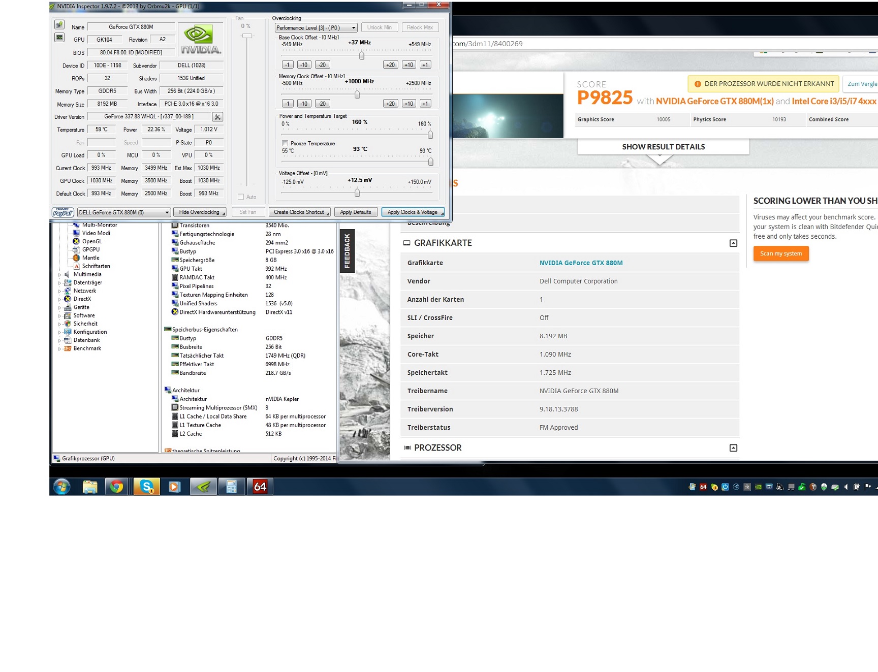

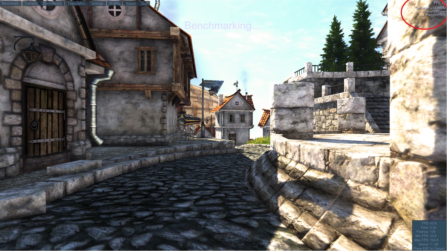

6zumlachen Posted June 5, 2014 Share Posted June 5, 2014 yo guys i dont know why but my 880m memory is just epic...i can overclock it stable to +1000 lol... gives me about 9500 score in 3d mark 11 without touching GPU clock... 993/3500 this is 3dmark 11 and 3dmark scoreNVIDIA GeForce GTX 880M video card benchmark result - Intel Core i3/i5/i7 4xxx,Alienware 04WT2GNVIDIA GeForce GTX 880M video card benchmark result - Intel Core i3/i5/i7 4xxx,Alienware 04WT2GTemps are low 80 highest while 3dmark. Quote Link to comment Share on other sites More sharing options...
Robbo Posted June 5, 2014 Share Posted June 5, 2014 yo guys i dont know why but my 880m memory is just epic...i can overclock it stable to +1000 lol... gives me about 9500 score in 3d mark 11 without touching GPU clock... 993/3500 this is 3dmark 11 and 3dmark scoreNVIDIA GeForce GTX 880M video card benchmark result - Intel Core i3/i5/i7 4xxx,Alienware 04WT2GNVIDIA GeForce GTX 880M video card benchmark result - Intel Core i3/i5/i7 4xxx,Alienware 04WT2GTemps are low 80 highest while 3dmark.Well, actually +500Mhz actually if you want to talk about the ACTUAL Mhz increase, from 1250Mhz to 1750Mhz, that's still a 40% overclock on the memory though! Your problem you talked about with your core overclock seems to be your imaginings then judging by your 3DMark results, looks like it came down to your previous problems being just due to your overclock being unstable then. Quote Link to comment Share on other sites More sharing options...
6zumlachen Posted June 5, 2014 Share Posted June 5, 2014 Well, actually +500Mhz actually if you want to talk about the ACTUAL Mhz increase, from 1250Mhz to 1750Mhz, that's still a 40% overclock on the memory though! Your problem you talked about with your core overclock seems to be your imaginings then judging by your 3DMark results, looks like it came down to your previous problems being just due to your overclock being unstable then. no its + 900MHZ on inspector... its 2x 1750 u need to count 1250 + 1250 = 2500 1750 + 1750 = 3500 -/+ 1000Mhz u forgot its a 8GB not a 4GB I am able to get +1000 memory stable but once i touch the core over +25mv its done.... well i get 10k score on 3D Mark 11 with a single card thats good without overclocking gpu core that much. Quote Link to comment Share on other sites More sharing options...
Robbo Posted June 5, 2014 Share Posted June 5, 2014 no its + 900MHZ on inspector... its 2x 1750 u need to count 1250 + 1250 = 2500 1750 + 1750 = 3500 -/+ 1000Mhz u forgot its a 8GB not a 4GB I am able to get +1000 memory stable but once i touch the core over +25mv its done.... well i get 10k score on 3D Mark 11 with a single card thats good without overclocking gpu core that much. What are you talking about, memory clock on 880M is 1250Mhz at stock, 3DMark reports your memory clock at 1750 (and so would GPUz too), which is +500Mhz. I'm well aware that there are different ways of reporting the memory clock, some programs multiply the ACTUAL frequency that the memory chips run at by a factor of 2, other's by a factor of 4 - it's due to the Quad-pumped nature of GDDR5. But, nevertheless, the actual frequency it runs at is what is reported in GPUz. You've gone from 1250Mhz to 1750Mhz (+500Mhz ACTUAL frequency increase) - simple as - nothing to do with whether you have 8GB or 4GB. Yes, you were a little unlucky with the core overclock, it's not stable for you at higher overclocks, but your memory overclock is good. Quote Link to comment Share on other sites More sharing options...

6zumlachen Posted June 5, 2014 Share Posted June 5, 2014 What are you talking about, memory clock on 880M is 1250Mhz at stock, 3DMark reports your memory clock at 1750 (and so would GPUz too), which is +500Mhz. I'm well aware that there are different ways of reporting the memory clock, some programs multiply the ACTUAL frequency that the memory chips run at by a factor of 2, other's by a factor of 4 - it's due to the Quad-pumped nature of GDDR5. But, nevertheless, the actual frequency it runs at is what is reported in GPUz. You've gone from 1250Mhz to 1750Mhz (+500Mhz ACTUAL frequency increase) - simple as - nothing to do with whether you have 8GB or 4GB.Yes, you were a little unlucky with the core overclock, it's not stable for you at higher overclocks, but your memory overclock is good. yo, once more i dont have +500mhz with 500 my score is like 400 points less.. ....i understand what u say its quadD but those scores are not able with only +500... this is +900/1000 memory which unigine heaven shows as 3500 in benchmark. i dont know why 3D mark doesnt but i am able to overclock the memory to +1000 stable. All i am telling you is that i just overclocked the memory on inspector to +900 / 1000 and its stable. this score is with +900Mhz around i overclocked on inspector memory +/- 900/1000 NVIDIA GeForce GTX 880M video card benchmark result - Intel Core i3/i5/i7 4xxx,Alienware 04WT2G above 1000 is not stable. my 780M gtx could go max to like 550 because of the 4GB... i expected the 880M with 8GB better memory to 1000 so yea...its giving a boost of 700 points on 3d mark and in games around 7 FPS more. Funny is that the card is not running hotter... i believe its because i am not able to stress the full 8GB ... Please everyone with a 880M GTX do not up ur core clock that much it makes the card trottle even more... try to up the memory its overclocking like crazy and games gain more performance Quote Link to comment Share on other sites More sharing options...
deadsmiley Posted June 5, 2014 Share Posted June 5, 2014 yo, once more i dont have +500mhz with 500 my score is like 400 points less.. ....i understand what u say its quadD but those scores are not able with only +500... this is +900/1000 memory which unigine heaven shows as 3500 in benchmark. i dont know why 3D mark doesnt but i am able to overclock the memory to +1000 stable. All i am telling you is that i just overclocked the memory on inspector to +900 / 1000 and its stable. this score is with +900Mhz around i overclocked on inspector memory +/- 900/1000 NVIDIA GeForce GTX 880M video card benchmark result - Intel Core i3/i5/i7 4xxx,Alienware 04WT2Gabove 1000 is not stable.my 780M gtx could go max to like 550 because of the 4GB... i expected the 880M with 8GB better memory to 1000 so yea...its giving a boost of 700 points on 3d mark and in games around 7 FPS more.Funny is that the card is not running hotter... i believe its because i am not able to stress the full 8GB ...Please everyone with a 880M GTX do not up ur core clock that much it makes the card trottle even more... try to up the memory its overclocking like crazy and games gain more performance [ATTACH=CONFIG]11812[/ATTACH]Good Lord! +1000 on the memory. I can only get to +500. At +510 my card crashes in 3DMark 11.From my testing I would say you are correct on the GPU. I can't get much out of it without throttling due to heat. I will have to look into some cooling mods for that. Quote Link to comment Share on other sites More sharing options...
jackhanoka Posted June 5, 2014 Share Posted June 5, 2014 Nvidia has quite a mess with the more recent drivers. The newest one is certainly not recommendable imo. The suggested driver above is one that works pretty well, but of course it lacks support for the most recent games, so you might just want to try different drivers and find one that fits your needs best.Drivers. That would be my first guess. Try an older one, e.g. 327.23 if you want to bench.svl7--Why do you not recommend the latest driver 337.88-Are there any glaring issues with it?ThanksJack Quote Link to comment Share on other sites More sharing options...
Robbo Posted June 5, 2014 Share Posted June 5, 2014 yo, once more i dont have +500mhz with 500 my score is like 400 points less.. ....i understand what u say its quadD but those scores are not able with only +500... this is +900/1000 memory which unigine heaven shows as 3500 in benchmark. i dont know why 3D mark doesnt but i am able to overclock the memory to +1000 stable. All i am telling you is that i just overclocked the memory on inspector to +900 / 1000 and its stable. this score is with +900Mhz around i overclocked on inspector memory +/- 900/1000 NVIDIA GeForce GTX 880M video card benchmark result - Intel Core i3/i5/i7 4xxx,Alienware 04WT2Gabove 1000 is not stable.my 780M gtx could go max to like 550 because of the 4GB... i expected the 880M with 8GB better memory to 1000 so yea...its giving a boost of 700 points on 3d mark and in games around 7 FPS more.Funny is that the card is not running hotter... i believe its because i am not able to stress the full 8GB ...Please everyone with a 880M GTX do not up ur core clock that much it makes the card trottle even more... try to up the memory its overclocking like crazy and games gain more performance [ATTACH=CONFIG]11812[/ATTACH]You seem very confused on the memory reporting front, so not much point discussing that anymore, I've already told you that you're running +500Mhz ACTUAL increase in memory frequency, which is reported by GPUz as +500Mhz above your stock value, NVidia Inspector reports it as +1000Mhz, and some other programs might describe that as +2000Mhz - but it's ACTUALLY REALLY only +500Mhz in reality. I'll just leave it there. Quote Link to comment Share on other sites More sharing options...
6zumlachen Posted June 5, 2014 Share Posted June 5, 2014 You seem very confused on the memory reporting front, so not much point discussing that anymore, I've already told you that you're running +500Mhz ACTUAL increase in memory frequency, which is reported by GPUz as +500Mhz above your stock value, NVidia Inspector reports it as +1000Mhz, and some other programs might describe that as +2000Mhz - but it's ACTUALLY REALLY only +500Mhz in reality. I'll just leave it there.i am not confused i told you +1000 is my memory overclock and you see the picture thats it. QDR is what u are talking about and i know that if i overclock 100MHZ on inspector it shows 50mhz on GpuZ. What i said was that i overclocked the memory to +1000 on inspector. My friend who has the same card is not able to go above +540 on inspector so thats what i am saying maybe i got different memory chips? asked 2-3 people with the same 880m on clevo and they cant go that high. My friend with the same cpu and gpu get around 400 point less on 3dmark with + 540 Memory while i got +1000 i cant explain that. Quote Link to comment Share on other sites More sharing options...
J95 Posted June 5, 2014 Share Posted June 5, 2014 You're both wrong...8GB has nothing to do with it. GDDR5, +1000MHz = 7000MHz, +500MHz = 6000MHz. 1 Quote Link to comment Share on other sites More sharing options...
6zumlachen Posted June 5, 2014 Share Posted June 5, 2014 You're both wrong, 8GB has nothing to do with it. GDDR5, +1000MHz = 7000MHz, +500MHz = 6000MHz.yep so the overclock is +1000 as the pictures shows 6998 MHZ memorywhatever do u know if its normal that it can clock that high? it doesnt work on my friends clevo gives crash and one guy on forum said that aswell Quote Link to comment Share on other sites More sharing options...
Robbo Posted June 5, 2014 Share Posted June 5, 2014 You're both wrong...8GB has nothing to do with it. GDDR5, +1000MHz = 7000MHz, +500MHz = 6000MHz.I'm not wrong because I agree with your post.I'm simply saying GDDR5 can be reported as (using stock 880M as an example):1250Mhz on GPUz => this is the ACTUAL frequency that the chips run at2500Mhz in NVidia Inspector5000Mhz in some other programs (Guru3D review site often quote this figure)The above goes along with what you said in your post.- - - Updated - - -i am not confused i told you +1000 is my memory overclock and you see the picture thats it. QDR is what u are talking about and i know that if i overclock 100MHZ on inspector it shows 50mhz on GpuZ. What i said was that i overclocked the memory to +1000 on inspector. My friend who has the same card is not able to go above +540 on inspector so thats what i am saying maybe i got different memory chips? asked 2-3 people with the same 880m on clevo and they cant go that high. My friend with the same cpu and gpu get around 400 point less on 3dmark with + 540 Memory while i got +1000 i cant explain that.(Don't know why you're bringing in other points to the discussion about your friend, nothing to do with our little discussion on memory reporting - you're kind of all over the place.) Quote Link to comment Share on other sites More sharing options...
6zumlachen Posted June 5, 2014 Share Posted June 5, 2014 I'm not wrong because I agree with your post.I'm simply saying GDDR5 can be reported as (using stock 880M as an example): 1250Mhz on GPUz => this is the ACTUAL frequency that the chips run at 2500Mhz in NVidia Inspector 5000Mhz in some other programs (Guru3D review site often quote this figure) The above goes along with what you said in your post. - - - Updated - - - (Don't know why you're bringing in other points to the discussion about your friend, nothing to do with our little discussion on memory reporting - you're kind of all over the place.) I dont want to flame here but what u said makes no sense cause its not my question why am i able to get +1000Mhz on this 880m while others crash at 500+. Both overclocked with inspector. Do u even own a 880M to test before u talk? Good Lord! +1000 on the memory. I can only get to +500. At +510 my card crashes in 3DMark 11.From my testing I would say you are correct on the GPU. I can't get much out of it without throttling due to heat. I will have to look into some cooling mods for that. thats what i want to know. Since we both use inspector for overclocking right? we should see the same results on gpu can u check your memory chips names? ill do it aswell. You got clevo 880M im sure its 8GB aswell. Quote Link to comment Share on other sites More sharing options...
