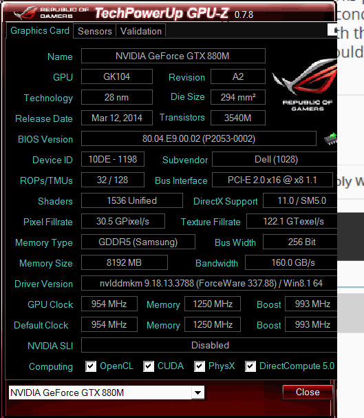

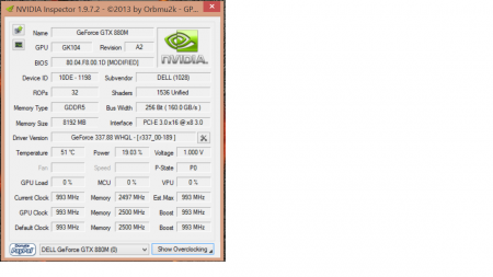

so i applied the new 880M vbios today on my M17xR4 + reinstalled the video-driver (337.88).
so far so good, but i observed some strange behaviour when trying to downclock the core.
- standard gpu-clock is @993mhz
- i use nvidiainspector to change the clocks
- anything between 614mhz and 849mhz wont be recognized.
- i can choose rates between these two values, and nvispector shows them under "gpu clock", but "current clock" stays an either 614mhz or 849mhz
(for example, i tried to apply a 793mhz clock, down from 993mhz. so i choose "-200 base clock offset". "gpu clock" correctly shows the new value of 793mhz, but "current clock" immediatly goes to 614mhz until i change the "base clock offset"-value to -400 or more).
any tips what might cause this behaviour?!
Yes that's right. Actually ca 835MHz should work as well. After all it's called "OC edition" not "UC version".
If you want to run at 700Mhz the stock vbios will do the job as well.

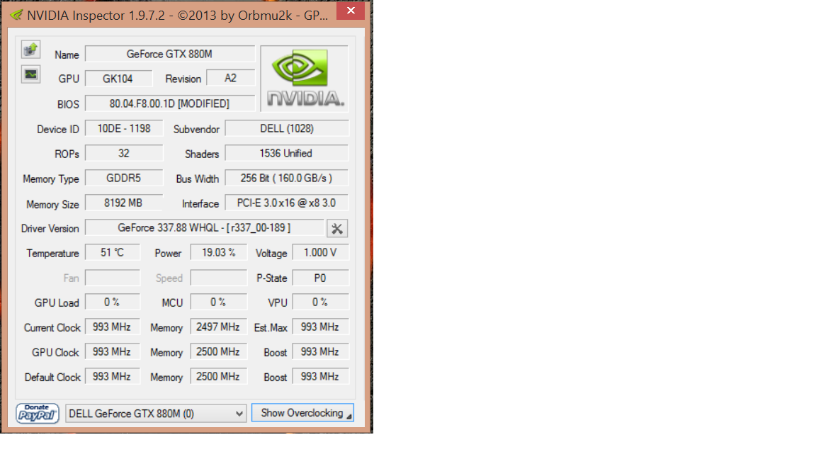

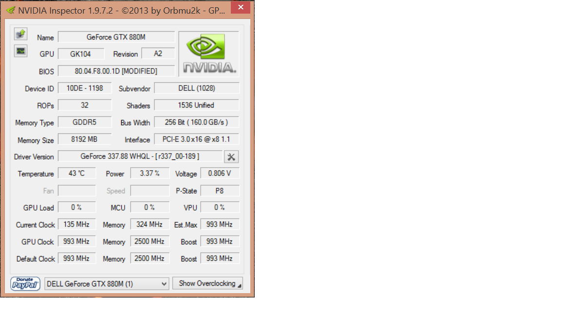

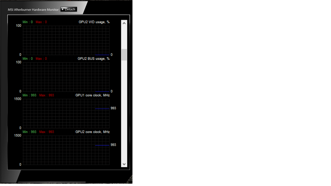

Well indeed I have this problem of the cards staying at full power at idle. What can I do to fix it?
I fixed it thanks for the reply and the mod svl7. Turns out that Nvidia Experience was in my startup and preventing my downclocking.
Dropping -8c at idle makes me happy.

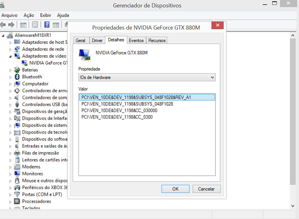

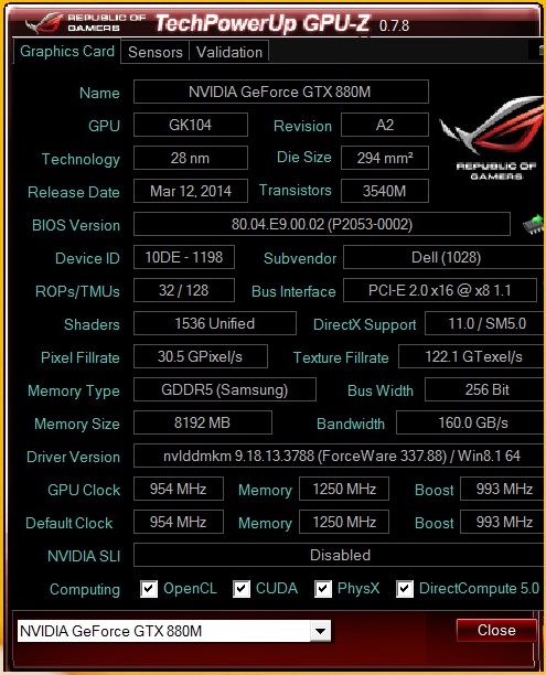

Here : [ATTACH=CONFIG]11789[/ATTACH]

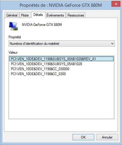

This is mine:
Seems like fairly identical IDs to me, unless the subsys part is checked.
Do I need to reinstall the nvidia driver after I flashed my gtx 880m vbios?
I didn't need to reinstall mine, it worked out of the box.
