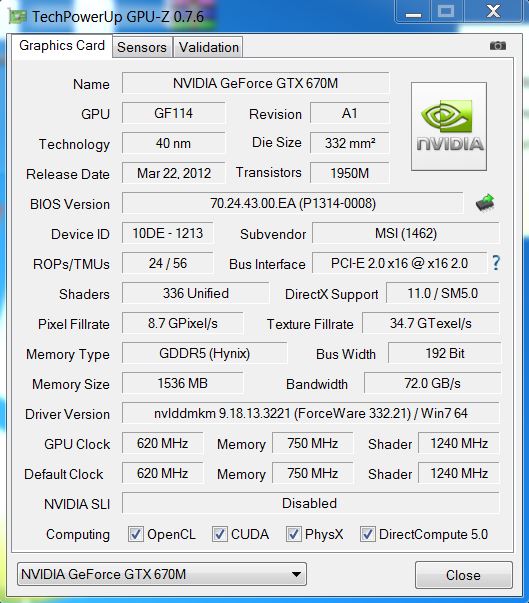

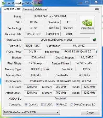

djdblaster Posted January 30, 2014 Share Posted January 30, 2014 Flashed it, fired up Crysis 3, its running great, just like previous vBios, but I still see some blue squares on walls, floors and doors. I fired up Skyrim, starting menu is great, no errors, I press new game and then I see blue squares, but wait, this time it actually started the game. I would get crash on loading screen. Now I see a couple of yellow and a lot of small blue squares. Gameplay is smooth thought. Then I press alt tab to check temps and vddc in GPU-Z When alt tabbing back, there are blue spots on the horse and clothes, few of them and those small blue and yellow squares turned into invisible, but you can still see them if you focus on them. Im running 332.21 drivers. GPU-Z reports the same info just like previous 1.5GB vBios. Temp in Skyrim was 70 C. Quote Link to comment Share on other sites More sharing options...

djdblaster Posted January 30, 2014 Share Posted January 30, 2014 The thing is that I actually got it working perfectly and the voltage was 800mV. Installed driver 327.29 I believe, don't hold me on this one and everything was smooth and no errors at all. Updated drivers and issues appeared. Reverted drivers back and issues were still there. GPU is fine. It came 100% working from AW system. Im gonna upload GPU-Z screenshot in next 30 minutes. EDIT: Here is the GPU-Z screenshot for GTX 670M. Started Crysis 3 mission and I immediately got CryEngine error, game crashed. Is there any way someone edits my vBios? I would like to try different voltages. Quote Link to comment Share on other sites More sharing options...
