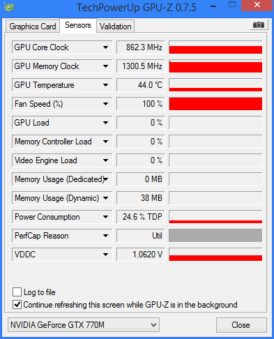

XqctaX Posted January 15, 2014 Share Posted January 15, 2014 Today i get these records NVIDIA GeForce GTX 770M video card benchmark result - Intel Core i7-4700MQ,Micro-Star International Co., Ltd. MS-1763 may i ask what your setting were during that benchmark. specifically im wondering what vore voltage you were running with. im asking since im currently doing 1140core mhz, 1.0870v memory 1000mhz. and im curious to your settings. since my just started freeezing when trying 1150mhz core clock also im wondering how high i can set voltage without damaging the card if anyone knows. (msi gtx 770m) i used to run my card at 1.1120v playing metro last light at 993mhz core and memory at 1500mhz for hours. so i assume thats okay since the card didnt break.. lol Quote Link to comment Share on other sites More sharing options...

XqctaX Posted January 15, 2014 Share Posted January 15, 2014 and which card do you run at 1.112V.??? would be interesting to know! the msi gtx 770m card thats in my GT70 2oc, i ran metro last light with 1.112v, core clock 993, and memoryclock at 1500mhz, but i never tested if it was stable in other programs or games. my clocks have been a bit unstable over 1100 tho, the gpu throttles down to almost 800 and drivers says perfcap power, when at 1,1v decreasing volt has reduced the throttle issue. im now running at 1.0620v @ 1100mhz gpu core, and memory @ 1325mhz, if i lower the volt the Gpu-driver or benchmark program will crash and if i raise the volt the GPU throttles down and GPU-Z reports "perfcap" "pwr" with core clock going down to 800-1010mhz depending on how high i set the volt. so for some reason it seems the more power i give to the card, the lower core clock it can maintain stable, witch puzzels me, becouse i thought that higher volt equals higher core clock freqency. these settings ran stable without throttling in 3DMARK's Ice storm, Cloud gate and fire strike <--- see link here ill see how it does in 3dmark 11 and will be back to post some results here later Quote Link to comment Share on other sites More sharing options...

Robbo Posted January 15, 2014 Share Posted January 15, 2014 may i ask what your setting were during that benchmark. specifically im wondering what vore voltage you were running with.im asking since im currently doing 1140core mhz, 1.0870v memory 1000mhz. and im curious to your settings. since my just started freeezing when trying 1150mhz core clock also im wondering how high i can set voltage without damaging the card if anyone knows. (msi gtx 770m) i used to run my card at 1.1120v playing metro last light at 993mhz core and memory at 1500mhz for hours. so i assume thats okay since the card didnt break.. lol One of two things can happen if you put too much voltage through your card: 1) It frys instantly, I guess if you go really nuts with the voltage or 2) Over time the silicon degrades gradually due to electron tunnelling (think that's the term). This can result in your overclocks becoming gradually more unstable, and may cause your card to cease running stably at all. 1.112V seems like a lot of voltage to me for a fairly big chip like the 770M. The 750M's run at even higher voltage than that (smaller chips), so maybe you'll be ok with that, difficult to say. But definitely use the lowest amount of voltage you can for any overclock you choose. Also, you want low temperatures as this helps protect the card from the electron tunnelling effect I talked about. I don't really know what the critical temperatures are, but some desktop 680 series cards were designed to lower their voltage (down from their 1.175V max) & clocks above 70 degC. So, maybe 70 degC should be your guideline for not using any crazy voltages above. It's a real grey area I think. - - - Updated - - - i run the gtx 770m on 1.15V. today and 1190mhz core and it is stable in battlefield 4 and 3 too!! and i got 6514 score in 3dmark11 I can tell you're getting a little GPU throttling (probaly due to power limitations) with that 3DMark score and your core clock you've set. Should be over 6700 GPU score with 1190Mhz. You might want to find the sweet spot of voltage & clock that results in zero throttling & max performance. - - - Updated - - - my clocks have been a bit unstable over 1100 tho, the gpu throttles down to almost 800 and drivers says perfcap power, when at 1,1v decreasing volt has reduced the throttle issue. im now running at 1.0620v @ 1100mhz gpu core, and memory @ 1325mhz, if i lower the volt the Gpu-driver or benchmark program will crash and if i raise the volt the GPU throttles down and GPU-Z reports "perfcap" "pwr" with core clock going down to 800-1010mhz depending on how high i set the volt. so for some reason it seems the more power i give to the card, the lower core clock it can maintain stable, witch puzzels me, becouse i thought that higher volt equals higher core clock freqency. You're just running into the power limitations when you raise the voltage too far, and you're getting instability when you lower the voltage too far for any given clocks that you're testing. There's a sweet spot to be had somewhere in there, which you can determine through trying different settings & monitoring your GPU's behaviour. Quote Link to comment Share on other sites More sharing options...

Robbo Posted January 16, 2014 Share Posted January 16, 2014 between 70-75 never higher!I think you'll be able to get away with 1.1V, but like I said I don't know if there are any hard & fast rules to this, there's a lot of grey area! I think whatever voltage you choose (& corresponding overclock), you should choose one where you get zero power throttling, that way you're putting less stress on the other MXM board components. Voltage makes so much of a difference to power consumption. If I run my card at 0.975V and 1006Mhz I get about 130W gaming system total load (not just GPU, but whole system), and if I up the voltage to 1.05V and 1124Mhz then I get nearly 160W gaming system total load. Always best to keep voltage as low as possible, the more you increase it, then the lower the efficiency in all respects. Quote Link to comment Share on other sites More sharing options...
