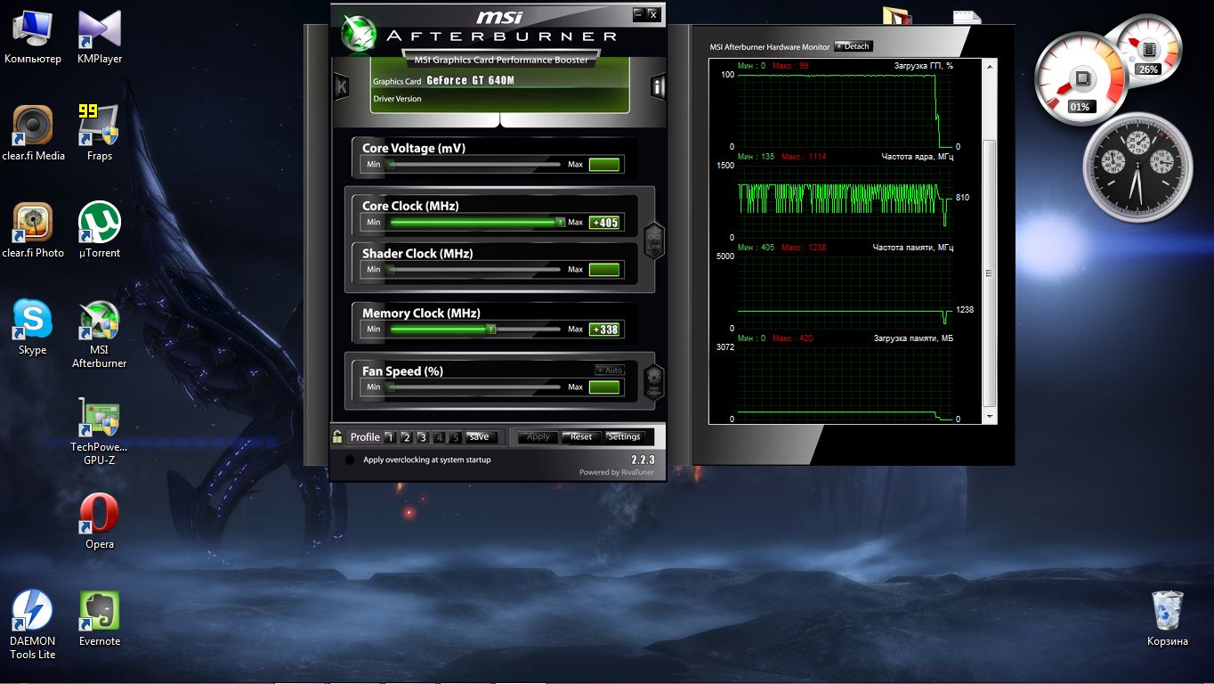

Dunich Posted August 21, 2012 Share Posted August 21, 2012 Hello everyone. I have gt 640m with modified VBIOS, and when i play (for example) Sleeping dogs core clock jumping up and down constantly. Here is the screen . Who knows, why is this happening? Quote Link to comment Share on other sites More sharing options...
