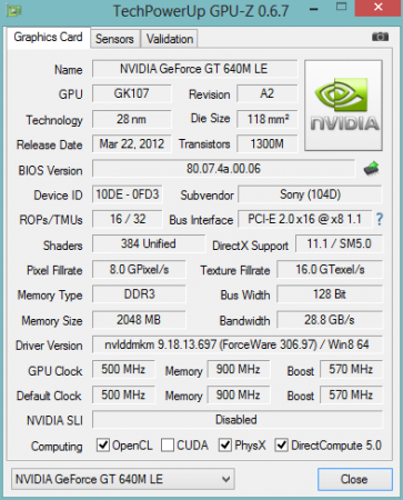

mbushnaq00 Posted February 15, 2013 Share Posted February 15, 2013 Graphic Card Details (With VBIOS): 1 Quote Link to comment Share on other sites More sharing options...

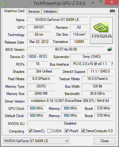

tvbppc Posted February 16, 2013 Share Posted February 16, 2013 My Graphics Card Details (2gb memory) 1 Quote Link to comment Share on other sites More sharing options...

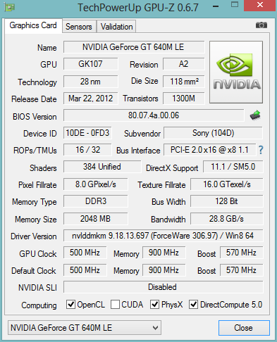

Kayten Posted February 16, 2013 Share Posted February 16, 2013 Hi guys! I'm following this thread for some time now and as I was curious about my own VBIOS version so I checked it with GPU-Z. The result is differing from the ones posted in the thread (the ones I could identify). I seem to have 80.07.4a.00.06. I do have a Sony Vaio S15 (SVS1512C5E wrongly labelled as SVS15112C5E) running BIOS version R0081C8. Is this a special case? 1 Quote Link to comment Share on other sites More sharing options...

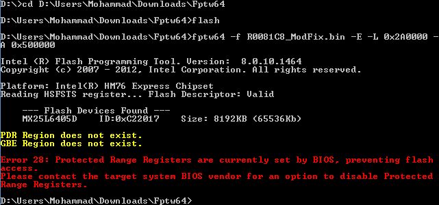

svl7 Posted February 16, 2013 Author Share Posted February 16, 2013 Okay here we go, this should work fine, or at least flash fine. >> New files and instructions, so read this! <<Instructions: - Get my tool ('BiosFixer') which will prepare your BIOS. - Download the flash tool for Win64. Run the backup.bat file to create a backup of your BIOS. - Put your backup file in the same folder as my tool, run the tool and follow the instructions. - Place the file which my tool creates ('R0081C8_ModFix.bin') in the same folder as the flash tool and run the flash.bat. - If everything's ok, reboot.As always, use at your own risk. 1 Quote Link to comment Share on other sites More sharing options...
mbushnaq00 Posted February 16, 2013 Share Posted February 16, 2013 Still not working Quote Link to comment Share on other sites More sharing options...
draig Posted February 16, 2013 Share Posted February 16, 2013 I have the same error. Quote Link to comment Share on other sites More sharing options...
svl7 Posted February 16, 2013 Author Share Posted February 16, 2013 Well shit, in this case I missed something. It's kinda hard figuring it out without a system for testing... Quote Link to comment Share on other sites More sharing options...

svl7 Posted February 22, 2013 Author Share Posted February 22, 2013 I analyzed the data I gained from the system of @draig, the whole bios region is locked down, writes to it are not possible. It will be very hard to get around this. Quote Link to comment Share on other sites More sharing options...
draig Posted February 22, 2013 Share Posted February 22, 2013 Very bad news. Do you have ideas, to around this or can't we do nothing now? Quote Link to comment Share on other sites More sharing options...
