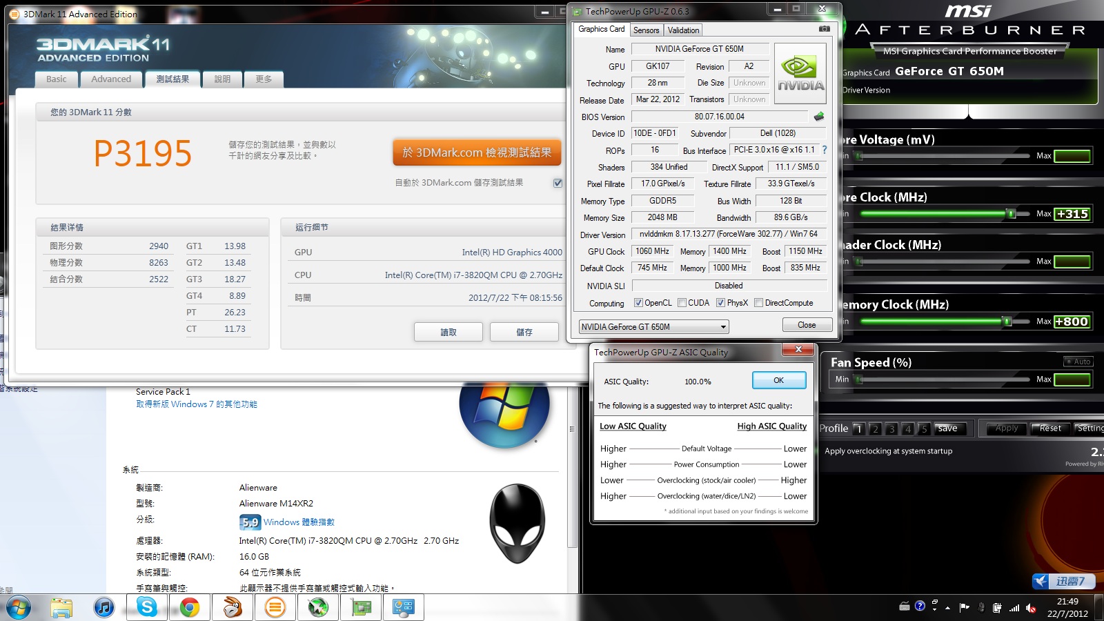

Alright Got your Point. Yes The Voltage Drops Around 65C and i am now using PState 5 Which Makes the Core and Mem run at Maxx Clocks..
Also this is My Clock Right Now!!
http://img.techpowerup.org/120804/nvidia_20120805_090905.png
