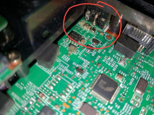

julsmbA Posted January 25, 2022 Share Posted January 25, 2022 Hi, I have a GT683DXR that reboots from nothing on AC, I think it's the 570M that is giving up. I wanted to flash the unlocked bios for it to check it changes something. Is it happening to someone? Quote Link to comment Share on other sites More sharing options...
Bios Modder Klem Posted January 25, 2022 Bios Modder Share Posted January 25, 2022 39 minutes ago, julsmbA said: Hi, I have a GT683DXR that reboots from nothing on AC, I think it's the 570M that is giving up. I wanted to flash the unlocked bios for it to check it changes something. Is it happening to someone? Hi! No, you have a problem with the laptop at the hardware level. You need to contact the workshop to repair your laptop. In your case bios won't help you. Quote Link to comment Share on other sites More sharing options...
julsmbA Posted January 25, 2022 Share Posted January 25, 2022 6 minutes ago, Klem said: Hi! No, you have a problem with the laptop at the hardware level. You need to contact the workshop to repair your laptop. In your case bios won't help you. I can try to change the GPU but at I it is too expensive, it's not worth it. Is it possible to fix the GPU (570M) by baking it? Quote Link to comment Share on other sites More sharing options...
Bios Modder Klem Posted January 25, 2022 Bios Modder Share Posted January 25, 2022 1 minute ago, julsmbA said: Is it possible to fix the GPU (570M) by baking it? I think no. You can try to remove the graphics card from the laptop and then see what happens. Quote Link to comment Share on other sites More sharing options...
julsmbA Posted January 25, 2022 Share Posted January 25, 2022 4 minutes ago, Klem said: I think no. You can try to remove the graphics card from the laptop and then see what happens. The laptop works without the graphics card? Quote Link to comment Share on other sites More sharing options...
julsmbA Posted January 26, 2022 Share Posted January 26, 2022 It's maybe possible to tell the system that the AC is not connected, like disabling 3D states. The computer is rebooting as soon as something needs the GPU but only happens on AC. Quote Link to comment Share on other sites More sharing options...
Bios Modder Klem Posted January 26, 2022 Bios Modder Share Posted January 26, 2022 10 minutes ago, julsmbA said: It's maybe possible to tell the system that the AC is not connected, like disabling 3D states. The computer is rebooting as soon as something needs the GPU but only happens on AC. No, you have a problem with the laptop at the hardware level. You need to contact the workshop to repair your laptop. In your case any modifications in bios won't help you. Quote Link to comment Share on other sites More sharing options...
julsmbA Posted January 26, 2022 Share Posted January 26, 2022 10 minutes ago, Klem said: No, you have a problem with the laptop at the hardware level. You need to contact the workshop to repair your laptop. In your case any modifications in bios won't help you. I am an IT technician and I have a workshop. The thing is i can trick windows into thinking is on battery power but with the AC plugged in. Quote Link to comment Share on other sites More sharing options...
Bios Modder Klem Posted January 26, 2022 Bios Modder Share Posted January 26, 2022 8 minutes ago, julsmbA said: The thing is i can trick windows into thinking is on battery power but with the AC plugged in. Unfortunately it won't help because the graphic card is dying. Quote Link to comment Share on other sites More sharing options...
julsmbA Posted January 26, 2022 Share Posted January 26, 2022 (edited) Yes but the thing is that the laptop only reboots when the AC is plugged. So it means that the GPU only works when the AC is plugged, I only the laptop for WEB and some Office Work. Edited January 26, 2022 by julsmbA Quote Link to comment Share on other sites More sharing options...
julsmbA Posted January 26, 2022 Share Posted January 26, 2022 So in the event viewer i have a Kernel Power 41. Quote Link to comment Share on other sites More sharing options...
julsmbA Posted January 27, 2022 Share Posted January 27, 2022 I just discovered the problem. Quote Link to comment Share on other sites More sharing options...
