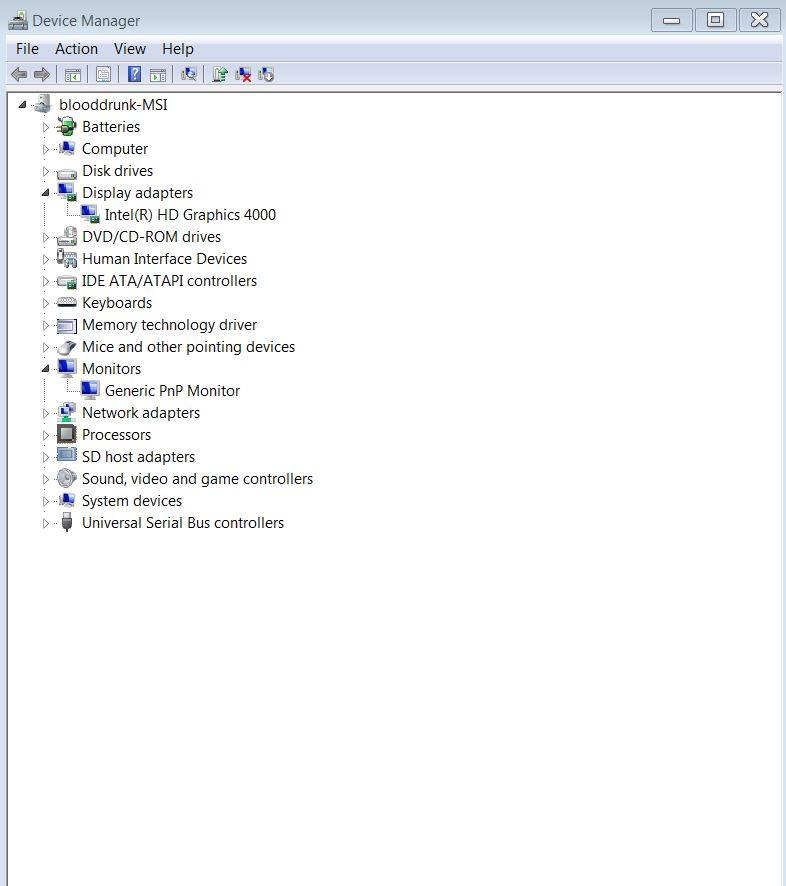

Hey guys, I'm trying to slow down my fan from spinning and like a leaf blower after removing a faulty GPU. I installed the unlocked bios from the first page here on my GT70 everything seems alright. Downloaded and installed the EC firmware from MSI's website, unplugged AC power and battery for ~20secs and it is still uncontrollable. I am missing something? I tried searching for the " set Primary Display to iGFX" in the bios setting, as mentioned in a few comments before, but couldn't find it! Hints/suggestions would be much appreciated!

Hey Bloetschkopf, thanks for the response! If I dont take my GPU out, my laptop won't turn on at all. I want to use my integrated intel graphics until I get a new GPU but the fans spin max speed all the time! Device manager doesn't give me any option to disable the nvidia gpu since its not physically there I had it's drivers uninstalled.

set Primary Display to iGFX and that's all what you need (default is SG if i good remember)
it's hidden or available in main menu under System information (all hidden options should be available in one place)

There is no such option in Xonar's unlocked bios under hidden. Is AMIBCP 4.53 compatible with MSI GT70 0NC?
I tried fanspeed and Fncontrol by dave p. nothing seems to work.
fanspeed not helps in this case - you need to disable in bios dedicated gpu
its for sure available but probably hidden , amibcp im used in gt60 3gen few times, friend use in gt70 also 3gen - then in compatible
