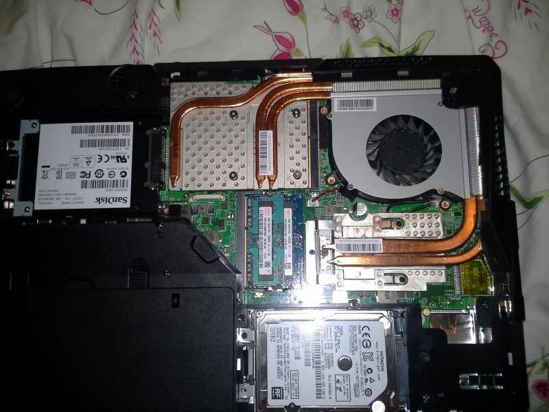

ftln Posted September 15, 2013 Share Posted September 15, 2013 Anyone with a GT60 3rd gen ivy bridge care to share a photo of there internals ? I would like to compare to my MSI X6823 which is based on the GT60 - Quote Link to comment Share on other sites More sharing options...

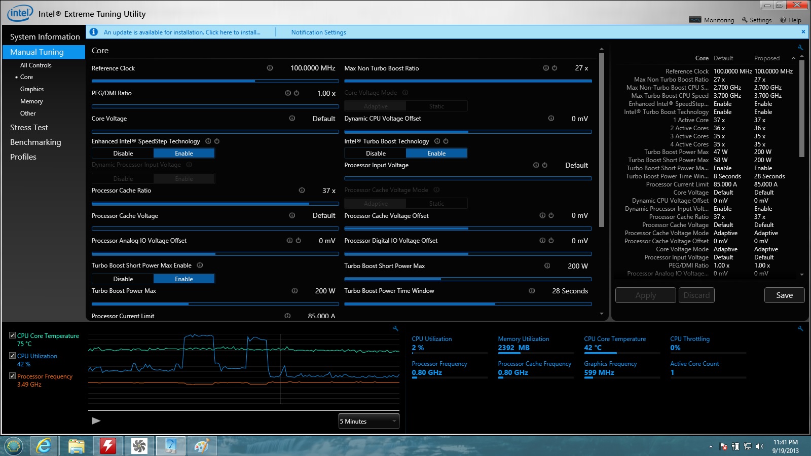

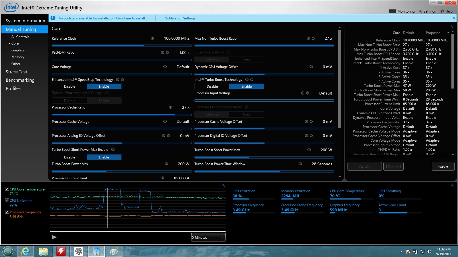

Captmario Posted September 19, 2013 Share Posted September 19, 2013 I will go have a look meanwhile if you can provide a screenshot from Intel XTU, it can atleast show that throttling is from EC/BIOS.. Throttlestop should work in almost all cases but lets see if there are any updates.Can you give me your current EC/BIOS full name? its needed. Quote Link to comment Share on other sites More sharing options...
kolias Posted September 19, 2013 Share Posted September 19, 2013 I will go have a look meanwhile if you can provide a screenshot from Intel XTU, it can atleast show that throttling is from EC/BIOS.. Throttlestop should work in almost all cases but lets see if there are any updates.Can you give me your current EC/BIOS full name? its needed. here is a picture from xtu while I was oced my 780m: As you can see on 99% im running at 3.19mhz 4 cores:(and at 45-50% on 3.49mhz)here is the 3dmark11 result:NVIDIA GeForce GTX 780M video card benchmark result - Intel Core i7-4800MQ,Micro-Star International Co., Ltd. MS-1763 Quote Link to comment Share on other sites More sharing options...

Captmario Posted September 20, 2013 Share Posted September 20, 2013 here is a picture from xtu while I was oced my 780m:[ATTACH=CONFIG]9039[/ATTACH]As you can see on 99% im running at 3.19mhz 4 cores:(and at 45-50% on 3.49mhz)[ATTACH=CONFIG]9040[/ATTACH]here is the 3dmark11 result:NVIDIA GeForce GTX 780M video card benchmark result - Intel Core i7-4800MQ,Micro-Star International Co., Ltd. MS-1763Tbh, i cant see any throttling issues in here..Unless ofcourse this algorithm changed in Haswell.. In Ivy bridge, While working on 4 cores the processor would normally run at 3.19 Ghz, on 2 cores it can max at 3.29 Ghz and at 1 core, it can max out at 3.39 Ghz..Same is the case with you, while benchmarking your CPU runs at 3.19 Ghz, using all cores, and without that it runs at 3.49 ghz on 1 core.Its normal and I cant really see throttling in there, the issue should be elsewhere, i will search to see if Haswell has this feature too. But anyways i will check EC/BIOS but to be sure if anyone else can verify this because i dont see any signs of throttling.Edit: I checked and saw this "with Turbo Boost up to 3.5 GHz (for 4 active cores), 3.6 GHz (for 2 active cores) and 3.7 GHz (for 1 active core)." so basically you are running at lower clocks for all processor states..Can you try Ticking "Clock modulation' and 'chipset modulation' to 100% too? In Throttlestop, and do try both versions.. meanwhile i posted for latest EC/BIOS, do you know your current EC/BIOS, post version numbers here Quote Link to comment Share on other sites More sharing options...
