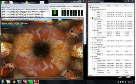

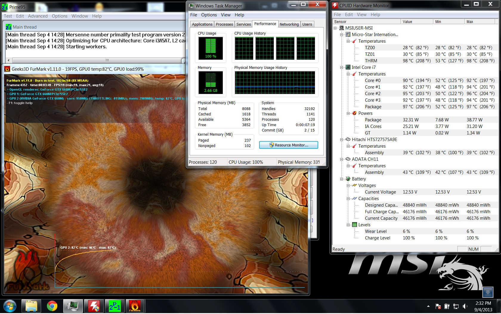

Little Mariachi Posted September 3, 2013 Share Posted September 3, 2013 I can't really answer your questions as I don't have your system but I've unlocked the BIOS for you, It's for windows 8.http://www.fildirekt.se/dl/1378270048.rar I currently have Windows 7 running. Is that BIOS still compatible? @Bugii - BTW, here's two screenshots of benchmarking my system with an Antec Cooler to Go. First is the one with the back cover and turbofan. The second is without the back cover with just normal fan. The difference in temperature without the back is 11 degrees lower for my GPU and without having to turn the fanboost on...my CPU temps, well that's another story...these screenshots were prior to me using Throttlestop to lower my multiplier to 27 for my CPU. At this multiplier, when I'm gaming the CPU temps hover around mid-80s, as opposed to mid to high 90s when using default settings. Quote Link to comment Share on other sites More sharing options...
Moderator BAKED Posted September 3, 2013 Moderator Share Posted September 3, 2013 I currently have Windows 7 running. Is that BIOS still compatible? @Bugii - BTW, here's two screenshots of benchmarking my system with an Antec Cooler to Go. First is the one with the back cover and turbofan. The second is without the back cover with just normal fan. The difference in temperature without the back is 11 degrees lower for my GPU and without having to turn the fanboost on...my CPU temps, well that's another story...these screenshots were prior to me using Throttlestop to lower my multiplier to 27 for my CPU. At this multiplier, when I'm gaming the CPU temps hover around mid-80s, as opposed to mid to high 90s when using default settings. [ATTACH=CONFIG]8813[/ATTACH] [ATTACH=CONFIG]8814[/ATTACH] NO! I'll unlock a win7 version and PM it to you. 1 Quote Link to comment Share on other sites More sharing options...

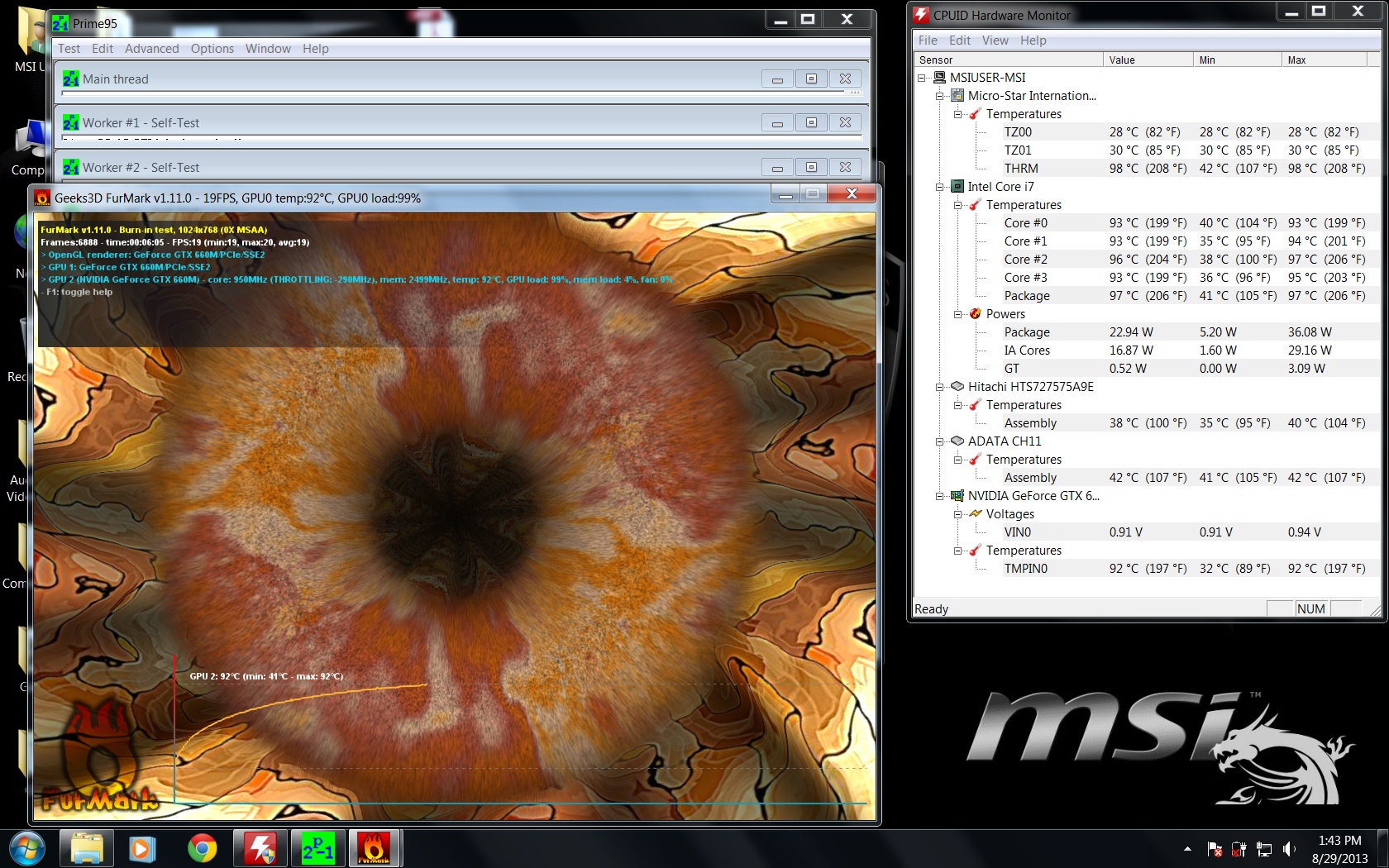

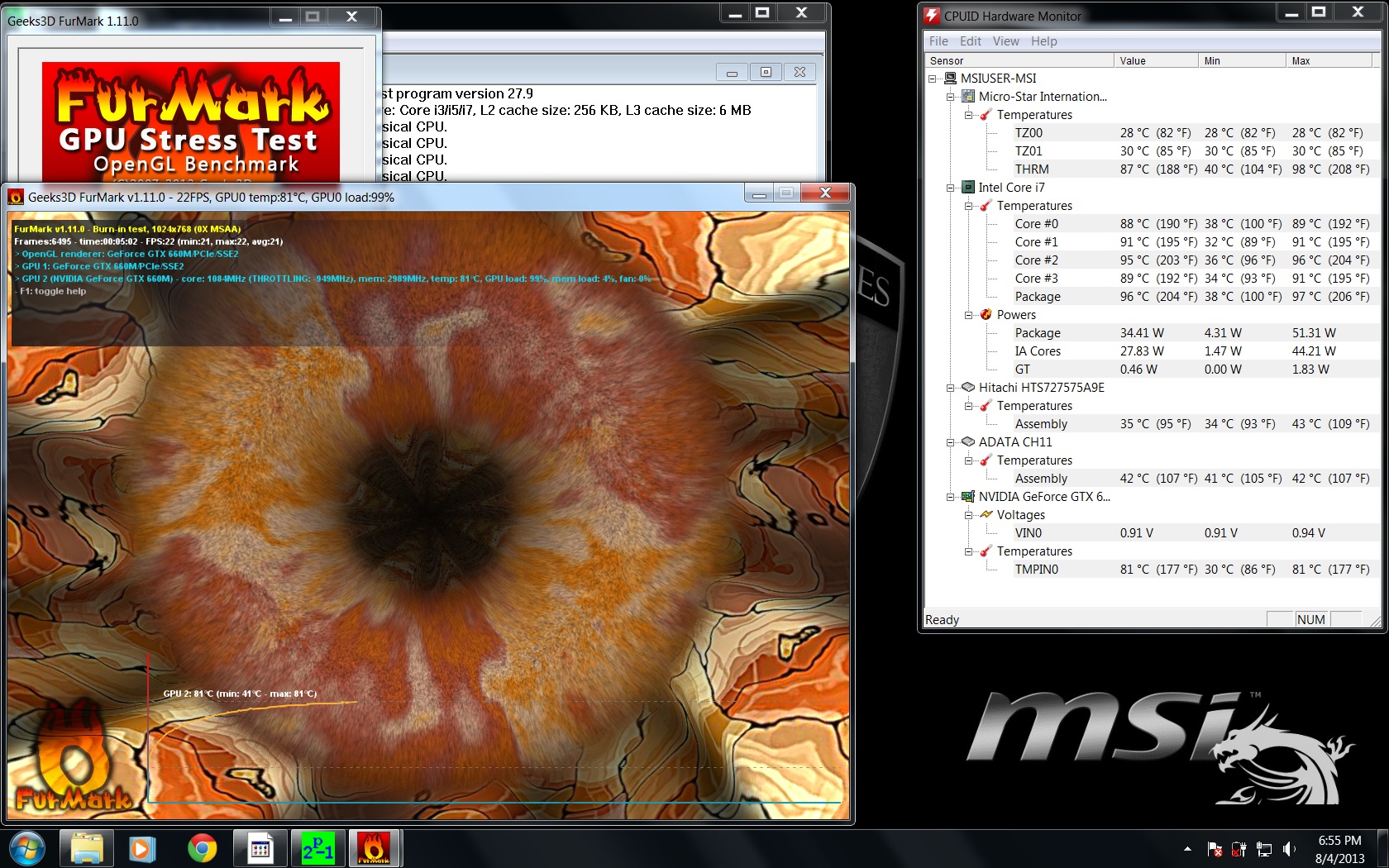

Little Mariachi Posted September 4, 2013 Share Posted September 4, 2013 NO! I'll unlock a win7 version and PM it to you. Thank you Suoah, just loaded the modified BIOS. Had no problems flashing. Unfortunately, no settings for changing the voltage for the CPU. I tried disabling the hyperthreading, since that was available, but unfortunately that didn't help with my temps. For those wondering whether disabling hyperthreading lowers temps, here's two screenshots of my laptop CPU temps with hyperthreading enabled and disabled. Used Prime95 and FurMark. Hyperthreading apparently has no effect on temps, so might as well keep it enabled. Haven't seen anybody upload actual pics of the various settings of the unlocked BIOS. I will try to upload pics later. Also not sure if the available settings are the same across the board for the different BIOSes of the GE-series. I have looked through all the settings, though I'm not familiar with the actions/purpose of each setting. Maybe after I upload the pics, someone can discuss what each setting does. Quote Link to comment Share on other sites More sharing options...

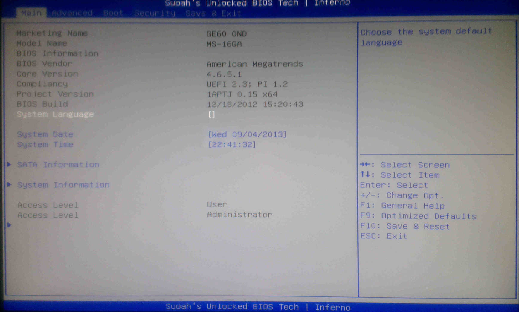

Little Mariachi Posted September 5, 2013 Share Posted September 5, 2013 Ok, so I've finally finished editing pictures as much as I can for the modified BIOS. This is the modified BIOS of my model, GE60-0ND, care of Suoah. Just want to apologize in advance if my pics seem a little skewed, and the amateur cut/paste editing. Took over 60 pics, and spent a day and a half using GIMP and MS Paint to edit the pics (I know...you can feel free to laugh at my poor skills of graphics editing). Arranged the pics in a type of hierarchy order. For example, a pic with the name '10_BIOS_AdvancedTab_PCISubsysSetArrow' means that the picture is showing the features of the page when you select the PCI Subsystem Settings arrow under the Advanced Tab. Hope I didn't make this too confusing. Also, again due to my incompetence of not knowing how to edit pictures correctly, I just put all 41 pictures in a zip file because there are 6 pictures that were a lot bigger than the 1920x1080 resolution limit. Seriously I tried, and just about spent 3 hours reading on GIMP's online manual to no avail. Unfortunately this is cutting into my study time. Secondly, I have a terrible bandwidth connection here in the Philippines; it took me approximately 5 minutes to upload a picture file size of 100kb, so I said screw it after repeatedly getting logged off the website because I'm waiting for the upload window to complete its upload. Maybe someone else with a better bandwidth can upload the pictures here for me. BIOS Pics.zip I don't know what all the settings/features do. I basically flashed this BIOS in hopes of having the ability to change the voltage for my CPU, but I didn't see one. Maybe there is a feature there in the BIOS that I don't realize that can help lower my CPU voltage or temps. So if anyone see a feature that I should try, just let me know. - - - Updated - - - No need to I have the one for Windows 7 for a while:) But I will PM you LOLEDIT: Oh, you have already done. Just noticed... Looked at pics of the links you sent me, and it looks different from the one Suoah sent me. Just wondering if you know if the BIOS you sent has the ability to modify CPU voltage? Quote Link to comment Share on other sites More sharing options...
