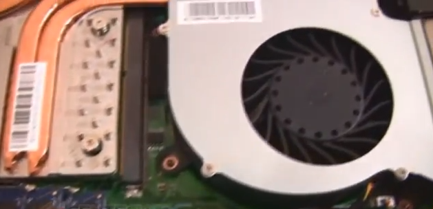

I flashed my GX60 APU , but the laptop is dead . :(
This laptop dont have the reset cable of cmos , only fan cable.
What i can do ? :(
Look at the pictures on the 2nd post for where the CMOS cable is. There is one. This is one of the first reports of a straight brick that I've heard of.

Please help me for find this location :s , in my gx60 , only have the fan cable :(
