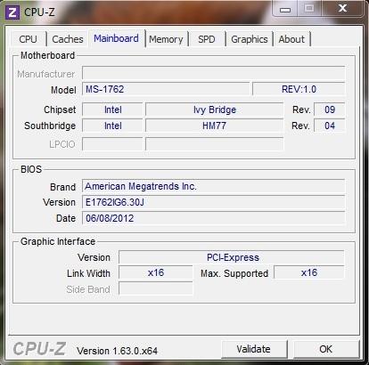

Ok, i have succesfully installed this bios,
thanks for the good stuff Xonar,
but i have some question
yes this will be poor one
im not stupid about computer :\, but not this stuff, i never tried it : (
i wonder how can i change the fan setting, and graphics.
and yes i saw related options in the bios but i couldnt understand it : | (i do understand what it means, but..)
heres what im trying to do, i wanna disable my hd4000,(found out its not possible) and use only gtx 675m ,after that im gonna downclock the cpu and gpu
so i can reduce the temp, and fan speed(noise)
i will keep trying till i got answers, but i thought i could get some wise advice!
also i have gt60 with ivy bridge, thought you might interest
