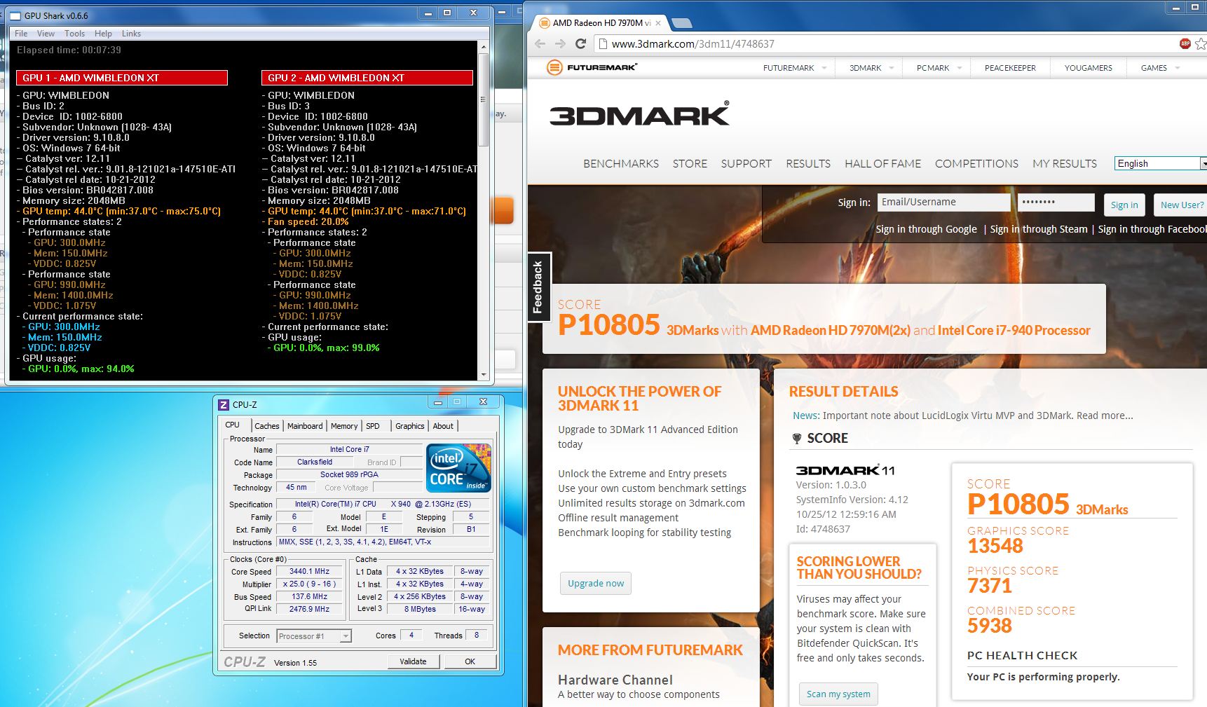

3DMark11 with the 12.11 drivers
[ATTACH=CONFIG]5281[/ATTACH]
Epic StamatisX nice clocks but better yet nice score for those clocks. Almost little difference from 680m to 7970m now in benches.
