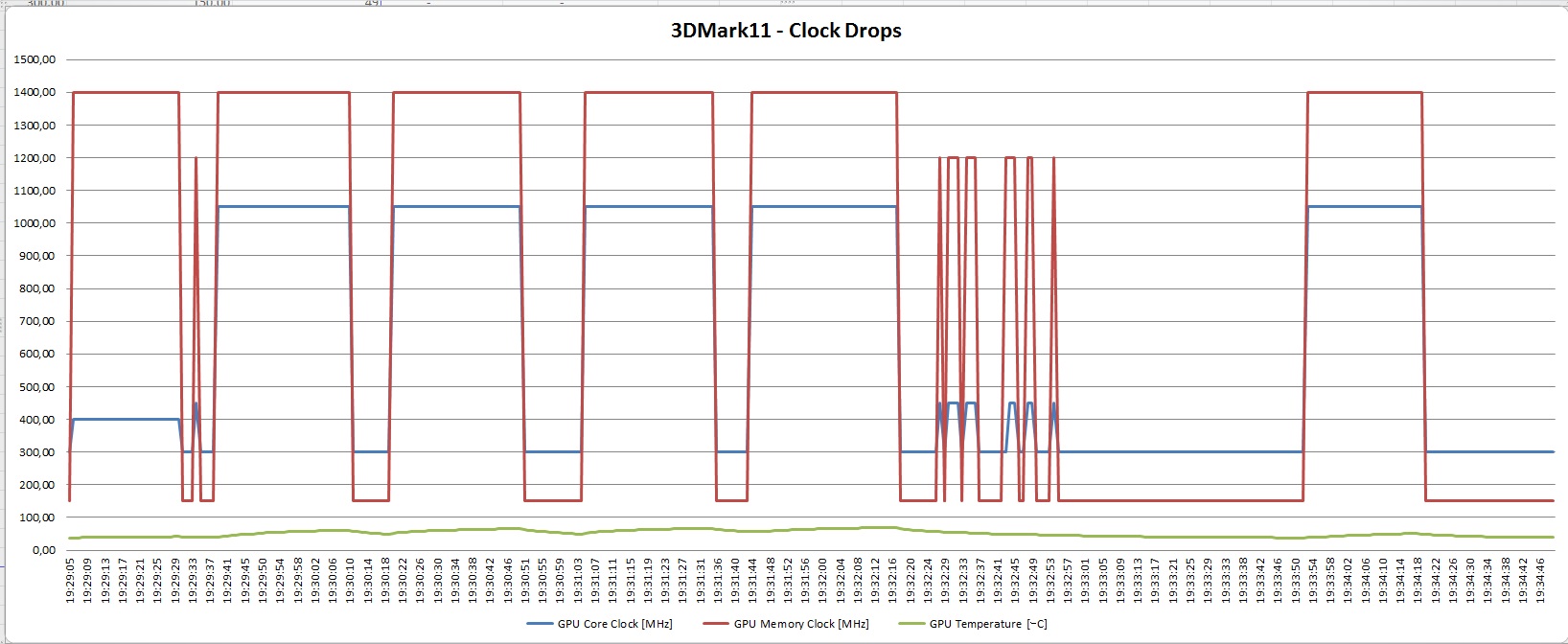

Quick benchmarks... I don't OC, but my biggest concern was the amount of heat generated. These 7970s run so much cooler than my CrossFire 6990 set up. I know people say it all the time, but the R2 is definitely a great laptop considering the upgrade avenues for this thing are not exhausted yet.
Overall, I'm a happy owner again.

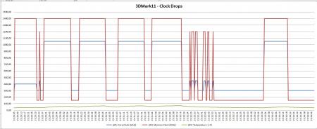

Are those drops in the clock speed from the tests changing or throttling? And yeah the R2 was a fantastic machine, I miss the rgb led.
Sent from my GT-N7000
The drops in the clocks reflect the phases of the test being performed. I'm going to get a Kill-A-Watt on Tuesday and verify my power draw and if I'm close to the PSU ceiling, explore/invest the 480W dual in-line power supply. I need to reformat my machine and rerun the test, I've got too much stuff running that's accumulated over the years.

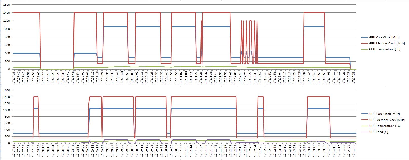

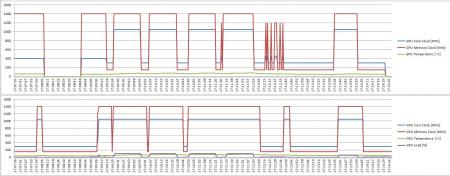

Yesterday with the following clocks @1.15V [ATTACH=CONFIG]4593[/ATTACH]
I run 3DMark11 but the score was lower than that with 1000/[email protected] This is the GPU-Z log file:

No wonder why the score dropped...
