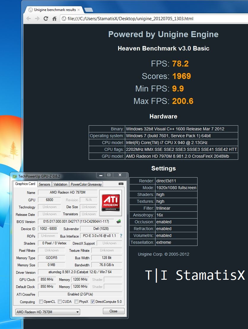

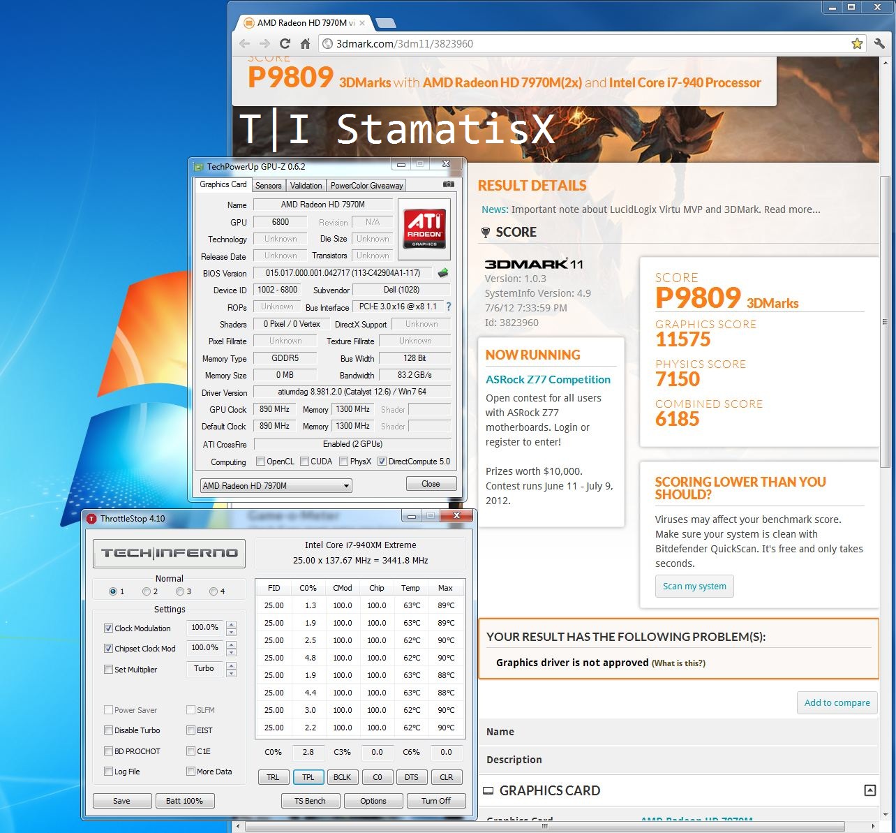

[M17x R2] with AMD 7970M CrossfireX

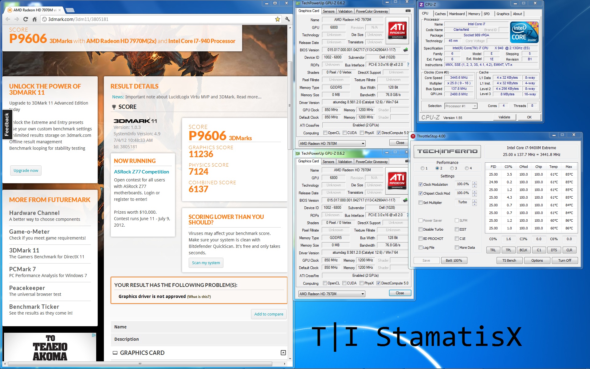

I received early in the morning a couple of 7970Ms and a cfx cable from MXM Upgrade Home Page
3DMark11
Unigine
If you are upgrading from the 5870Ms, the screws are a bit bigger in diameter and they won't fit the backplate of the 7970M (probably a clevo card? I will find out soon). Other issues I encounter is that both display and HDMI port don't work so I attach my Dell 2410 with a VGA cable... Temps are fine and I am idling at 56-58 C with the external monitor attached (which brings the clocks up to 300/1200 @0,825V) so not that bad.

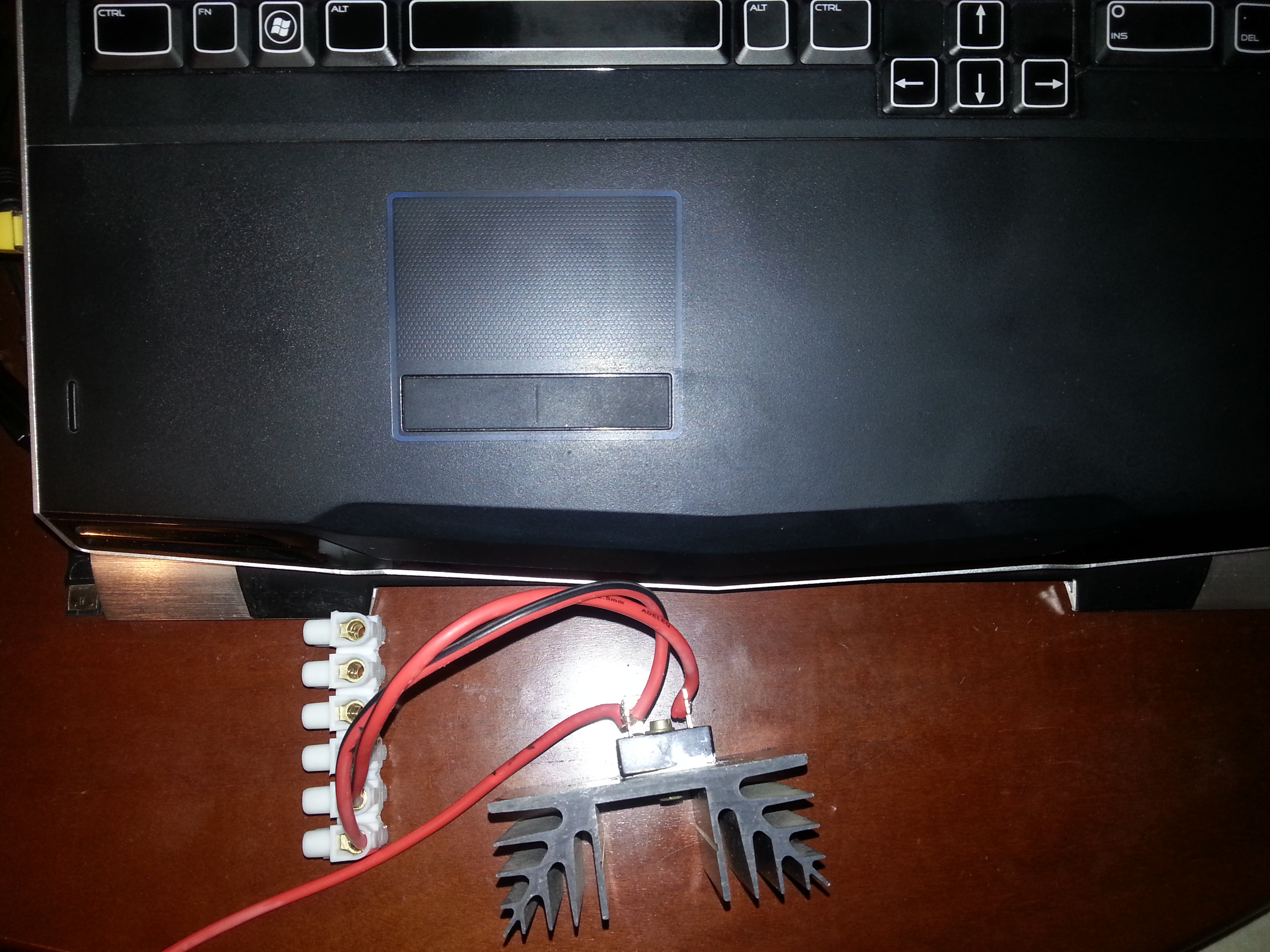

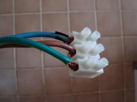

Definitely interested, I told my father to send me a diode bridge that can handle at least 20A so I can connect the 2 PSUs in parallel.

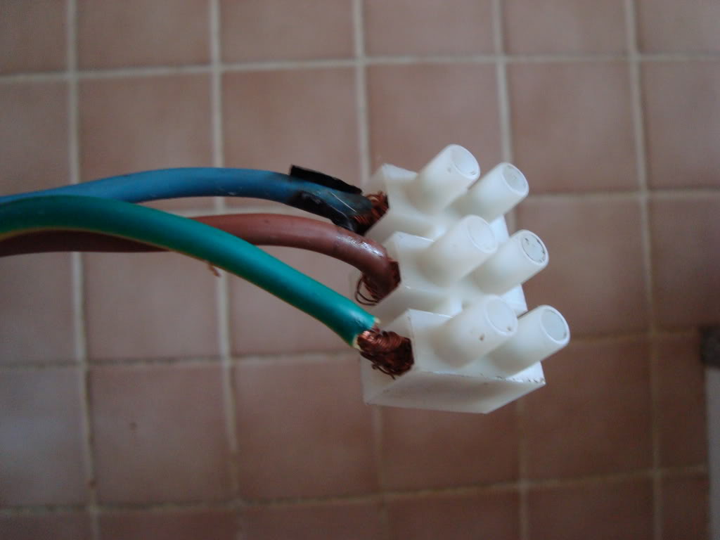

I will probably need an something like this
Better use solder, it's neater and makes better contact.
@svl7:
we all know you are obsessed with soldering.
Btw my free60 doesn't glitch anymore. I suspect cold solder joints, damn lead free solder! - Can you fix it ? ;)
@all:
I'd prefer the screw terminal, as it is mechanically stable. Just don't forget to use cable-end sleeves.
Just ordered the second PSU from Dell. It will be here on Tuesday. Now I will have to wait for my father to send me the diode bridge.

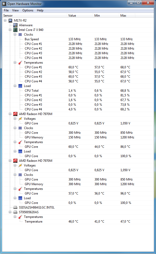

Also an update concerning temperatures
Metro 2033, everything maxed out, primary GPU was hitting 96C and the secondary 86C. Really hot...
Undervolting to 0.975V help the temperatures a lot, 9C difference... but I experience throttling during gameplay, the FPS drop and the load on both GPUs drops to 64%. (It's not due to temperatures since the secondary GPU is 5C lower)

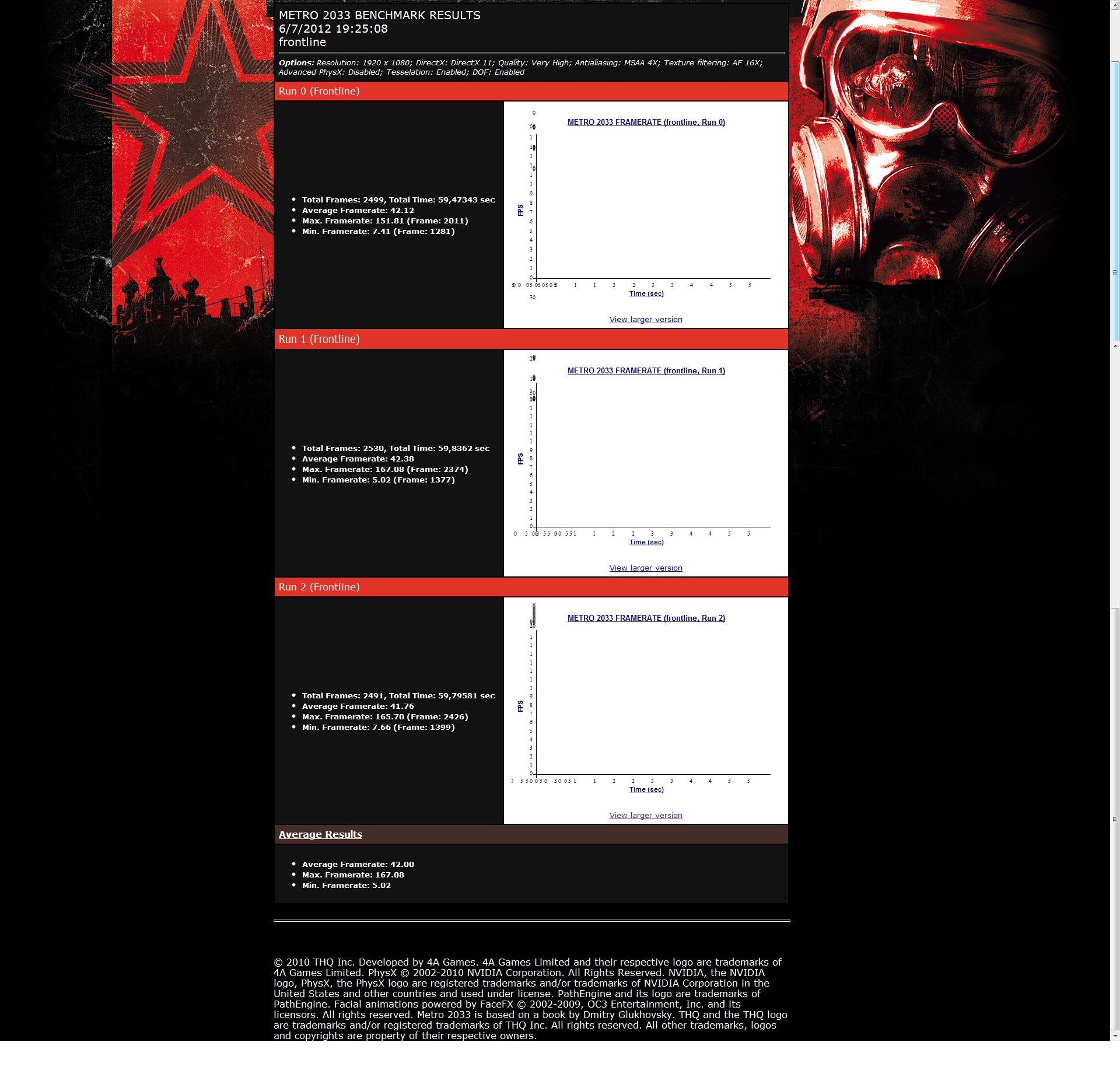

Anyways... I run a Metro 2033 benchmark real quick
The problem right now is the PSU... 240W are simply not enough when playing games like Metro 2033 maxed out in CFX... especially when you have a XM CPU OCed... You can always undervolt @0.975V but then you will experience throttling.. I will be able to answer your question in a couple of days, when I will have an extra PSU to run in parallel, to keep my CPU overclocked and run the GPUs at stock clocks. Then I will tell you what the system can do.
