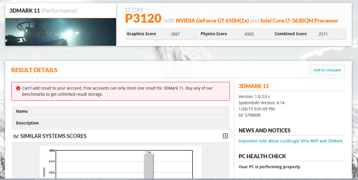

I'm using MSI afterburner as well, and I do see a difference, not in the memory clock but in the core clock, I get the option of +405 and +1000, but I don't see voltage going over.925, and any setting over +200 on the GPU core clock causes my graphics driver to fail when I launch either MSI kombustor or 3DMARK11. Not sure if that's just because of the lack of extra voltage or not, I can go the full 1000 on the memory clock and nothing goes wrong, but I see people on here posting 350-950 and they run no problem. Is it just that I have to change the GPU voltage somewhere else myself?
I guess I should also state that I'm using m14x R2 with i7 3630QM processor, 12GB RAM, I had it OC'd with all turbo settings enable, 99w max turbo power, 99w max short term power, 106mhz core clock (I changed this back to 100 because I saw that some people got better results with the OC off on processor due to power), but I did leave the turbo settings on. I'm getting around P3120 on 3dmark11 with 200-950 in MSI afterburner, but just curious if I can go the 350-950 or more like other people post if I can somehow adjust the voltage to GPU. I was using intel xtreme tuning utility for the processor adjustments. Also I have no real temp problems, I'm seeing around 80 max on processor and the GPU is only going to about mid60s any time I've checked

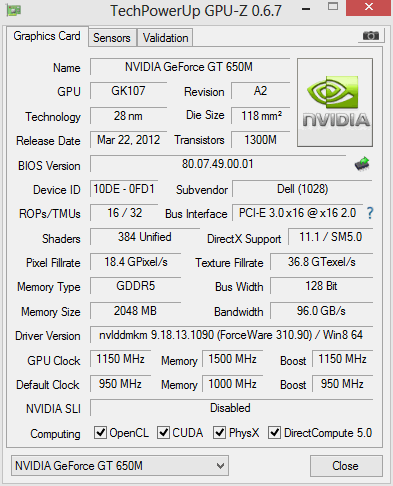

post-9097-14494994226862_thumb.png I'm getting no difference between regular clock and boost clock with this new bios, and it's not reaching 100% usage at all. MSI kombustor shows throttling of 745mhz, not sure if it's throttling or not with 3dmark11 but just curious if these pics and log file can help you to tell me what's going on? I don't know if the voltage change is something I need to do myself or something that's already programmed by the new vbios. It's definitely performing better than without the unlocked bios, just not sure if there's more I'm supposed to do or not. Any suggestions?
GPU-Z Sensor Log.txt
I removed the boosting in this version, I reckoned that it's easier to overclock without boost. With boost you'll never really know how high the GPU will go, and when it might get unstable. With this version you just have the 3d clock, even though the card might clock down if the load isn't 100%. The log shows that whenever there's high load on your card, it clocks perfectly well up to 1150MHz, so everything's fine, and the 3dM11 looks good.
