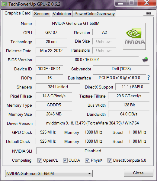

svl7 Posted July 12, 2012 Author Share Posted July 12, 2012 Can anyone who uses the latest version please post a GPU-Z screenshot or link to it? I'm going to create a proper thread for the working versions and it would be cool to have some pics Thanks! Quote Link to comment Share on other sites More sharing options...
deadbydawn Posted July 12, 2012 Share Posted July 12, 2012 i can do it tomorrow, as i got mine at work. will get back to you tomorrow =) Quote Link to comment Share on other sites More sharing options...
thanats007 Posted July 12, 2012 Share Posted July 12, 2012 Can anyone who uses the latest version please post a GPU-Z screenshot or link to it? I'm going to create a proper thread for the working versions and it would be cool to have some pics Thanks! Hm i thought i was using the latest GPU-Z version 0.6.2. Which version do you like us to make screenshots of? Quote Link to comment Share on other sites More sharing options...
svl7 Posted July 12, 2012 Author Share Posted July 12, 2012 Ah yeah, call me stupid but I'd like to see the whole window, just for aesthetics Ah, and no need to black out the device ID... that's the same for all 650m Quote Link to comment Share on other sites More sharing options...

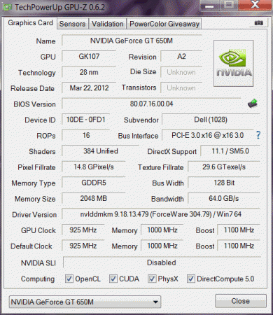

thanats007 Posted July 12, 2012 Share Posted July 12, 2012 Ah yeah, call me stupid but I'd like to see the whole window, just for aesthetics Ah, and no need to black out the device ID... that's the same for all 650m Here sir ! ^^ Not oced only the vbios mod: M14x_R2_925base_1100boost_1350mem. 2 Quote Link to comment Share on other sites More sharing options...
svl7 Posted July 12, 2012 Author Share Posted July 12, 2012 Awesome! Thank you. Oh, btw... seems the memory is unchanged... I have to take a look at this.Edit: Ah, seems I forgot this... will fix it. What's a good and stable memory clock value? Quote Link to comment Share on other sites More sharing options...

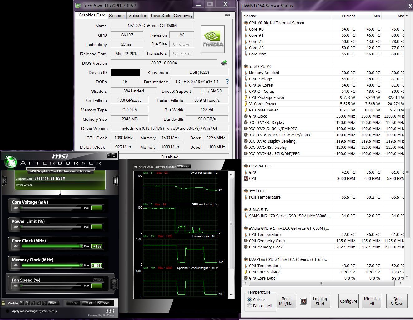

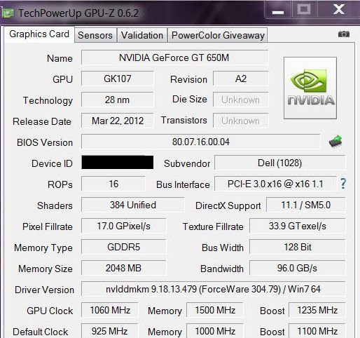

thanats007 Posted July 12, 2012 Share Posted July 12, 2012 What do you use for gaming? MSI Afterburner This was stable -> Quote Link to comment Share on other sites More sharing options...
svl7 Posted July 12, 2012 Author Share Posted July 12, 2012 Wow, 1500MHz... quite an overclock. Alright. Quote Link to comment Share on other sites More sharing options...
