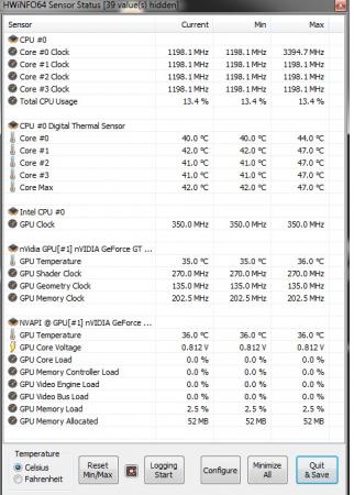

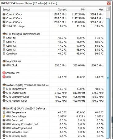

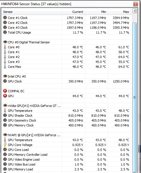

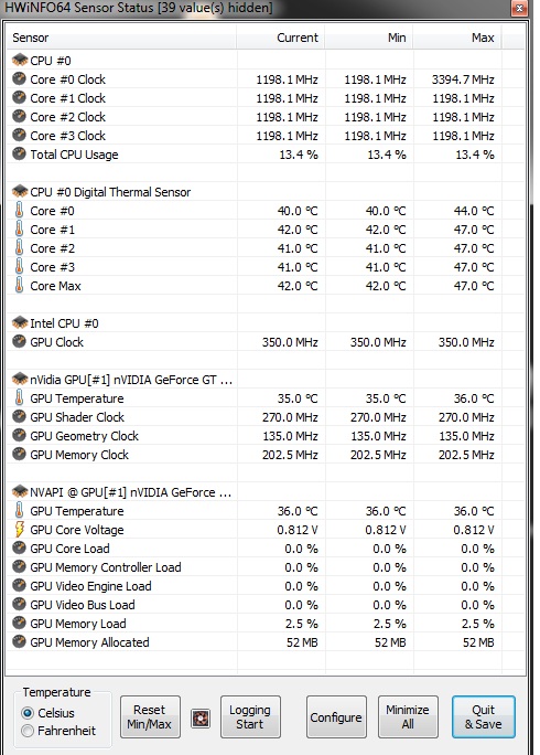

what i find strange, is, that if i observe HWINFO a while, the gpu core voltage is set at 0.925 for most of the time, even if i'm not doing anything at all. shouldn't it drop to 0.812 more often? specially while idle?
what i noticed is, that when i open gpu-z (with hwinfo opened as well) and monitor the gpu temp etc. the clocks will drop to the minimum. the moment i close gpu-z and watch in hwinfo what's happening, the clock on the card will raise again and will stay up there.

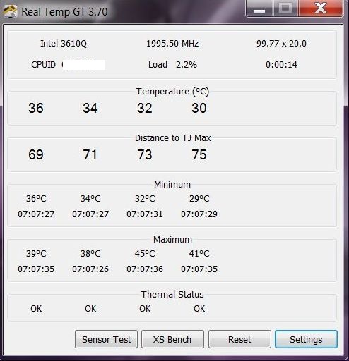

That looks sick ^^. Im going to test it as soon as i can and post my results. Since ive repasted my M14x R2 the temps are very nice and it should be no problem at all to squeeze the last bit out of the GPU now.
These are my Idle Temps after 3 days cure time of MX-4 and at first windows start at this day still using your first vbios mod without a problem:
