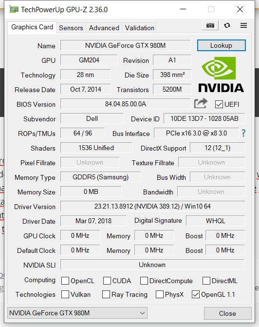

Leomm Posted January 2, 2021 Share Posted January 2, 2021 (edited) Hi guys. I've bought a GTX 980m to upgrade from my GTX 765m SLI configuration. I had some problems with the upgrade, since it not supported natively my system, beacuse it my bios was locked. I've flashed the A12 unlocked bios, that gave me the possibility to change from Peg to SG and Igfx. I've selected SG and can boot in windows 10 and I am in UEFI with legacy disabled. Widows 10 have installed a driver, but when I reboot my laptop, it freezes in windows start... I`ve tried some drivers but the same thing happens... In Gpuz, my Device ID is 10DE 13D7 - 102805AB, Suvendor Dell. Previous Bios was 84.04.22.00.12 and now I'm on 84.04.85.00.0A, trying to flash Dell vbios that found on other forum, but it didn't worked.. What I'm missing... Do I have to change to a modified vbios and modified nvidia drivers? Thx in avance.. Edited January 2, 2021 by Leomm picture Quote Link to comment Share on other sites More sharing options...

Leomm Posted January 3, 2021 Author Share Posted January 3, 2021 I've searched the web and found a topic in other forum about this problem that the clocks stay stucked at 405mhz. In Optimus mode (SG mode graphics in bios) the clocks of both gpu and memory stay ate low rate (405mhz). When I enter bios, switch to PGE mode (discrete graphics only), and boot into windos 10, I load GPUz and star the Pci render test. Then I can see the gpu and memory clocks go up. But one problem. Monitoring the frequencies during the render test, when board power and gpu power go above 70% (75% to 77%) the temperature of the card is at 74ºC, the laptop freezes... Why is that?? Faulty gpu, maybe? I don't believe its drivers, beacuse I've tested abot 5 differente drivers, newst one, modded ones, old ones, and he results are the same.... Anybody have some knowledge on this? Thx in advace.. Quote Link to comment Share on other sites More sharing options...
