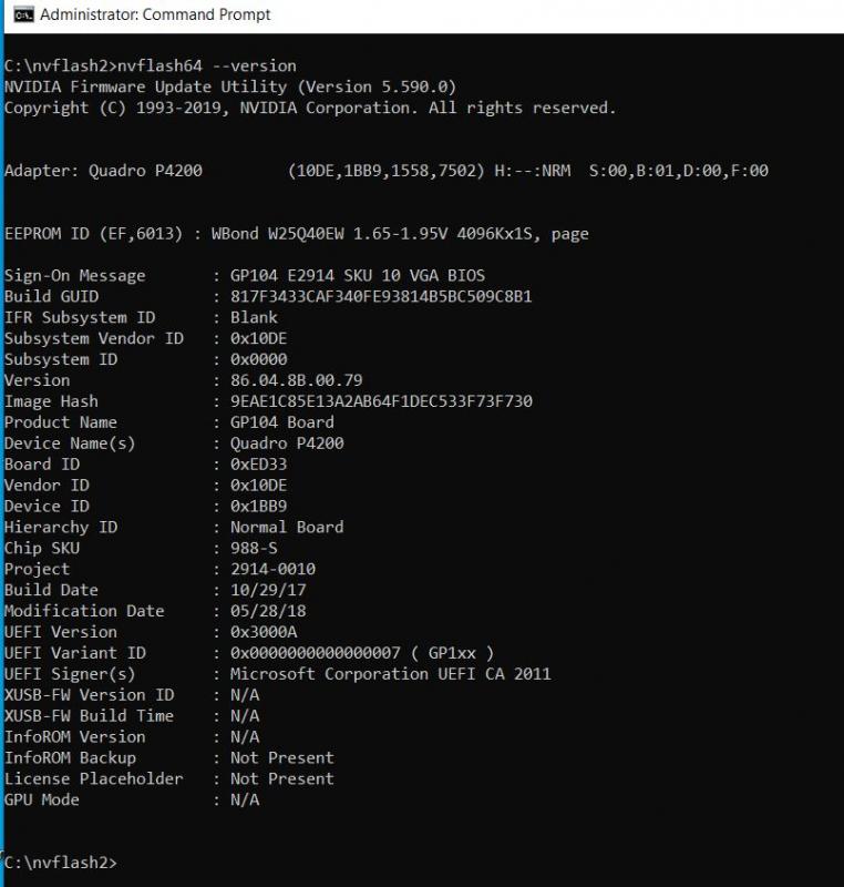

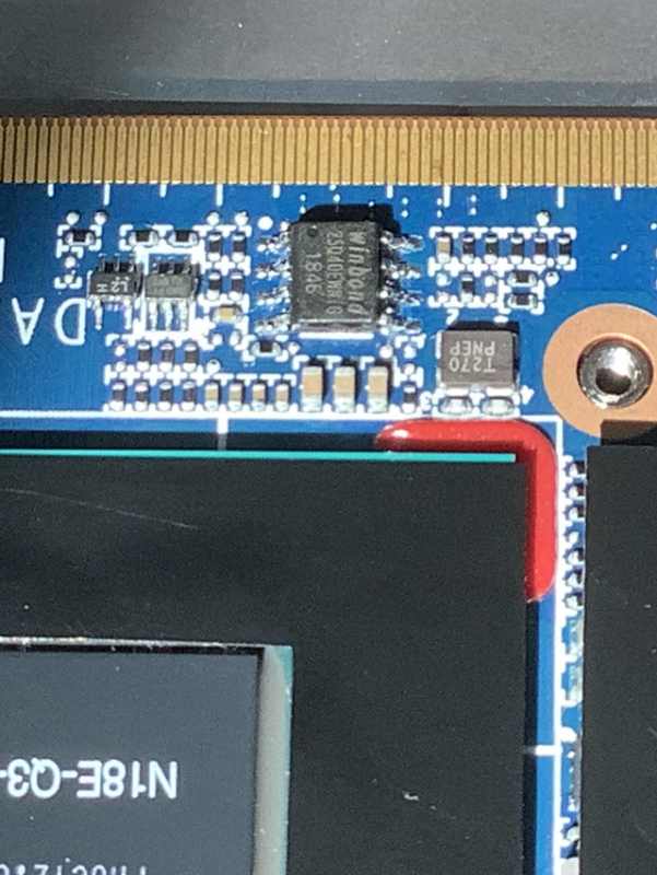

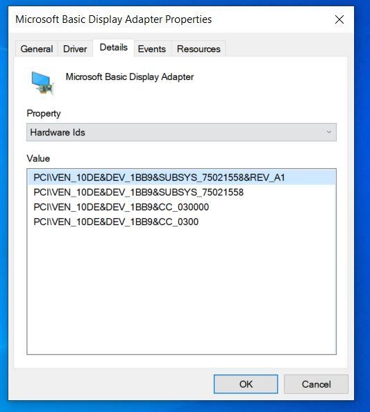

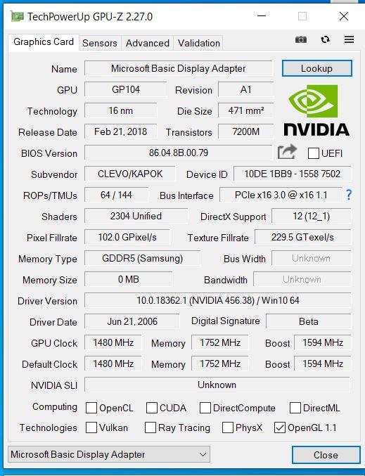

Binarious Posted October 5, 2020 Author Share Posted October 5, 2020 (edited) I bought an eeprom that was advertised as being programmed to work with a P4200 in a Clevo computer. I soldered it on and installed the card in my P750DM-g. The screen came on, and it seemed to be recognized by my system, and HWinfo even saw it as a P4200. When I installed the driver, the screen went black for 5-7 minutes then came back on all scrambled. I did a system restore then went for it again with a different template using NVCleanstall 1.7 and using my hardware info from device manager, but the same thing happened again. I would appreciate some help with this. If someone has a known good vBIOS, that might be helpful here, I'm not sure what to try next. Edited October 5, 2020 by Binarious Quote Link to comment Share on other sites More sharing options...

DAMIN Posted June 3, 2022 Share Posted June 3, 2022 do you need a .inf mod ? Quote Link to comment Share on other sites More sharing options...
