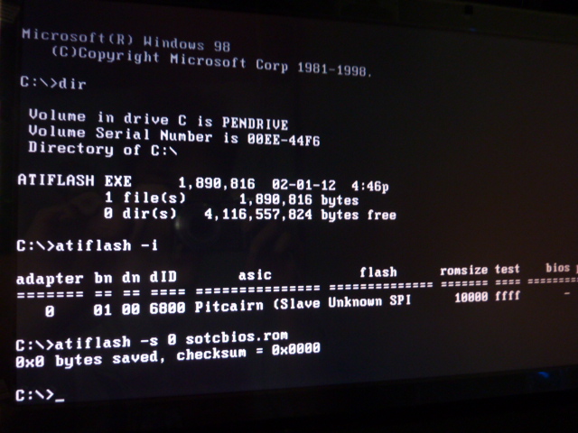

I know, atiflash doesn't seem to work in the current Clevo systems, else I would have posted modified versions for the Clevo card as well.
I think it's not a card issue, but an issue with the Clevo system. I have a copy of the Clevo vbios, but unfortunately you can't flash it... Maybe try contacting your seller and ask them what's up with that. There must be a way to flash the vbios...
