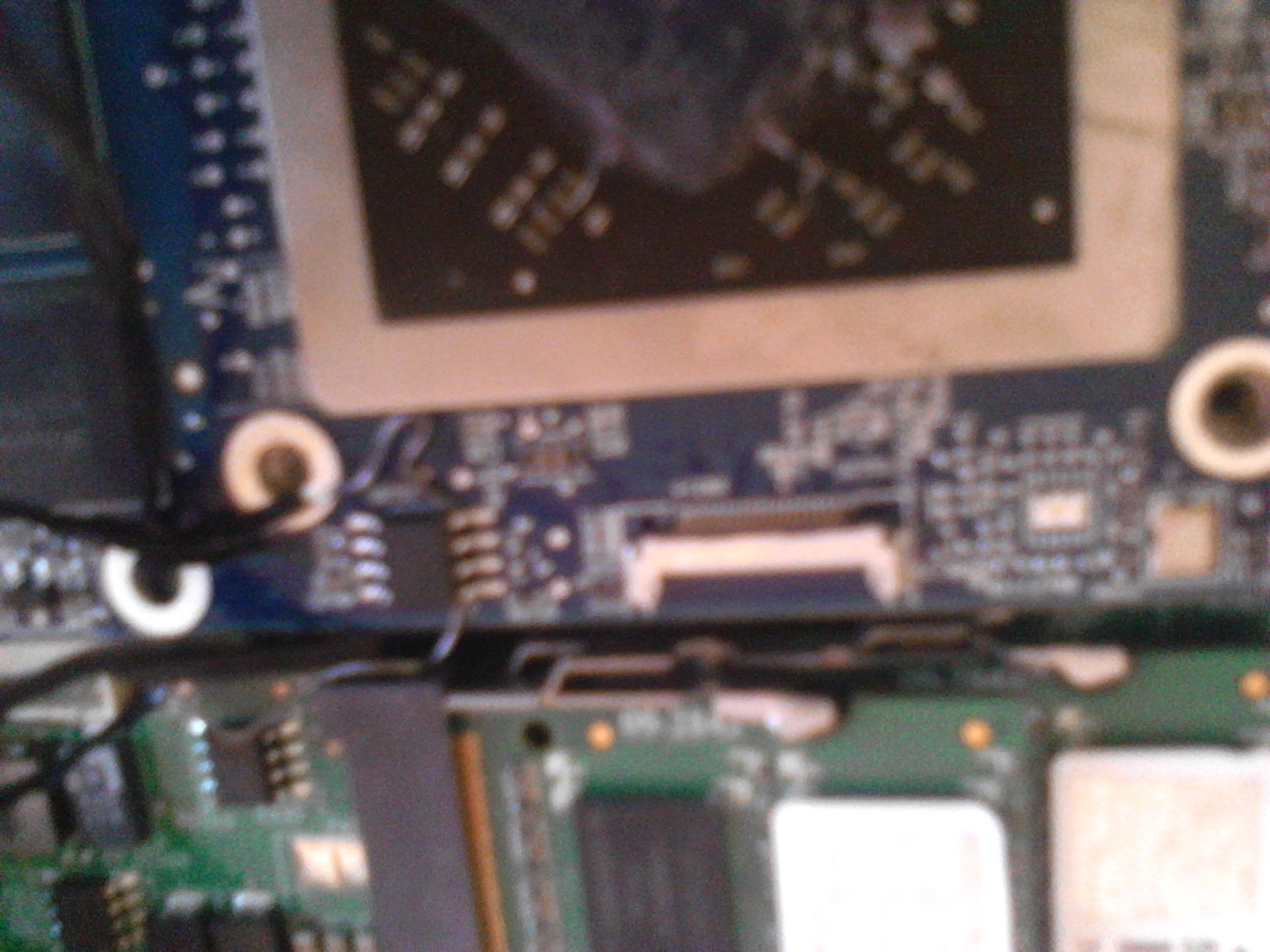

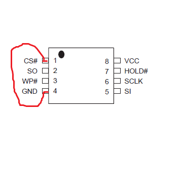

James Michael Acierto Posted December 14, 2013 Share Posted December 14, 2013 im not quite sure if this will help you guys but on a gt683 (video card died with bios set to uefi) where a 7970m(says .....015.022 on a sticker on card and rev A00 on esd bag) wont post got it to work by bridging the cs pin and gnd pin on the bios chip of the card turning the laptop on and removing the bridge before flashing (used an autoexec bat file with 015.017 vbios) P.S i think this will also work for debricking desktop amd cards (since it works for a 7970m and i debricked a gt220 that got flashed with a gt240 rom this way) 1 Quote Link to comment Share on other sites More sharing options...
landsome Posted December 14, 2013 Share Posted December 14, 2013 wow! if this works in general, it will be a major finding! I'll try it when I have the time and mood to remove the 7970M and put it in the MSI. I'll report back here, though probably not before early next yearthanks! Quote Link to comment Share on other sites More sharing options...
James Michael Acierto Posted December 14, 2013 Share Posted December 14, 2013 I think you could do it in the dell unless the vga card is not easily accessible or is broken ? Quote Link to comment Share on other sites More sharing options...
landsome Posted December 14, 2013 Share Posted December 14, 2013 I think you could do it in the dell unless the vga card is not easily accessible or is broken ?Perhaps... In fact, the more I think about it - isn't it possible that what you did by shorting the two pins was bypassing the 7970M and booting with the on-die VGA, then - by removing the wires - making the 7970M visible to the bios, then flashing it?Did your screen work when you first booted?If so, I can only try it on the Dell, because the old MSI does not have a CPU with video (it's a Clarksfield). Quote Link to comment Share on other sites More sharing options...
James Michael Acierto Posted December 14, 2013 Share Posted December 14, 2013 its still a blindflash ,yeah prevents the card from initializing and freezing boot in the process ,the screen after it was flashed (bat file was set to reboot after flashing so I get a 98 shutdown screen)The card first boot was a dud (i was getting worried that it may be a dud (or the laptop has a dead pcie slot )or i killed it somehow since i don't have any access to an aw system to test it with ) Quote Link to comment Share on other sites More sharing options...
landsome Posted December 14, 2013 Share Posted December 14, 2013 But essentially the card WAS working, only problem was it was not working with the MSI uefi ROM option, right? Quote Link to comment Share on other sites More sharing options...
James Michael Acierto Posted December 14, 2013 Share Posted December 14, 2013 But essentially the card WAS working, only problem was it was not working with the MSI uefi ROM option, right?Yeah but it would not post with the card's original vbios so it actually gave symptoms of a doa/brick cardit should technically have work otb if the bios is set to legacyI was thinking it could work for you since it allowed me to debrick a gt220 and it worked with a mobile 7970 (that wont post) Quote Link to comment Share on other sites More sharing options...
