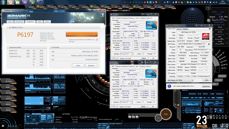

M15X Strikes again! Nice bench Jahnsinn looks like the performance drivers have better synthetic bench scores. Good clocks how cool they running on your new liquid setup? I found mine switch to a clock intermediate and ive watched it via OSD. Its between 2D and 3D clocks. .8v 150/300 .9v 450/1200 1.05v 850/1200. So for 2d i had cool and efficient performance changing 150/300 to 450/1200 @ .9v. When I've tried 3d on 2d it didn't run right for me, I noticed it not running full 3d clocks when it should.
Nice clocks though 950/1400 is great. 1.1v is near the max ive seen benefit. 1.125 can help at 1040-1125 core but nothing is stable there. In dirt 3 1.1v 1040/1625 i was able to race at on ultra 1080p max CCC quality could add. But BF3 and Crysis 2 are another story as they are pretty stressful.
Have you tried vantage. Seems like 12.11 driver is really boosting 7000 series.
Paranoid Galaxy S3 on Tapatalk 2
couldn't bench much so far. quite busy at the moment, loads of work, don't know where to start first :(
chiller is set on 12°C, that's just the point before condensation appears on tubes and quick couplings. gpu runs with full load taken at 35°C, cpu at 28°C average. unfortunately I don't have time to update my guide post. damn work, I need to find something I earn money whilst sleeping^^
