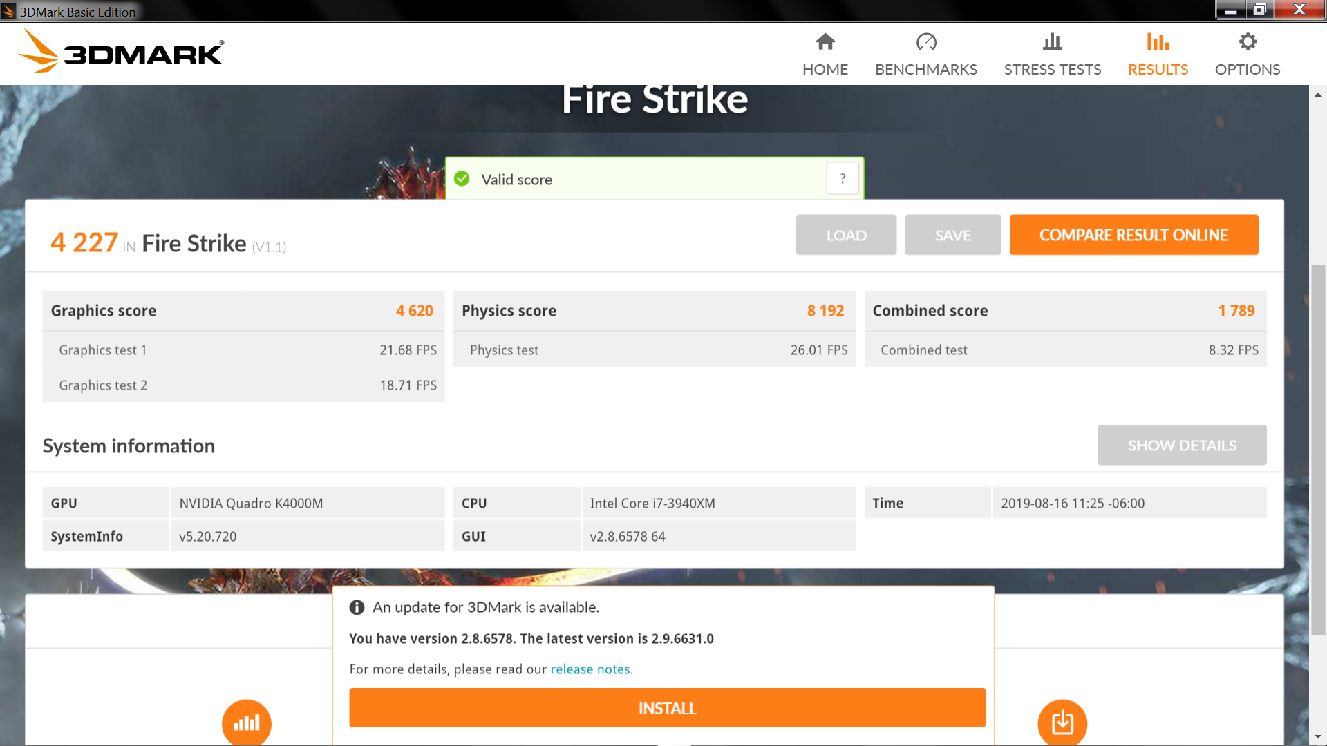

As a finish up to this, I did install the 860m in my machine but it was dead must have had some damage not seen or mentioned. UL firestrike list for august 2019 has the 860m at 4312. I was able to get the k4000m oc vbios from another contributor here, as the admins don't seem interested in listening to a lot of people here who complain about the downloading eligibility policy. Ok getting an account I get, like nexus for larger stuff, but then to pour on the nonsense "promoted". It would be nice if the people who had those could list them somewhere else for dl say archive.org etc

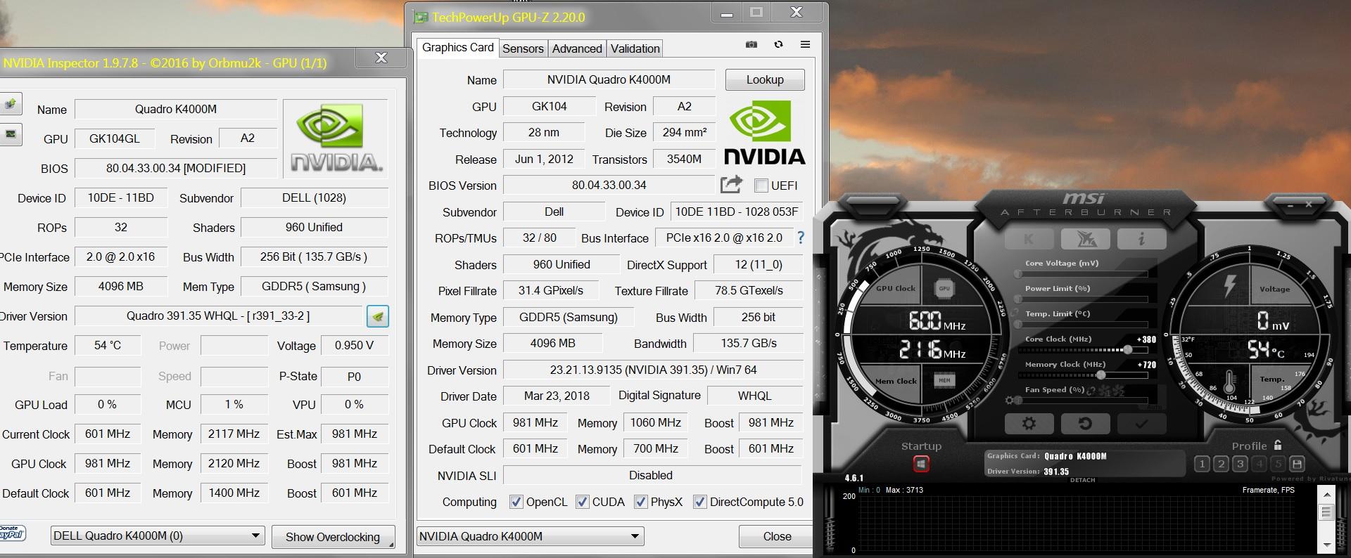

-Getting back to the k4000m, I flashed it successfully and now run it at core 980Mhz(+380 in msi) and the memory at +720 msi not really sure what that makes the memory clock on it but the onscreen msi/riva says it's running at 2100mhz. My k4000m firestrike is now 4620 putting me over an 860m and just below a 780m, and I could go further up as my temperatures on full load gaming like mass effect andromeda are still mid 60c to 70c but I don't want to overdo it and I went from a stock ~2850 firestrike to 4620 firestrike pretty nice.
I'm fine with the level of gaming I get, even shadow tomb raider went from mid 20's fps to 35+ fps and most of the time in Andromeda I'm getting 45-60+ fps. I don't play at 1080p though usually it's at 720p on medium/low settings for smoothness, older games I play at 1080p or a step  down like witcher 3 and get 50-60+ fps. A well optimized game like GTAV is always over 60fps. I also overclocked my screen to 75hz. This laptop cost me a total of 330$ which included the k4000m, 3940xm, 16gb ram, 1080p and 2 128gb ssd's so it's pretty sweet.
-My next card will most likely be a 970m as they are around 200$ and offer comparable capabilities to the 980m which is currently sitting at 320$. That's not for a while though unless a sweet deal comes up. I'm attaching the unlocked k4000m rom so others can get it as well as a gpuz screenshot for reference.
