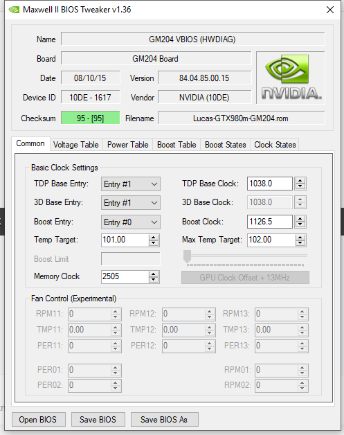

I dumped my VBios using GPU-z and opened up in Maxwell II Bios Tweaker. Everything seens fine so far.

When I modified VBIOSES years ago I did it using a hexeditor so I'm not familiar with that program but I only unlocked core, memory and voltage adjust and increased TDP without any overclocking and then after flashing my modified VBIOS I used overclocking software with profiles so I could change the OC according to my needs.
When I did this on optimus enabled systems there was only the GPUs SPI chip that I needed to flash, on some systems the system BIOS also contains a NVIDIA VBIOS but I've never had to replace it. There should also be a Intel VBIOS but you don't have to do anything with that.
I know some ASUS laptops with MXM GPUs didn't have the VBIOS on the MXM card so you'd have to first extract it from the system BIOS, modify it, replace it, rebuild the BIOS and then flash the system BIOS.
If you're unsure you should have a SPI programmer a backup of you VBIOS using GPU-Z or something and a sop8 150-mil adapter and some soldering skills, or use a sop8 test clip with the programmer (these can be a pain in the ass to get working and you often have to supply current to the board for it to recognize the chip)
