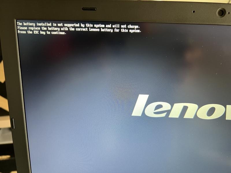

1 hour ago, feherhollo said:
Is it possible to unlock battery check (Whitelist) on W541? I have a branded aftermarket battery and got error message on boot. Won't charge.
Hi!
Restrictions on the type of battery are located in the EC firmware (not in bios). But I don't work with EC firmware.
