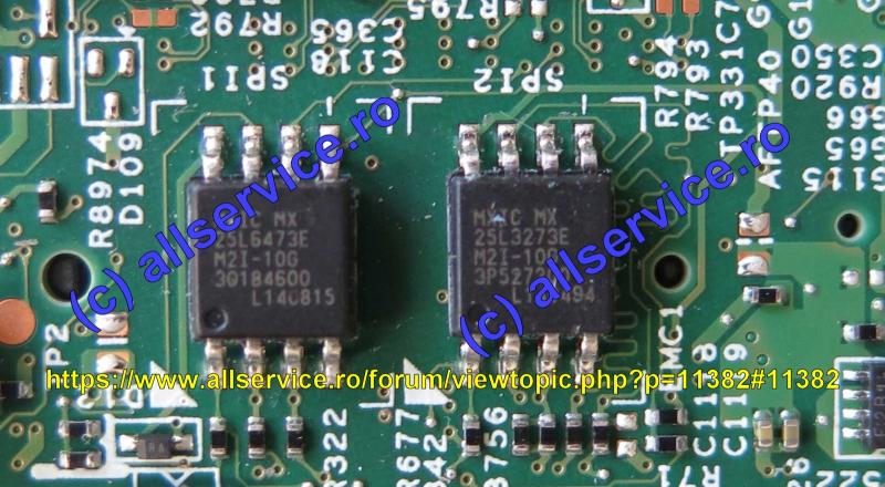

I just bought a T540p and I want to erase the whitelist and enable the advanced menu. I ordered the CH341A 24 25 Series from Aliexpress. I see that there are 2 chips on the T540p logicboard. How does it work? Do I place the clip only on one or on both?
THX!
  • Bios Modder
1 hour ago, NoBlink said:
Hi!
THX!
Hi!
You need to place the clip on chip named MX25L3273E. But I recommend you to read and save the dumps from both chips, just in case.
