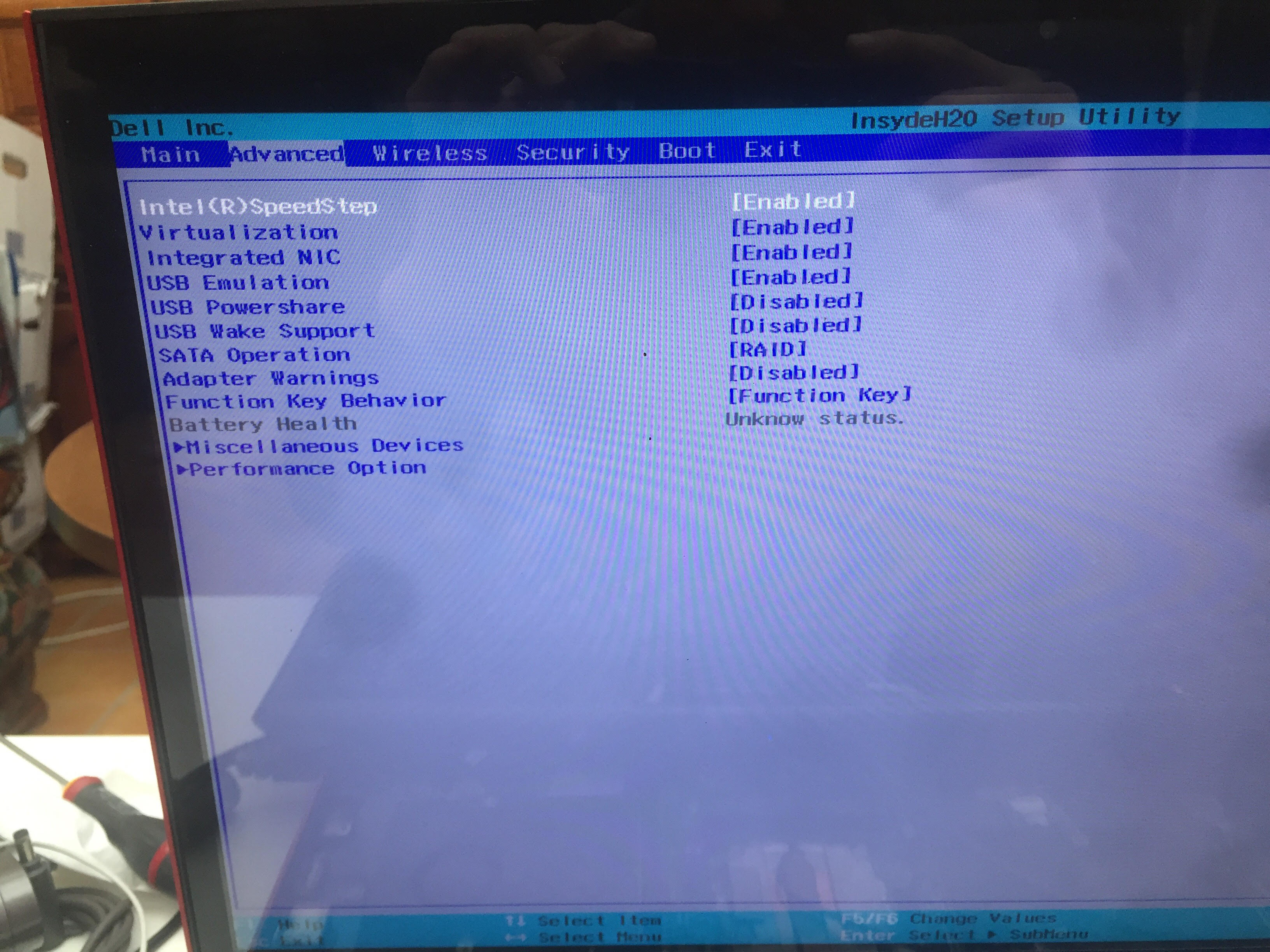

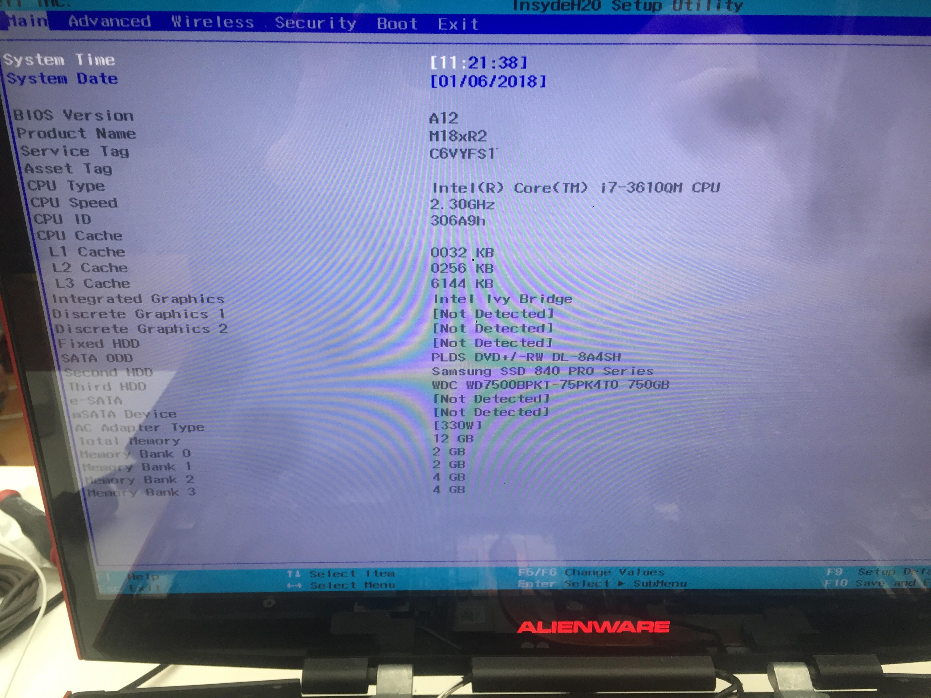

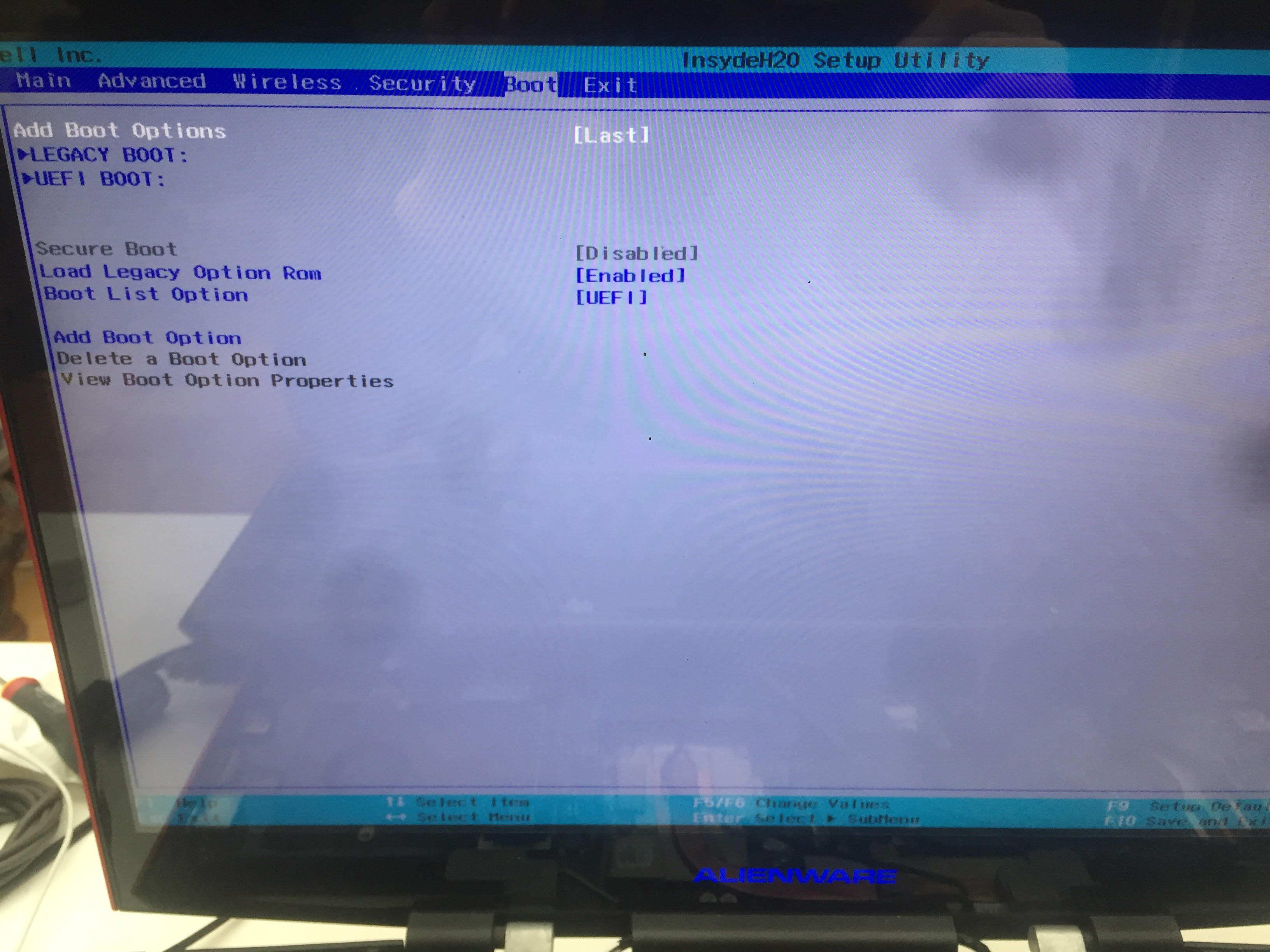

I think I put the BIOS in UEFI but it does not change the 8 beep at startup.
I will try to make some pictures if it can help me

I think you need to disable load legacy option ROM in the boot section.

So I boot on the bios I changed the mode to UEFI and disabling the "load legacy option rom".
